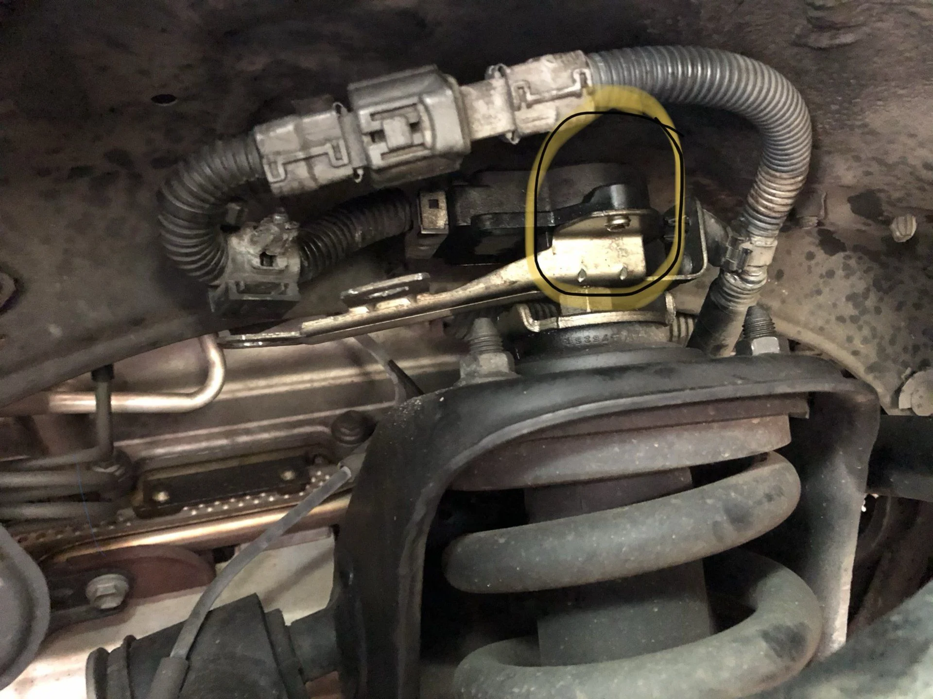

In the middle of trying to install my lift. Have the rears done, starting on the fronts. I've absolutely hit a wall with this $&#@*^& electronics bracket on top of the strut. I really hope I'm missing something obvious. I can't find anything online mentioning this so I'm assuming there's some easy route I'm oblivious to.

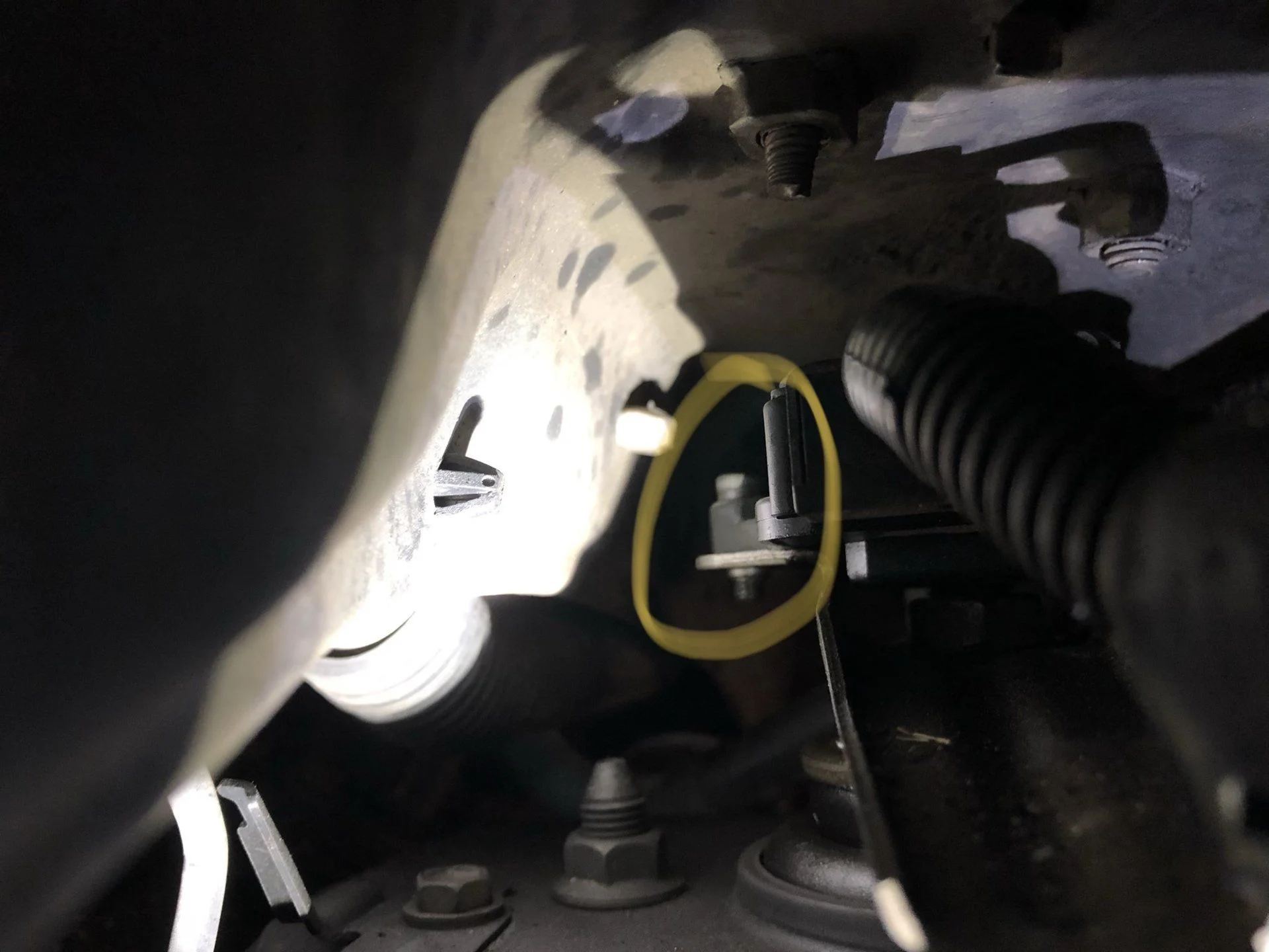

There's two allen head bolts holding this bracket on. One in front with clear access, and for some Godforsaken reason, one buried behind the module between the fender wall with hardly any access/clearance. On top of this, these allen heads strip with about 5lbs of force applied. I was able to get vise grips on the one in front, but I can't figure out how to access the one in rear. Hoping someone has a tip/trick. Photos below trying to show what I'm referencing.

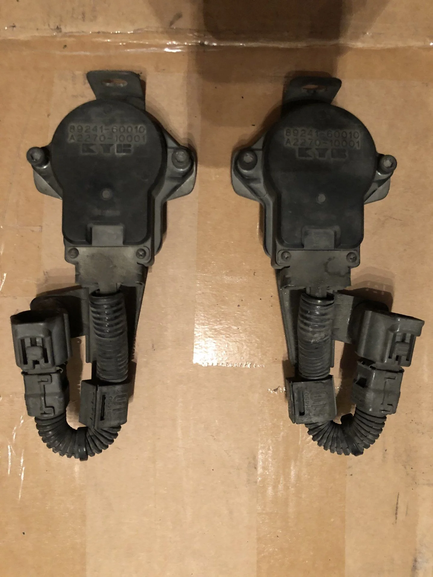

you can unplug and twist the assembly to get to the other bolt. If you get them off undamaged, they go on ebay for a pretty good price.
Thanks Vlad. I certainly didn't succeed in getting the first one off undamaged, but moving forward again. :wrench:

I break em off unless you want some little value on ebay. I've seen then from $30-75 per actuator assembly.
I got mine off intact by unbolting the strut first and letting it drop a bit. Capped them off and zip-tied them safely in the engine bay.

I just used a spare allen wrench and cut the short end shorter to fit. worked great and left the units intact

To get them off, I did the same thing as CarolinaGX, I cut down an allen wrench to fit better.
