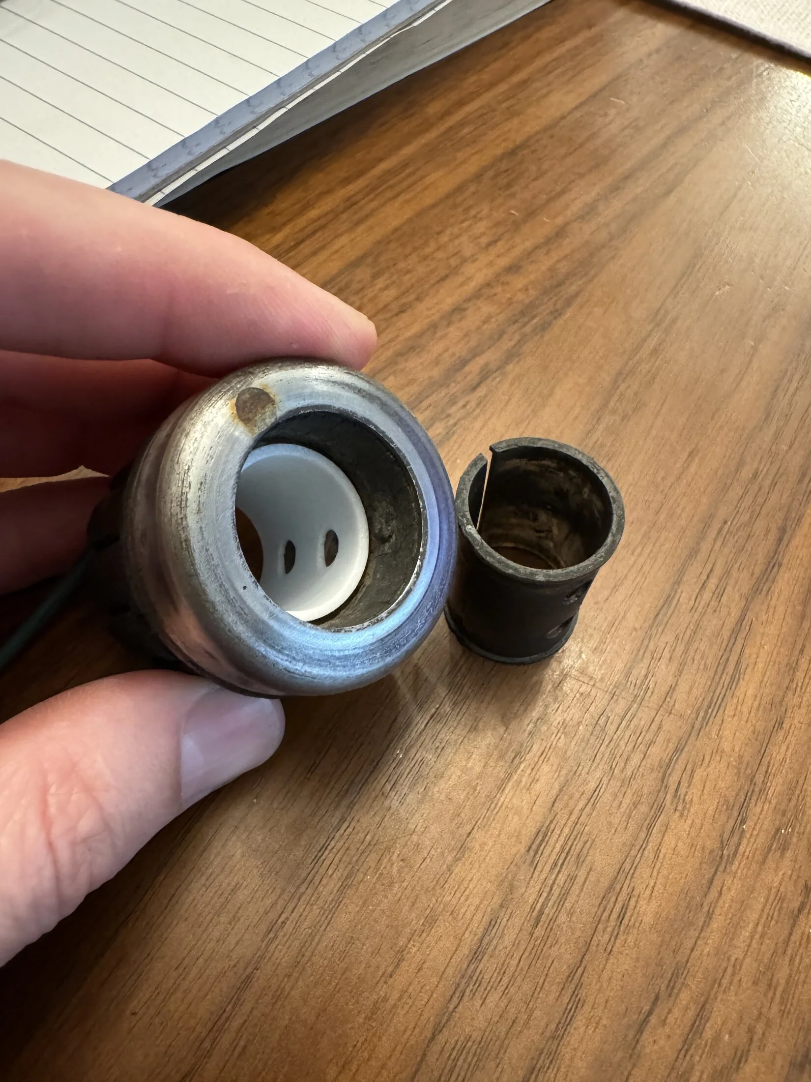

Hey.... I want to share a great fix on my 1970 40 series steering column. This is super inexpensive and easy. @Cruiser Cult makes this bushing replacement that holds the column in place properly up by the horn ring. If your steering wheel jiggles and sloppily knocks around a bit in the column, this bushing is likely the issue. I guess they can be worn, but mine was flat out missing. What an instant improvement to feel of the steering with the wheel feeling secure instead of it bumping around. I already posted about their horn ring contact set, which is also awesome. Big thanks to @Cruiser Cult for making these parts and supporting the community. Give their stuff a look so we can continue to support those who support us.

Here is a pic of it installed in the rubber bushing that is at the end of the pre-72 steering columns.

I don’t get where this bushing actually goes and how it eliminates the slop?

At the end of the steering column on the 72 and earlier rigs is a thick rubber bushing, followed by a metal bushing, followed by this last inner plastic bushing. The long steering shaft from the box needs this last support to not have side to side slop at the wheel. Later 40s use a bearing if I am not mistaken. Over time this thin (and never lubed) plastic bushing wears thin and allows side to side play at the wheel.
If you take the steering wheel off this bushing system is right there at the end. :)
