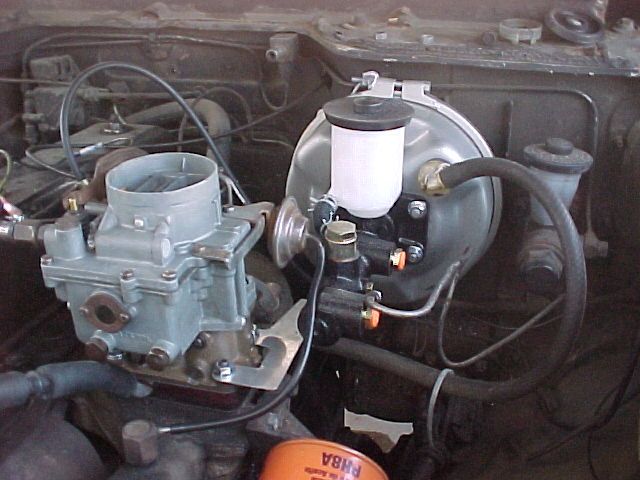

Here are some better (I hope) pics. The tip of the master is 8 3/4" from the firewall. I made my adapter to position the MC so that I would not have to notch the rib for the rear fitting. To save space, you could just drill a couple of holes for the GM master to bolt directly to the firewall. That would save 5/8".
As I said, this is a '74 F carb on a 2F manifold and it uses the old style cable linkage. I needed to raise the carb enough to clear the bellcrank on the cable linkage. My new JimC carb has a different cable setup, the one they use in Oz. I guess because of the RHD deal they are all cable linked?

Ed, thanks for the pix:).........in the conversations with Mark A. he is very much against a unboosted system on a pig becuase of the 55s weight/inertia...BUT looking at your solution; :hhmm: there should be not problem boosting the front circuit via a remote booster; we were doing this in the 60s........I like the elegance of the way you solved the problem and just have to figure out where the cable setup will go; should be getting it when Mark A. gets back from Moab and can get a better feel for where everything has to go........rest asssured I will not drive a single circuit on the road, it is an accident waiting to happen; in aviation there are certain circulars put out by the FAA called ADs and they are mandatory to comply with; if you fly without complying with them you do so at your own risk and as long as nothing happens you are OK BUT if as will happen sooner or later you have an accident because of this failure you will be in serious trouble with the FAA if you survive and aircraft insurance will probably not cover any damages, injuries or death because of the "flying recklessly" and "failure to comply with mandatory AD"......single circuits IMHO are an accident waiting to happen!..........I have experienced this personally:frown: Ed thanks again for all the help and advice and :steer: me on the right track :cheers:

Lou, I finally got around to mounting the booster and master combo into the 68 piggy at the shop. As I thought, there was sufficient room for the combo with the F engine manifold and carb. Here are a couple of pics.

Mark, looks great:clap:!; now have this situation; a 79 running 2F with manifold in a 69 pig; have an f 1/2 rebuilt carb in box from some dude in Burbank ;) also from the same source a conversion kit in box to change linkage to cable......have a new booster and master off the 79 pig......what will I need to get it set up like yours? and what pieces can I use from mine?...... TIA;
