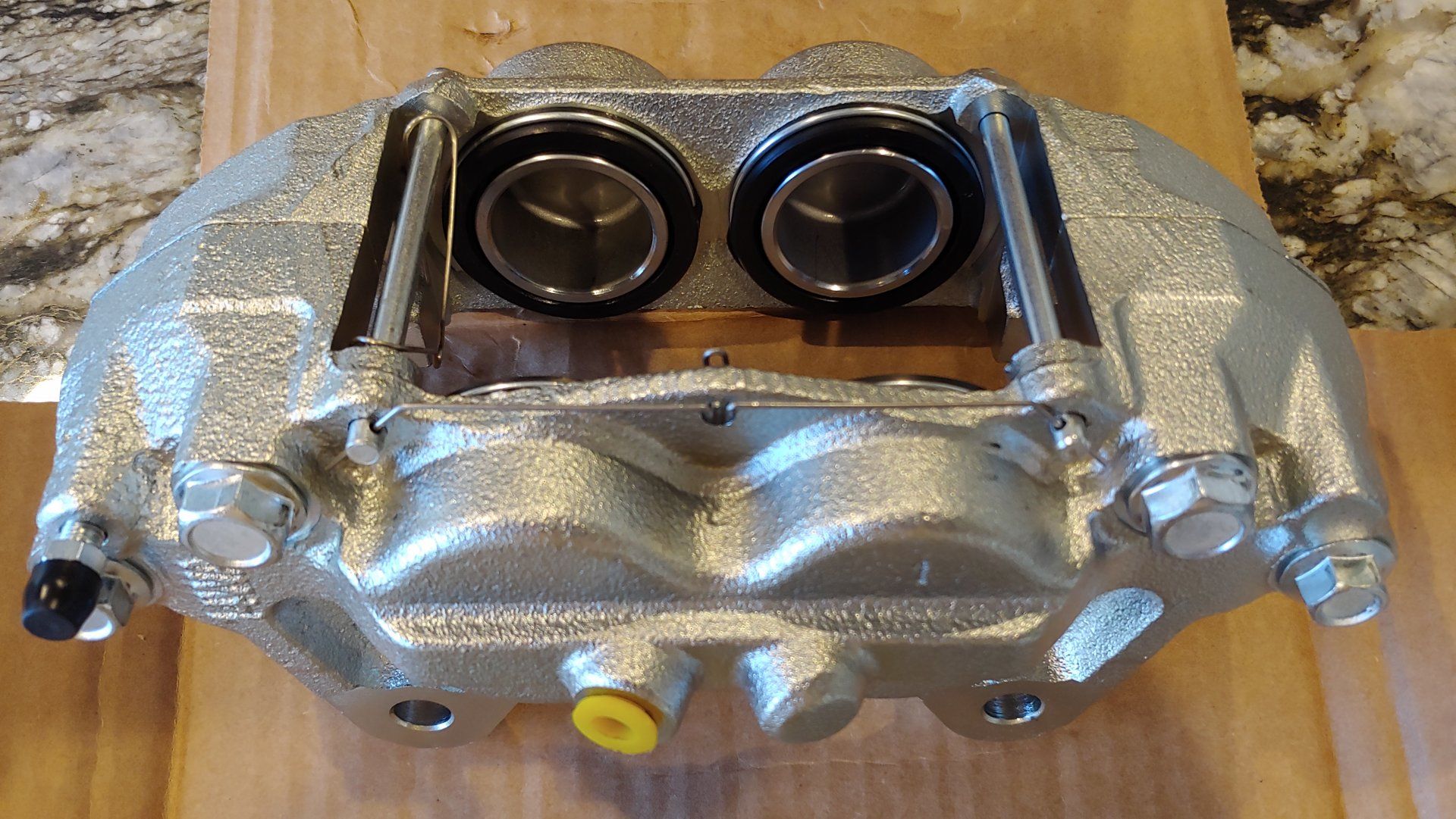

Thanks. Callahan could have sent better pics to Amazon. They left plenty of room for doubt. But when I unpacked them, I was very impressed. It looks like a very good refresh.

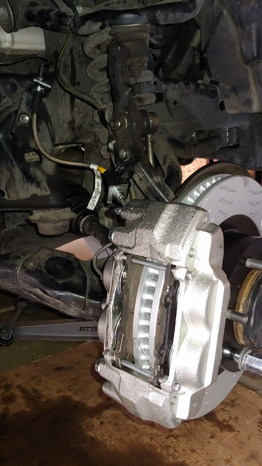

Well, operation GX460 Brake Conversion happened Nov 1. I replaced the stock front 470 calipers with remanufactured 460 calipers from Callahan (via Amazon). Front rotors went from 470 PowerStop slotted & drilled, to 460 Raybestos performance rotors. And finally, I upgraded the brake lines to the StopTech (Centric) steel braided lines. Overall it was a straight forward plug & play.
The only thing I had difficulty with were the brake lines. If you do this conversion, make sure to keep the connections between the solid lines and flex line loosened until you get the geometric shape of the flex line in place with the mount and get the pin/clip back in. Everything else was straight forward.

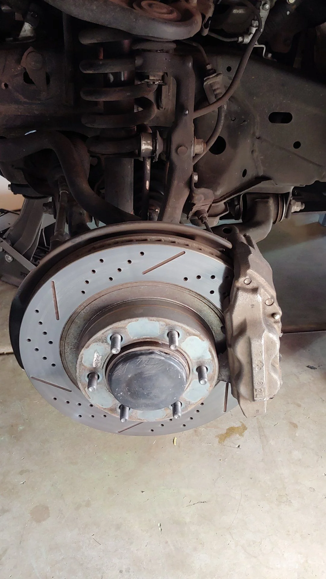

Before with PowerStop rotors & 470 calipers...

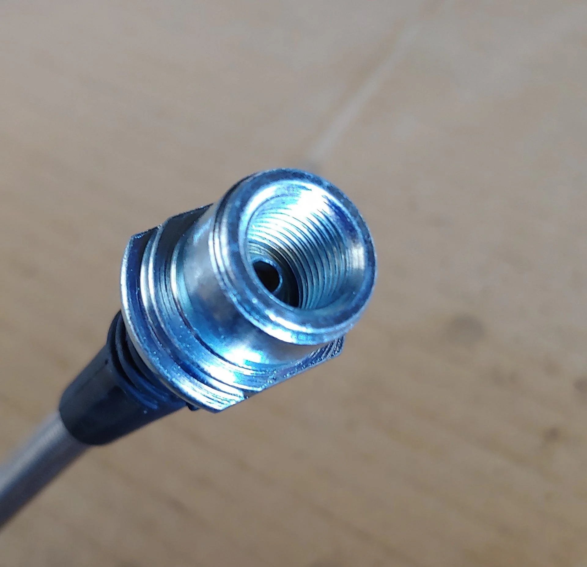

The plugs that came with the new brake lines are to insert in the end during installation to keep the brake fluid from draining out. Afterwards, they can be used as a cap for the bleeder valves.

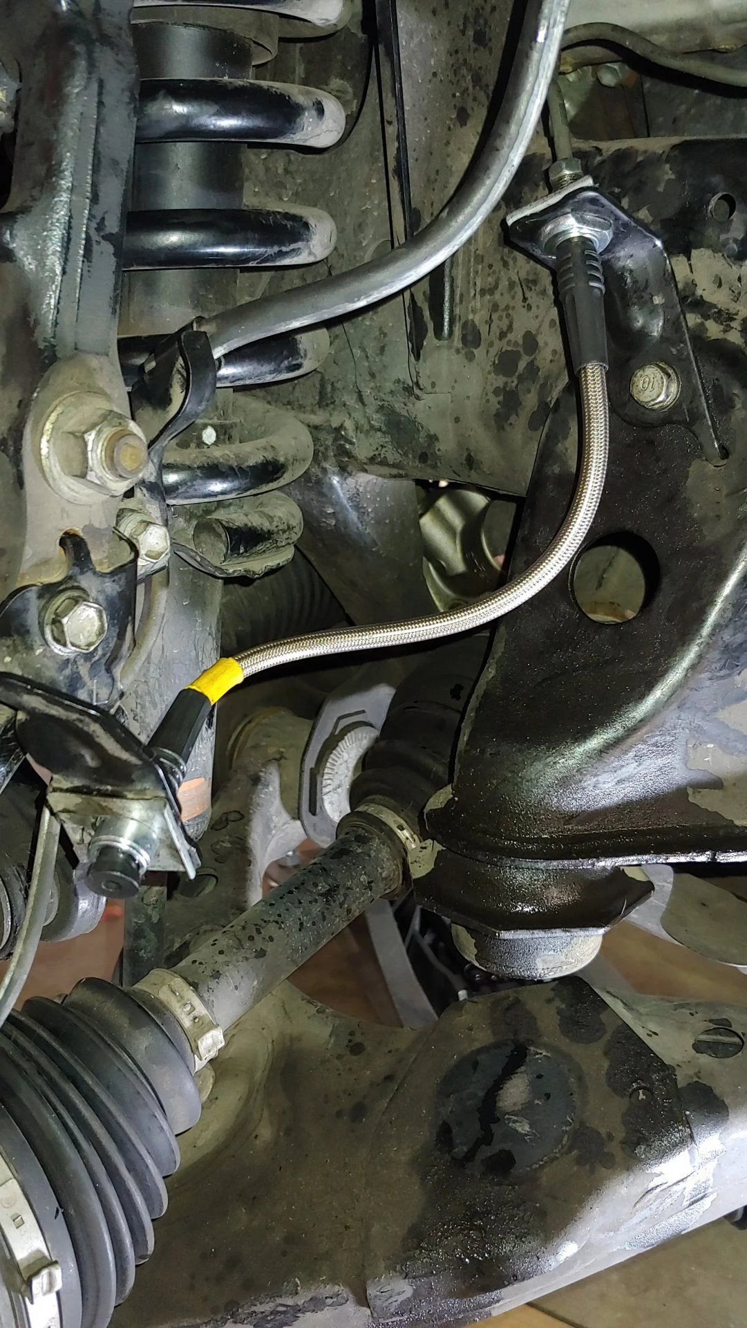

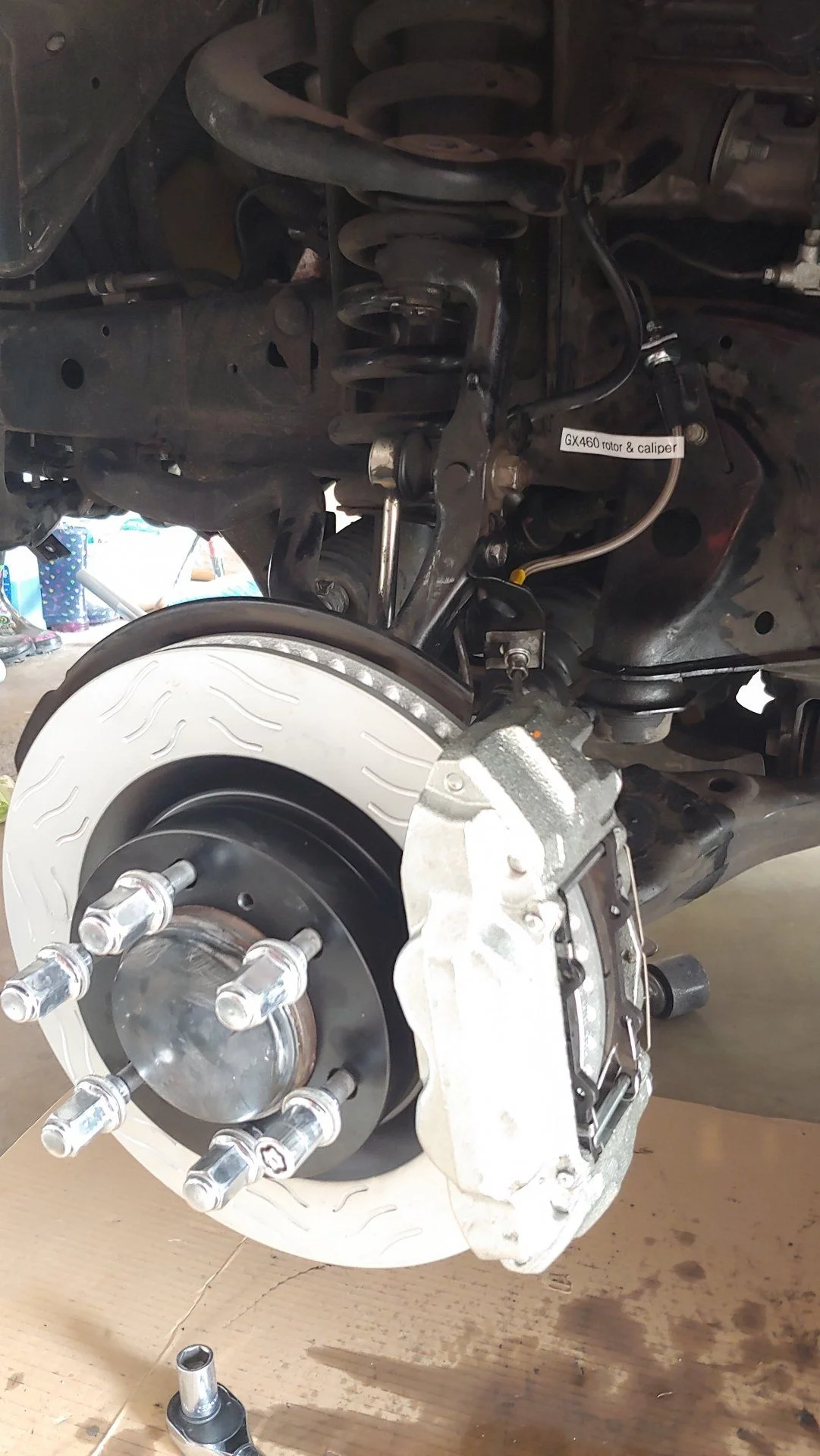

THE AFTER! I placed a label on the new brake lines that these are GX460 rotors & calipers in case anyone else is tooling around under here in the future.

Initial thoughts on the Raybestos rotors & Callahan calipers....WOW!! Both look better than expected. Yeah, I know, let's wait for the performance test. Hitting the road this weekend, so hoping to have it completed next weekend. I'll do plenty of posting when it happens.
