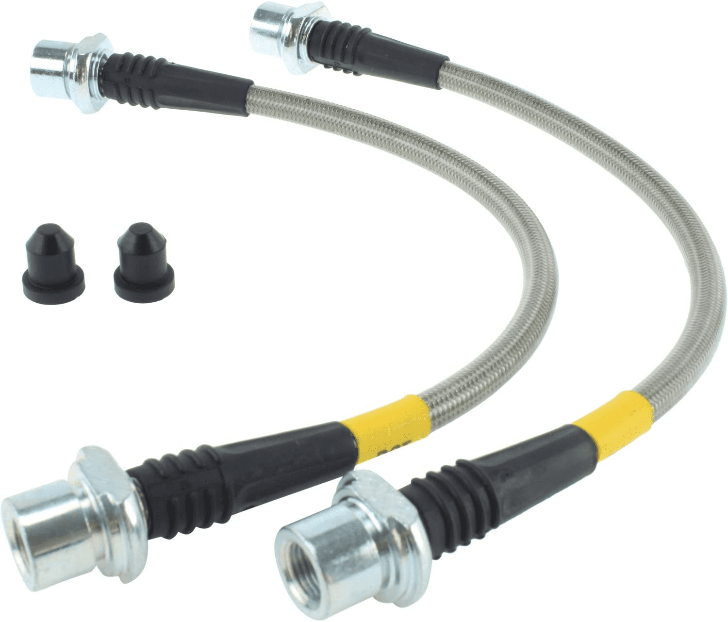

Question: what are the rubber plugs that come with the new stainless lines for? I assume that they are involved in the installation process. I’m guessing you plug the end that attaches to the caliper BEFORE you attach the hose to the inboard brake line? Thus keeping fluid from going everywhere as you get the caliper end ready?
So I went with the gray coated Callahan calipers for the rear. And the red coated power stop calipers for the front.
I also got the Stoptech (Centric) stainless lines for the front.
those are replacement plugs. you remove your old plugs and replace with the new ones. Or, if your old ones are fine, just leave them installed.
IDK. I was assuming they were to cap off the line when doing the swap. Full description of product says "brake line." haha

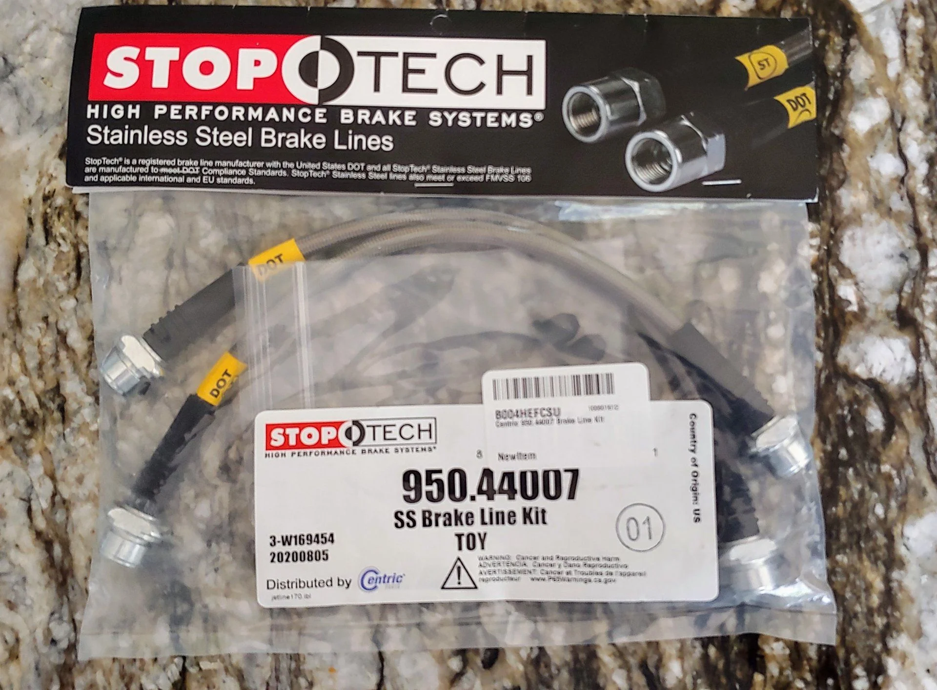

In case there was any doubt whether the Centric & StopTech SSBLs were the same product. I ordered the Centric SSBL. This is what arrived...
Notice the "Distributed by Centric!"
