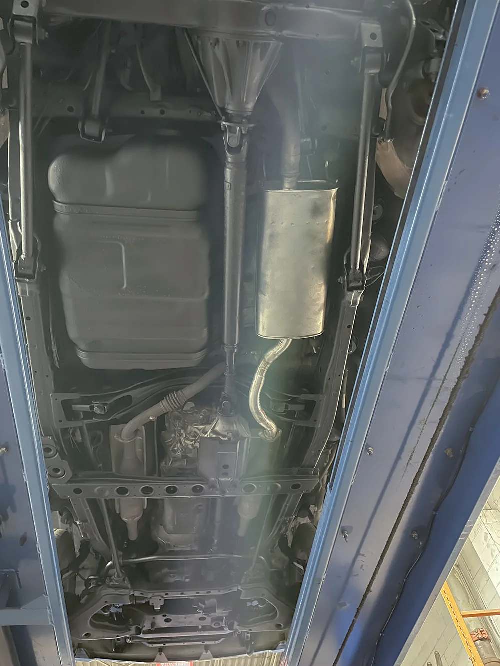

So there’s no way to tell if there was/is severe rust under the undercoating? Here are a couple of pictures of undercarriage.
Sounds like perhaps I should skip this one. I’m in no rush. Better to eat a deposit than deal with a nightmare later. I just don’t know enough about these rust potential vehicles.
The exhaust being replaced with aftermarket is another red flag. The factory exhaust will last well beyond 154k if not subject to rust. The only way I’d consider that one was if I personally saw it with my own eyes or had someone I trust look at it.
I wondered about that myself. Can you tell if that’s the rubberized type of undercoating or are they all equally concerning? I’m certainly not married to this one.
It looks like the front splash shield or whatever you call it is gone. In my experience that was the first thing to rot out, followed by the gas tank shield.
So the fact that the shield is gone is a bit concerning to me. Looks strange where the body mounts come off the frame.
usually you can see the pitting etc from the rust but who knows. Ask for shots with the spare dropped and the spare tire hoist. That usually is a give away if rust is an issue.
