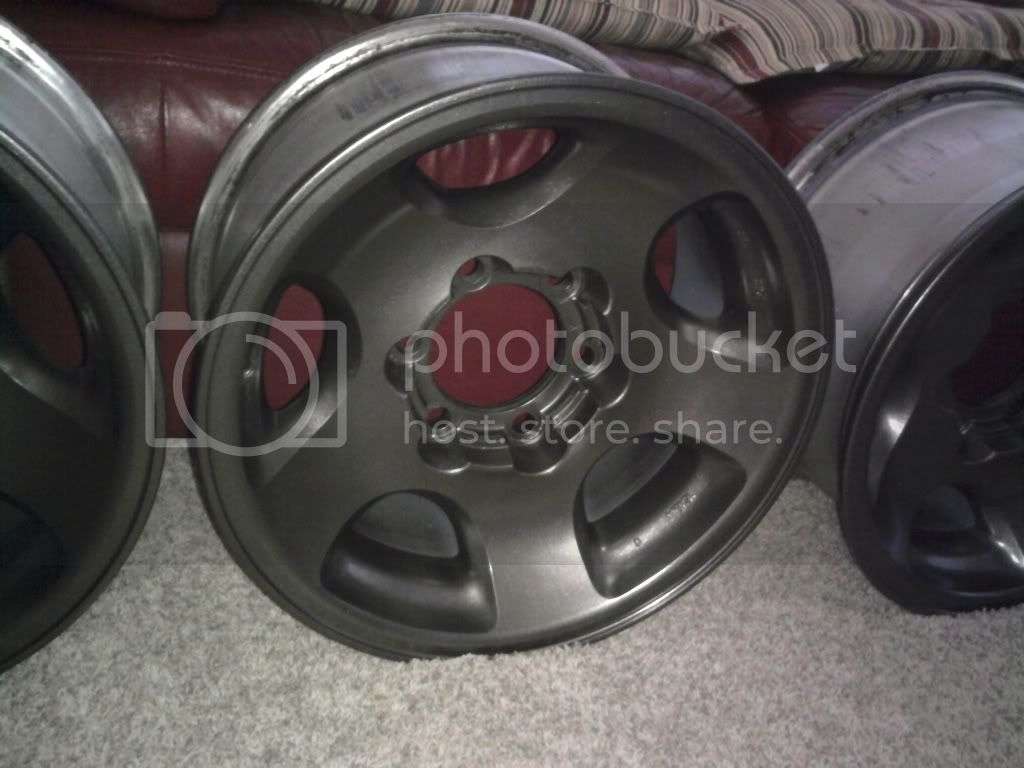

I bought a set of rough wheels to refinish from a 93 FJ. The original plan was just to paint them using the same method used in this center cap refinishing thread.
After sandblasting them I used a file to smooth out some trail blemishes around the outer rim. The places I filed looked shiny so that got me thinking if i really needed to paint or would just sanding and clear coating them look ok. I searched and there have been a few threads about doing this but none I found had final results of clear coat only.
Here's what I'm going to try:
1. Sand blast the wheels.
2. Wire wheel to get back the shine.
3. Wet sand to blend the swirls and give it a uniform look.
4. Then coat with adhesion promoter and clear coat.
How the wheels looked when I got them.
Then Sand Blasted
And after a quick refinish with a wire wheel.

They turned out pretty well. Now to see how long the finish lasts.
Start with the holes in the wheels then move to the outside surfaces. It is easier to blend swirl marks left from the wire wheel.
Also I think I could probably have skipped the sand blasting and just used the wire wheel.
pic 1 wet sanded
pic 2 clear coated

I really thought about leaving the bare aluminum as it looked nice and I don't mind the old school bare aluminum look. But in the end I went with the Duplicolor Graphite paint that others have done and it worked great...
