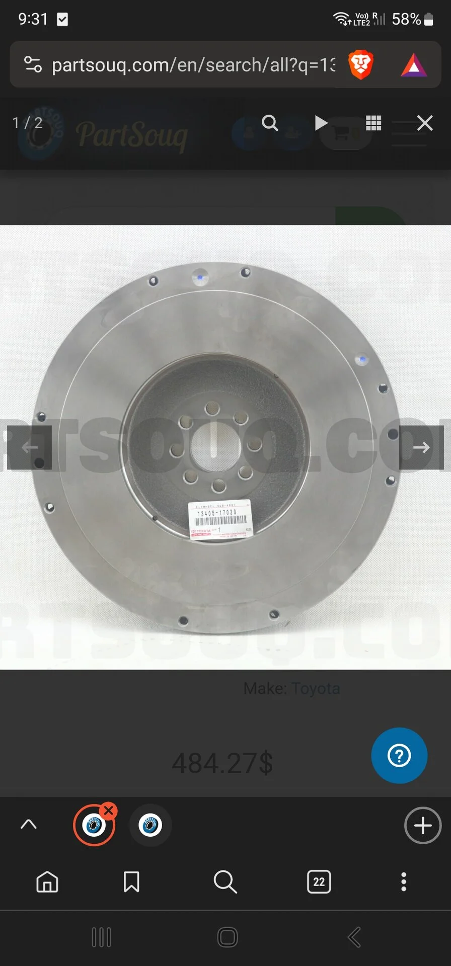

300mm flywheel below
The raised section in the 275 unit is a lot narrower (25mm smaller diameter)
