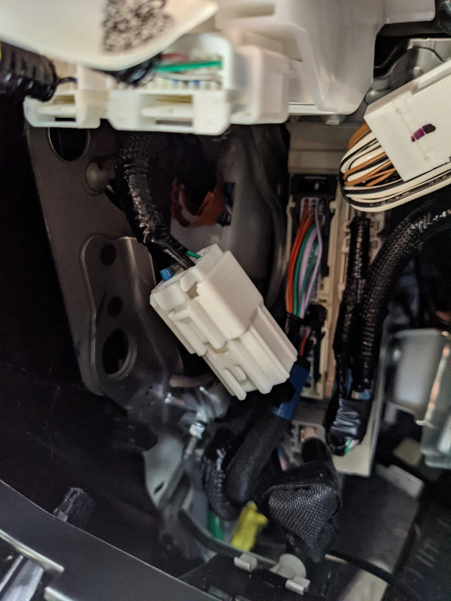

Went to install mine yesterday, I do not seem to have a factory supplied harness to solder to? I found the plug, but where everyone else's post indicated that it was plugged into a dummy taped to the base of the pigtail, mine was just hanging out.
Either way, I'm picking up a Tekonsha 3040-P harness which should make this a plug and play install. I ended up going left hand side.
I
The harness with pigtails is provided with the new vehicle. Some have found it in the glovebox, some in the tailgate hatches.
Yep, I checked around, but mine is a new-to-me 2016 and it appears this harness (along with the cup holder divider) did not make it past the first owner. I'm guessing because the dummy plug was already untaped it had been used for another controller that was removed before trade in.
Learned a lesson in underestimating my own stupidity.
1. Upon double checking the glovebox, I found the harness. Doh.
2. I had assumed the Tekonsha harness would be a compatible harness using some sort of standard connector for the Redarc unit. It is not. Don't be like me.

The harness was in our glove box as well. The dealer had to tell me what it was and never offered to install a controller.
I was kind of surprised Toyota did it this way - Ford trucks just come with Ford's controller all ready to go. I guess it's better the way Toyota did it as you can pick your own controller and mount it where you wish. I do think Toyota could have located that plug somewhere so you didn't have to take the dash to the left of the wheel apart to get at it
I opted to pay someone to do that. A man's gotta know his limitations after all. :cool:
Once you learn how the dash comes apart, it is 15 minutes in and out, maybe less. The Redarc brake controller is literally plug and play. I totally get how some people may opt not to do it, but if you have any DIY interest/skills, a 10mm ratchet and a Phillips screwdriver, it is a very easy project.
