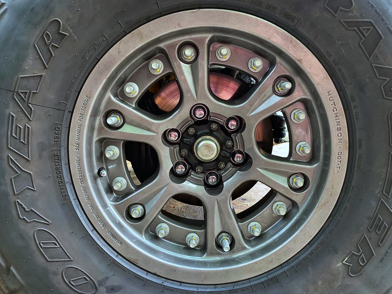

Got the new wheels and started to mount them up yesterday. I'm terrible at searching for stuff so it was pretty easy choice when I knew that Hutchinsons would push the tire out 25mm from where the fj cruiser steelies were and that I could stay away from tire shops forever. Once I knew I was going with them, it was a matter of finding someone in the US with them available. Hutchinson makes the military stuff too and that takes precedent over consumer orders, makes sense. I think I called pretty much everyone who offers them and was told 6-8 weeks lead time, and I knew how long it actually takes since my brother had some and it took forever to get them. I got super lucky and found a place that had 4 ready to go and a 5th would take a month or two to get.
I feel bad for the UPS man who had to carry 4 of these boxes up my long ass driveway.
These things are pretty easy to put together. Shove the rubber donut into the tire, put the back half in the tire, then the top after lubing/putting the giant o-ring on, and tighten everything up. The front half of them have little alignment nubs that if you don't tighten the two halves together evenly, you'll crunch. So I was pretty careful when putting those together. I torqued all the bolts to 30 ft-lbs, then 60, then 100 because I wanted to make sure they were all getting tightened evenly. I was going to use dynabeads to balance the tires, but Hutchinson didn't recommend that. They said to use some sort of liquid balance or something if you really needed to. They said they are checked at the factory for a balance spec and probably wouldn't need balancing unless the tires are super imbalanced, so I didn't use anything. If I need to, I'll take them to a tire shop and get some sticky weights put on.
But no one cares about how to put them on, it's super easy. Here is one up to the car to see if I actually liked them.
Mounted up. I used some gorilla locking flange style lug nuts. I can't wait to lose the key and not be able to take my tires off. I checked the lock to lock turn of the front axle and it clears the radius arms now.
I marked all the nuts/studs with a paint pen so I could easily check for loosening of the nuts. I doubt it will happen, but it was a pain to torque them all in the first place and I don't want to have to do that all over again unless I'm changing tires.
They have some pretty interesting split jam nut kinda nuts. It looks like to actually back out the top half would have to jump over a little bump on the lower nut that locks the two halves together. Then they can loosen together. Good luck with that. I got the tires mounted, but need to put the rest of the wheels on today. Hopefully all goes well and I won't have to take them off again to balance.
