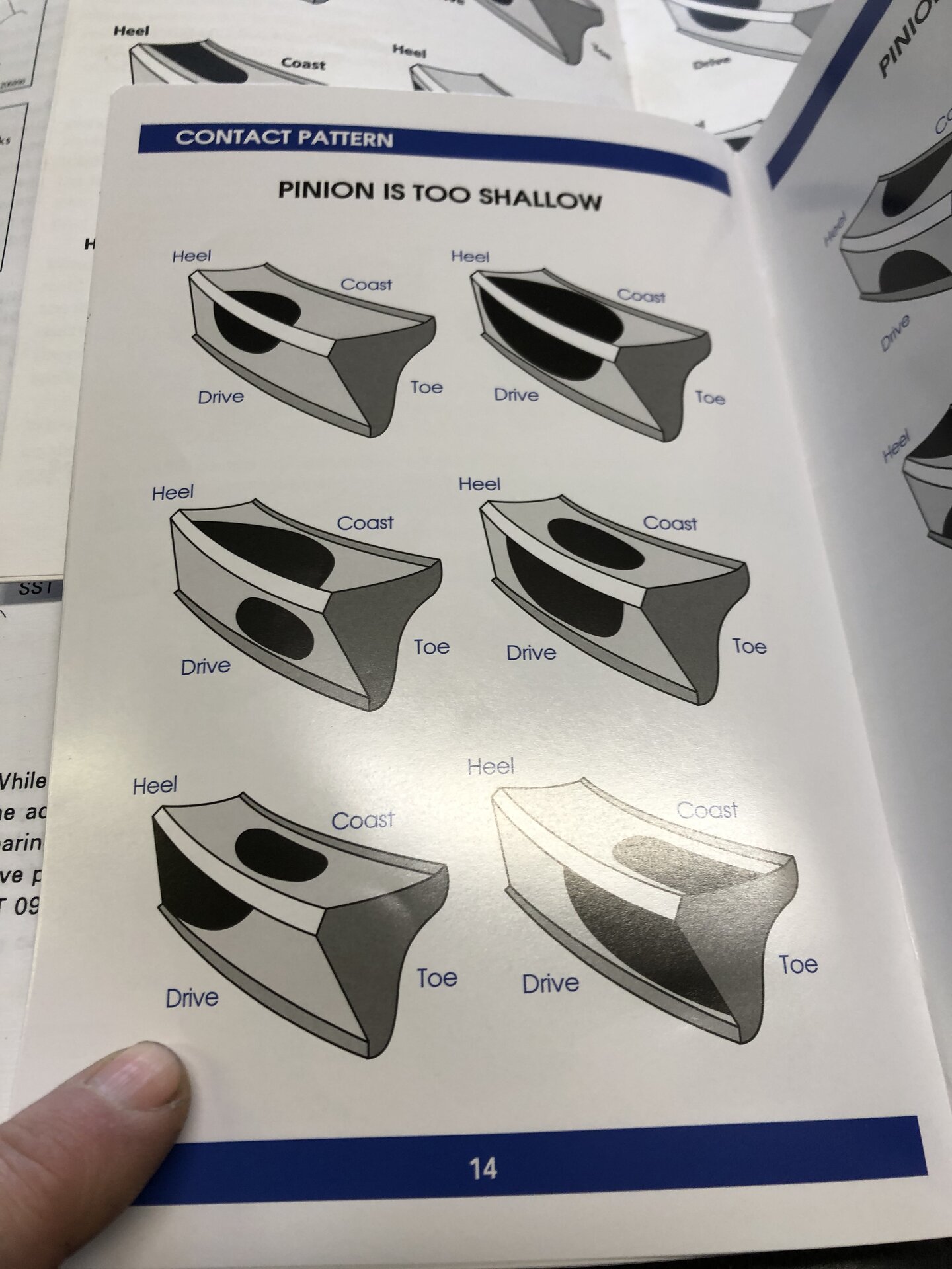

Pinion too shallow? Backlash sits at about 8-9 thousands.
It’s amazing the diffenece some torque here or there will make. I applied additional torque to the nut you see with the tool on it that’s all and the pattern changed. I’m inclined toward leaving it there. Opinions?

From what I see it's still to shallow and not centered 🤷‍♂️

I pulled the pinion to put a shim beneath the forward race to bring the pinion deeper. Now I can’t get the damn race to go back in. Was easy the first time. I’m taking it to Woody’s 4x4 tomorrow.
Got to give you credit for trying. I'm with @Broski , "good call". Too much at stake to not get this right.
I can do it right but my patience has run out. Want my junk back on the road. I like driving it.
