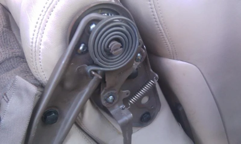

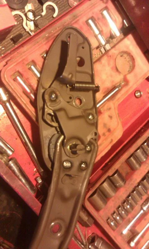

I didn't see a lot of folks doing this, but remembered seeing it awhile back. I put Mots hinges in my previous 80 and now that this 80 is back on DD duty, the lack of reclining seats was irritating me. I was able to pick up a set of third row seats from Schmukster up in PA--I just had him send me the hinges and can the seat cushions. This saved me the high cost of shipping the things, he got paid, and I got the parts I needed. If one keeps an eye on the classifieds you can pick up a set for under 100 bucks pretty often.
I wanted to keep the third row reclining hinges working because two of the kiddos ride back there, so doing the gear swap from my hinges was not an option.
On to the pics. Nakmans instructions were spot on, but I made one modification. After drilling one of the hinges and then looking at the strength of the bolts in a side impact situation, I decided to weld new "heads" on the rivets that I had ground off. It may not be much stronger, but it won't come loose and it makes me feel better. Also, this is a pretty easy job if you have a couple hours to fiddle with it and have the extra set of hinges on hand.... I also put a coupe coats of rustoleum on the welded spots--probably no risk of rust inside the car, but oh well....
Thanks to Nakman for doing the legwork on this.:cheers:

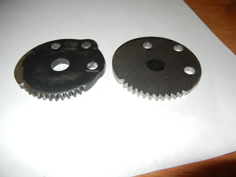

I wondered about taking the gear down to a machine shop and seeing how much it would be to make a few sets. The biggest problem with your sets is the price, and the biggest problem for Nakman's method is gear availability..... Seems like if you could get a relatively inexpensive gear made, it would solve both problems. [kicking myself for not thinking of this BEFORE welding everything together]

Ok, got to work on the passenger seat today and you dont have to swap the gear. I removed the parts as shown but I did not bother removing the gear from the bracket arm, I just broke out the grinder with a cutting wheel and added more notches to the existing gear all the way to the stop. Put everything back together and it works great. Sorry I didnt take pics, the only thing that gave me grief was the rivets installed are different sizes as they go through the multiple pieces so you will need to scratch up a bushing to press in where you are replacing rivets with bolts in the different areas as needed.
...I just broke out the grinder with a cutting wheel and added more notches to the existing gear all the way to the stop.
Thanks for doing that, I was thinking that would be easier, but glad to know someone has done it that way. It's not like it needs a precision cut or anything.
I would say that it does need a precision cut. In an accident, you don't want your seat backs flopping all around--the teeth need to mesh well. I thought about this as well, but decided it would be easier and safer to swap the gears.
