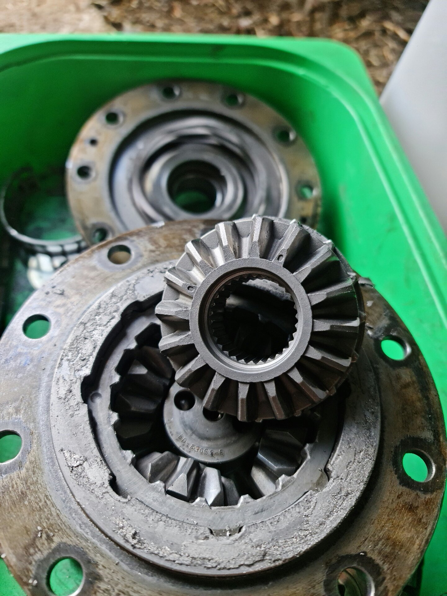

First step was a full tear down, to see what I was dealing with. This turned out to be easier said than done, because the bearings were stuck on solid. Well, one side at least. One finally let go with the 20 ton press after a lot of stuffing around, but I had to resort to slicing the other one off with a mini cut off wheel. Here's some teardown shots once I had the thing open:
Cross shaft was totally rooted:
You can see there how worn down the surfaces are where the spider gears ride, and you can see in the shots above what almost looks like graphite power - that's fine metal dust from what remains of the screw heads and the missing material from the cross shaft. It was dry, which leads me to believe the diff was running without any gear oil at all for an extended period of time, which is what caused the damage. There was also problems with the spider gears themselves. The gears are made of harder material than the cross shaft, and the teeth themselves were acceptable to my eye, but the internal surface that rides on the cross shaft had suffered badly.
