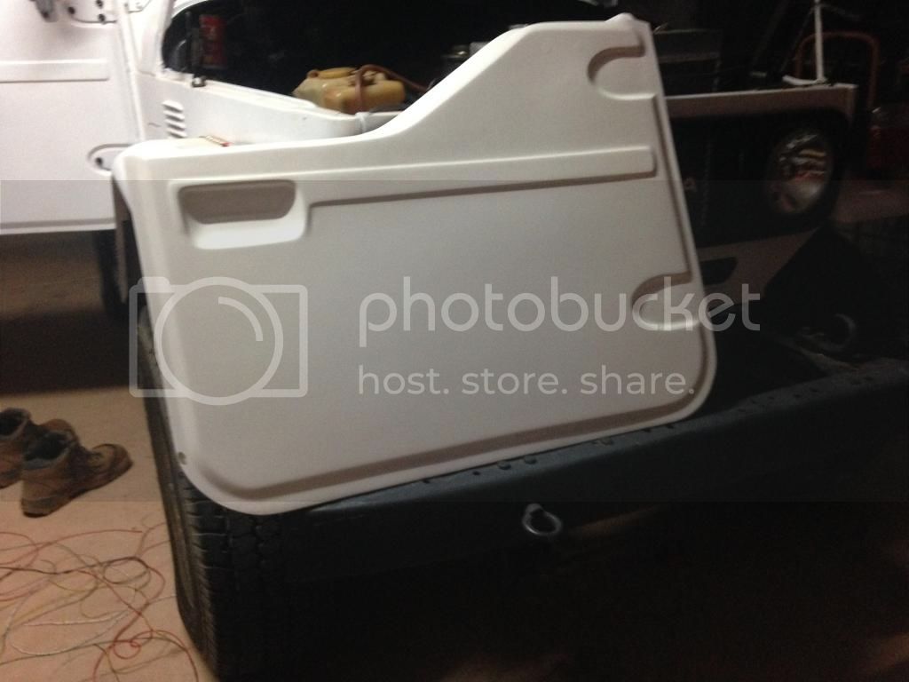

How are you finding your fibreglass?
I live in Exmouth and this will primarily be a beach car. Just received some cheap fibreglass half doors, not perfect and need some work but they are better than I expected for the price.
Got me to thinking if I should bother refurbishing my bib and bezel and just throw on some fibreglass ones.
