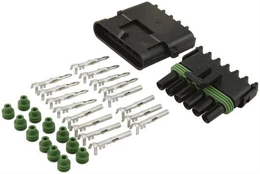

That connector is toast. Discard it. The purpose of a multiwire connector is convenience. Depending on the number of wires that need to be joined, you can also get away with using a less dense connector and using a couple of them. Like three four pin WeatherPak plugs might work well (depending on how many wires there are.
Here's a website that sells all kinds of DC-DC automotive connectors. See if they have what you're looking for.
Personally I'd just use WeatherPaks.

Thanks for the reply. That is what I was thinking but was not willing to take the next step without a nudge. I will order some up and get going.
