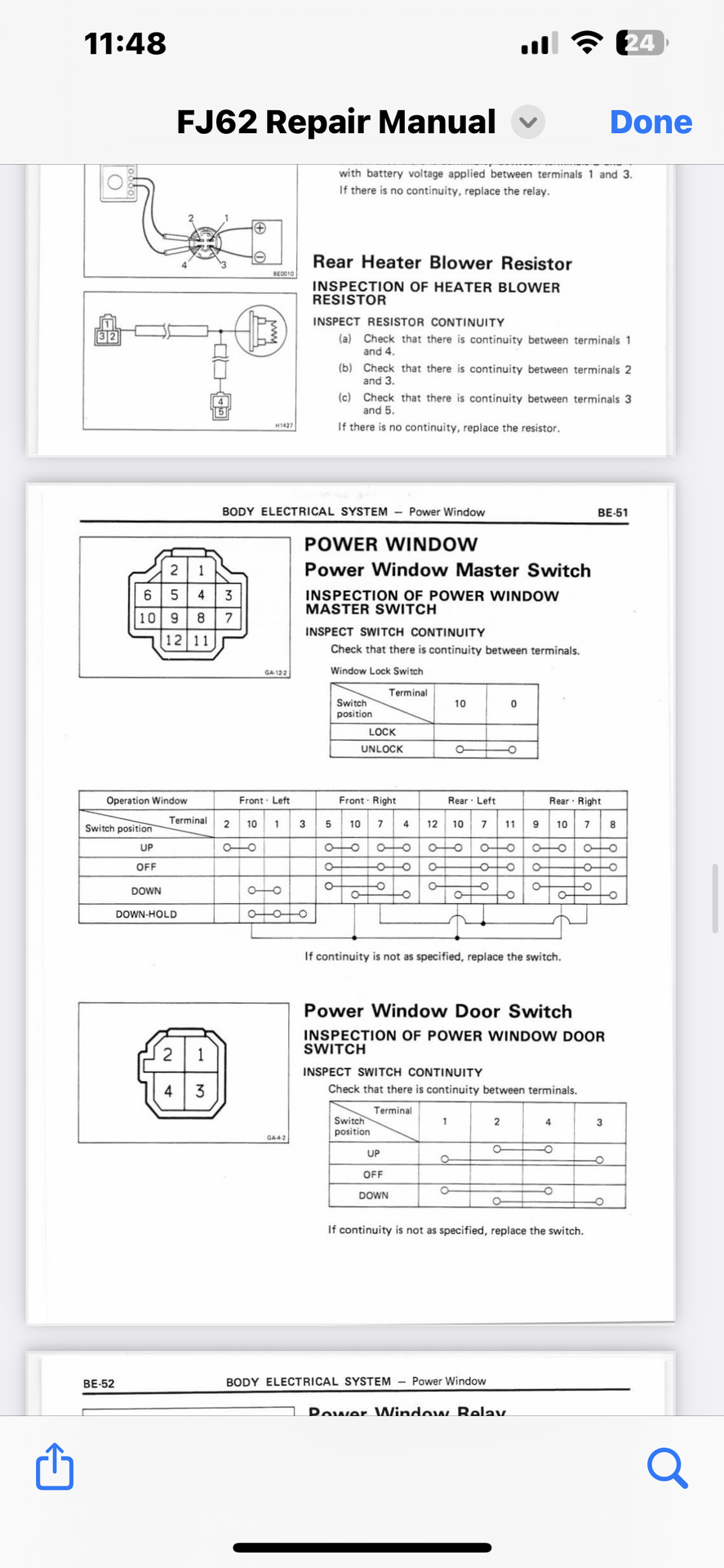

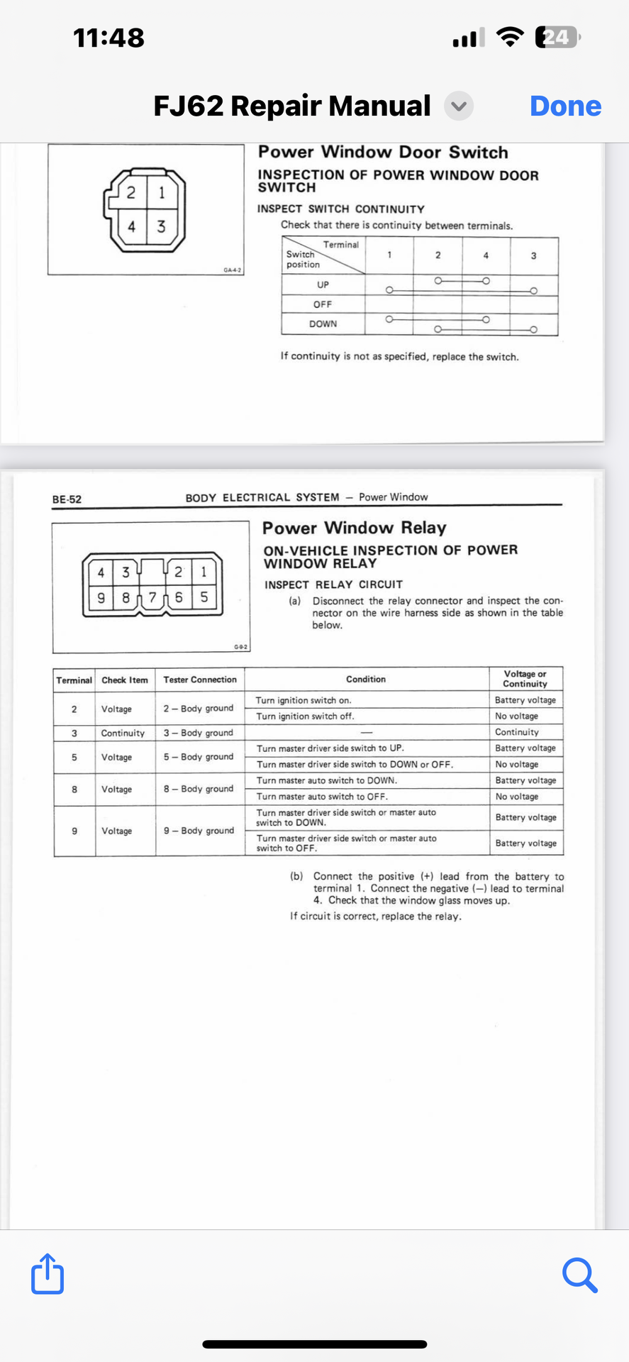

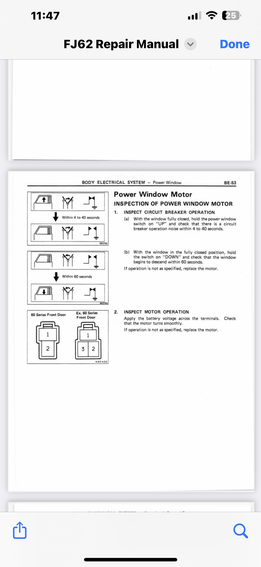

May want to do some of the functional checks from the FSM. Not sure why it would work at that window and nothing at master drivers. There’s the motor check, switch and relay check as well
Thank you for this.
I might need to take closer look at the electrical.
I’ve tested the motor by hooking it up to a 12v and it operates in both directions with no issue. This was after cleaning it up a bit.

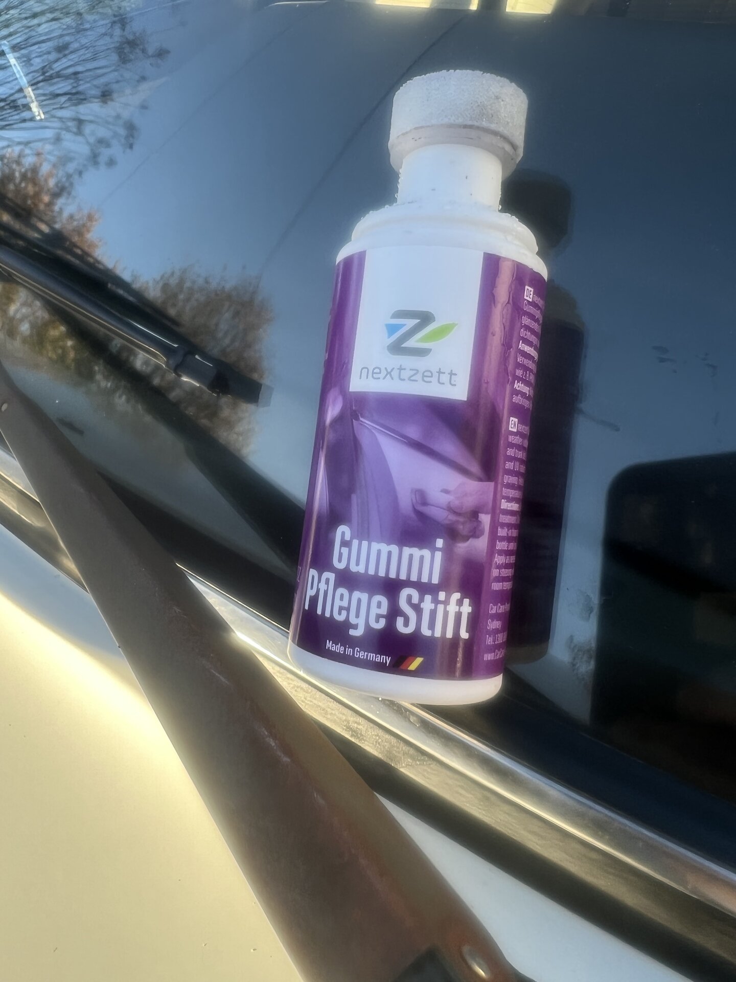

The motor may work without any resistance of the window in the old, dirty rubber tracks but may not be strong enough to over come the resistance with the window installed.
I'd remove the rubber window runs, clean real well with Dawn dish soap and a brush. Clean the edges of the window too.
Then use some Gummi Pflege to recondition the rubber. It may take a few treatments.
Then just a bit of silicon in the runs to help the window glide.

Thank you! Didn’t think that the motor might not be able to move the windows with resistance, but makes sense.
Now that I’m in there, I am seeing the regulator and the tracks need a proper cleaning and re-application of lubricant. Will grab some Gummi Pfledge for the rubber.
