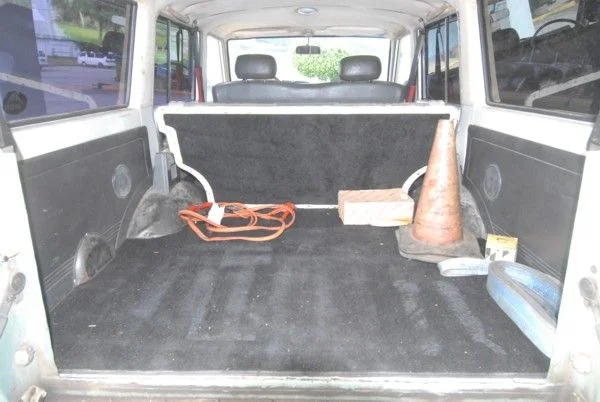

Here's a picture of the rear cargo speaker placements in my truck.
attachment.php
What size are those? And are they in factory mounts?
The factory has a mount on one side only. I think it was the passenger side. I got another mount out of the second piggy we needed to make mine so I have one on each side. I cut the factory speaker cover into a second cargo panel for the stock look. If you didn't know better you'd say it was stock.
They take a standard 5"x7" speaker so long as it has mounting tabs at each end of the long axis.

For some reason the wiring harness switched sides sometime around '75. I'd bet that's when the speakers switched sides as well. I just ran the opposite side speaker wire along with the wiring harness all the way around the back and then up to the front to catch the second speaker. I had the whole wiring harness out of the truck at the time so it was easy.
