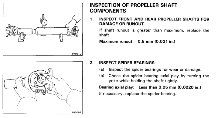

My first thought was that there might be something wrong with the rear prop shaft so I compared the front and the rear and there is definitely some play in the spline of the rear prop shaft while there is none at the front. Hard to quantify as it is only a fraction of a degree but it is still quite noticeable when I twist the shaft holding it from both ends. This play appears to be only when twisting along the spline axis which corresponds to the spline teeth backlash. No movement radially so I expect very little runout if at all (I haven't removed the prop shaft yet).
I've had a look in the RM183E body/chassis manual and while it mentions maximum runout and bearing axial play it says nothing about spline backlash...
