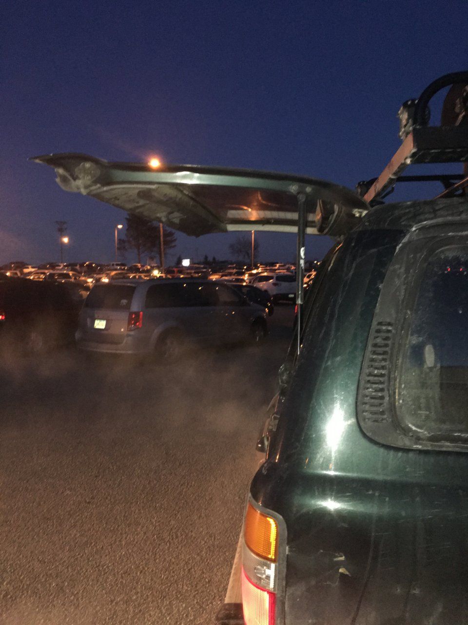

Do they lift the gate above the factory height of horizontal?
I believe the stroke length is 18.39, which would be horizontal...I can confirm once they arrive. At 6' tall, I don't really need any extra lift.
Boy I think so. I'm almost positive. I will snap a pic in a few when I get done at my daughter's show choir.
I don't have a tape measure with me but it appears that they open the hatch about an inch or so higher than level. I can put a tape on the extended stroke length when I get home.

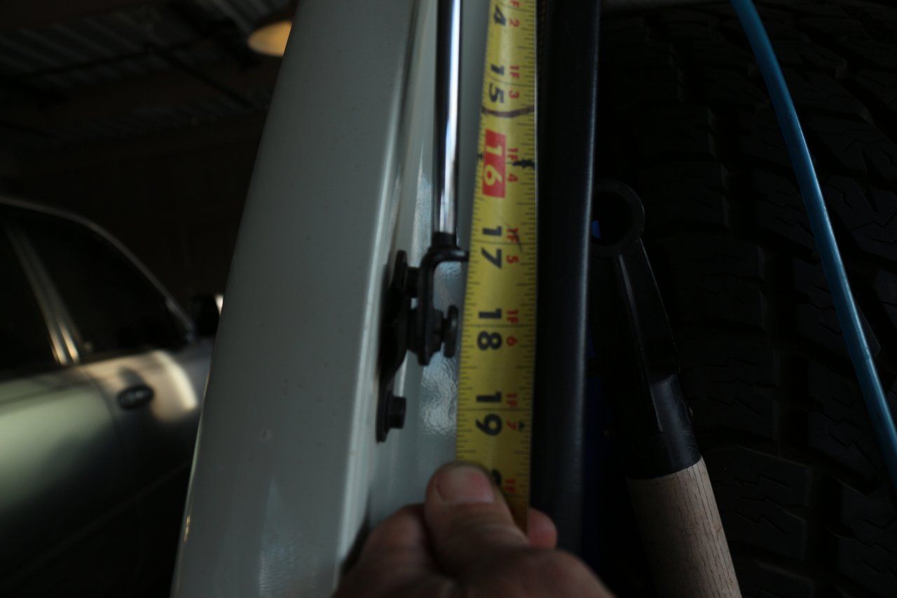

Not to make it MORE complicated measure from pivot point to pivot point on the strut it self. The factory measures 18 and two little lines:hillbilly:
That picture was taken at -6 degrees. I didn't push up on the hatch but I think it actually has a little more room to go up.

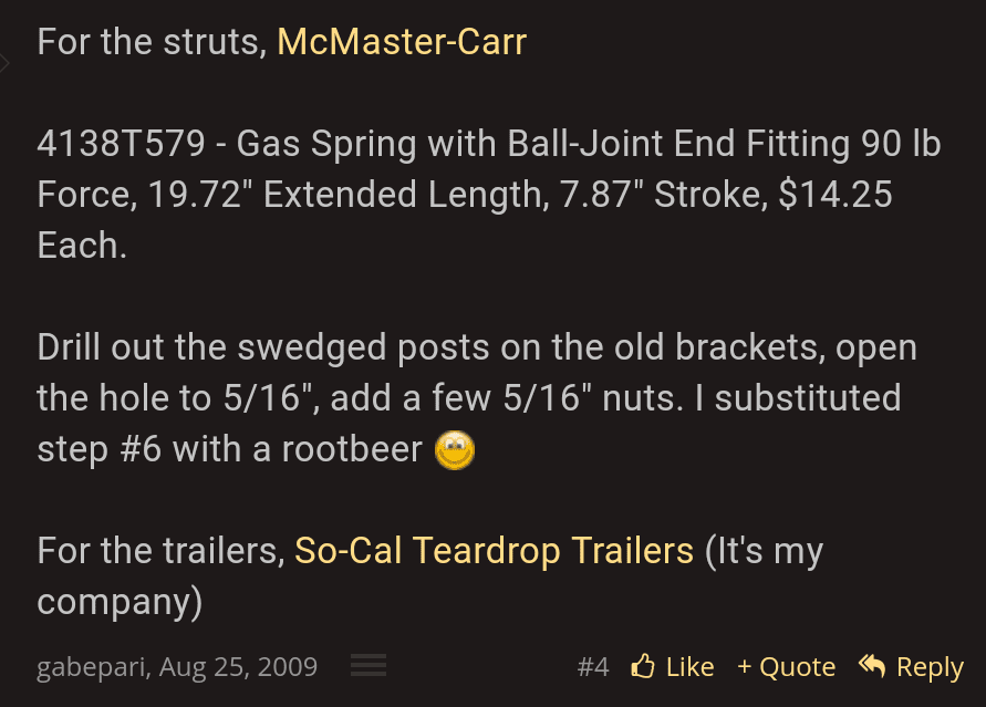

McMaster Carr ones have been great on my rig for last few years. Hatch opens up higher, no more hitting head!
This is a link to the ones that fit the 80. Plug and play.
McMaster-Carr
Russ
What's the Force number you used or recommend? There are a variety of options on this bad boy.
Read the thread about it that was previously linked. If I recall, it is 90 PSI.
