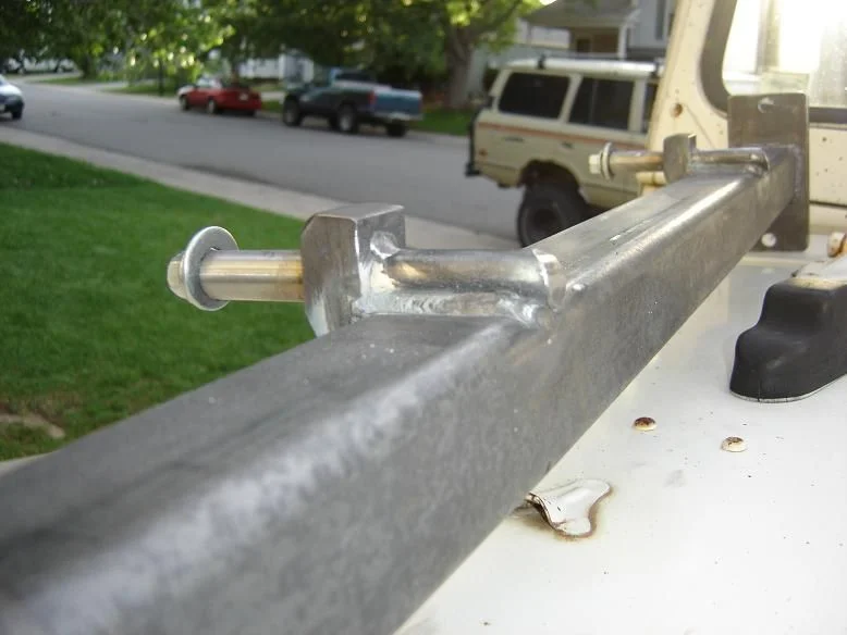

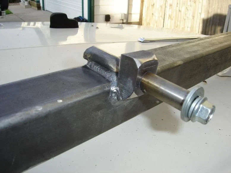

we have been working on this today.
straight bar with the mounts up high.
looks like the rest of whats left of the x-member coming out of the frame will have to be ground flush with the frame.
so start grinding!!!!!!
i'm thinking about using a long bolt for the shock mount instead of the way the factory set it up.
i'm on it without a camera.;p
here ya go brian :D
this one is done!
2x2x.120
1/4" plates
3/4" reinforcement for the mounting pin
5/8" tooling rod fully welded, drilled and tapped like the factory.

WOW! That is nice! I just had this repair done a few months ago, and the bolt in idea looks great! The quality of your work looks great! I wish I knew how to weld like that!

2bad - you build steel fab's like a pro.
I like it !! Nice goin' !!
