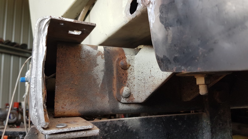

Chopped to rear and actually made new frame rails tapered up in the back. Trimmed the rear rockers too.

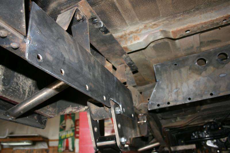

I have an idea of using a hayman reese tow bar like this (the receiver is inline with the rear crossmember) inline with the frame rails
, possibly bolting into the angled frame supports.. and then fabing an outershell like this..
