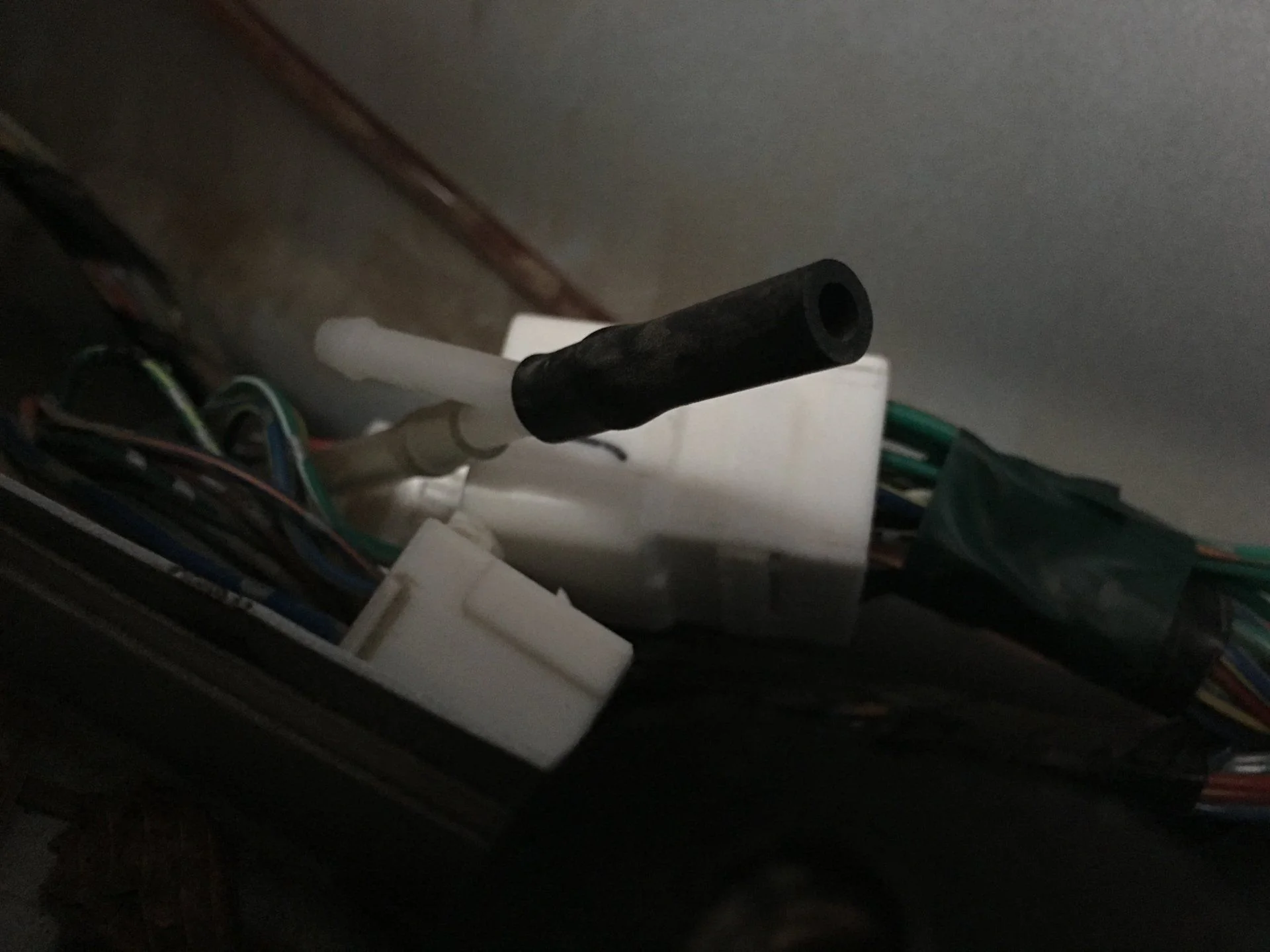

Thanks. Making progress documented here:
Curious what these extra washer like tubes are for.
