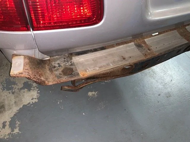

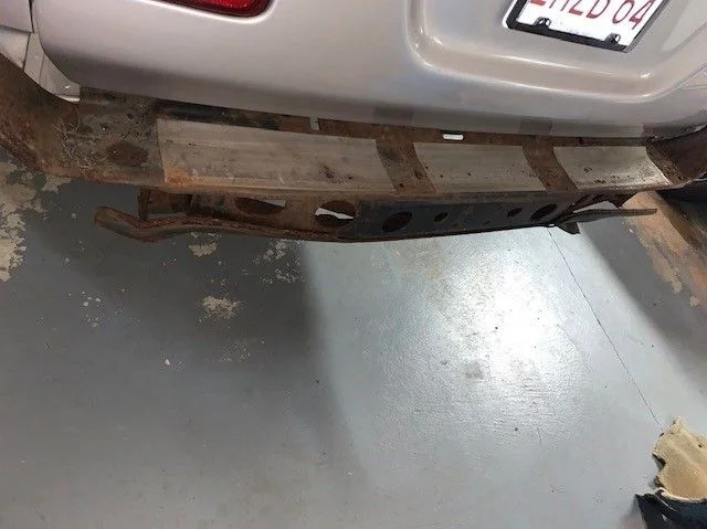

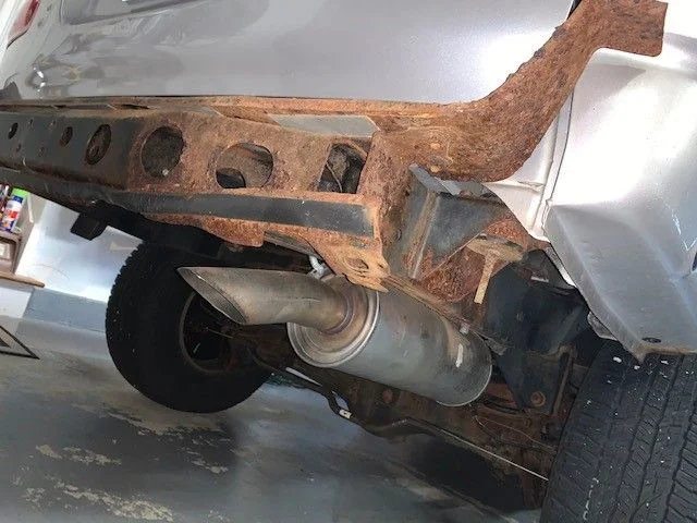

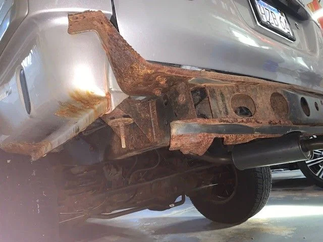

Hey folks!
I finally got the rear bumper off after a long battle with one rusty bolt. This is what I have.... see pictures.
Any recommendations for moving forward from previous experience? Also, any idea if this part that seems like a "buffer" behind the bumper should just be replaced?

I'd take a wire wheel or needle scaler to it and it see if it is salvageable. That would save you the major headache of dealing with the rusty bolts, drilling and re-tapping the broken ones etc.
Then tape up the bodywork and go to town with this: Amazon product ASIN B001DEL6J6Also coat up the lower rear fender skirts inside and outside, before they lose the battle to rust.
I had the same problem and ended up replacing the rear bar. I also got the whole section back of the rear axle wire brushed and then the whole thing repainted with special epoxy paint.
POR15
