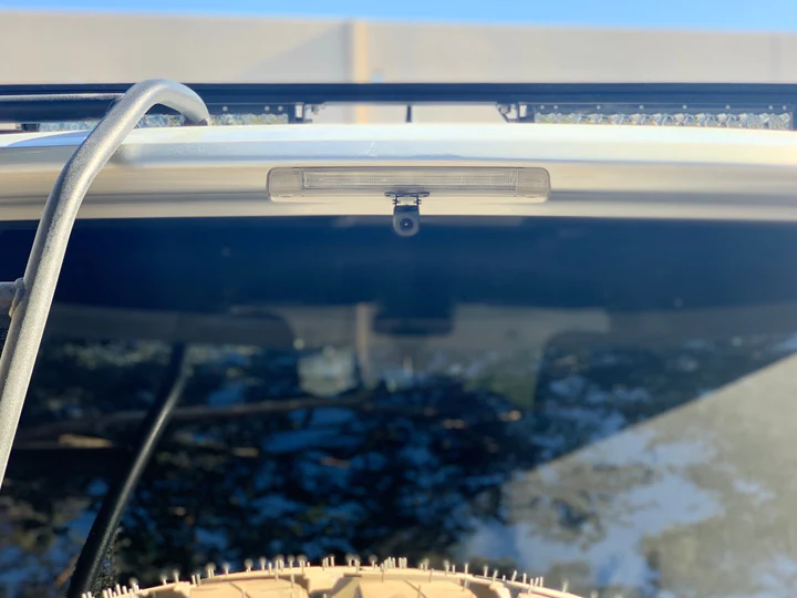

Anyone moved their backup camera up under the rear spoiler/3rd brake light area? There are 4Runner kits for this and I like the idea. I'm just trying to work out if this is actually a good idea or if I would get the pop-out window halfway taken apart and never be able to put it back together again.

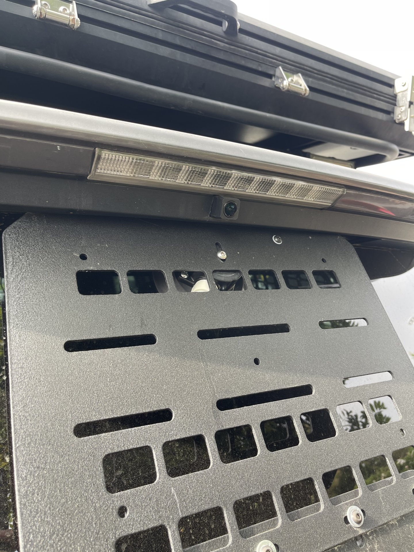

I have the camera for my rear view mirror stuffed in my spoiler.

Only issue I see is that the 4R's rear window rolls down, and ours hinges up. Having it there my cause a problem if you ever open the rear window.
Work around may be to attache the camera to the window?

Remove the spoiler, remove the 3rd brake light, and there was just enough empty space to fit a camera.

The spoiler lifts up with the back glass. I never had an issue opening it (before adding the molle panel)
