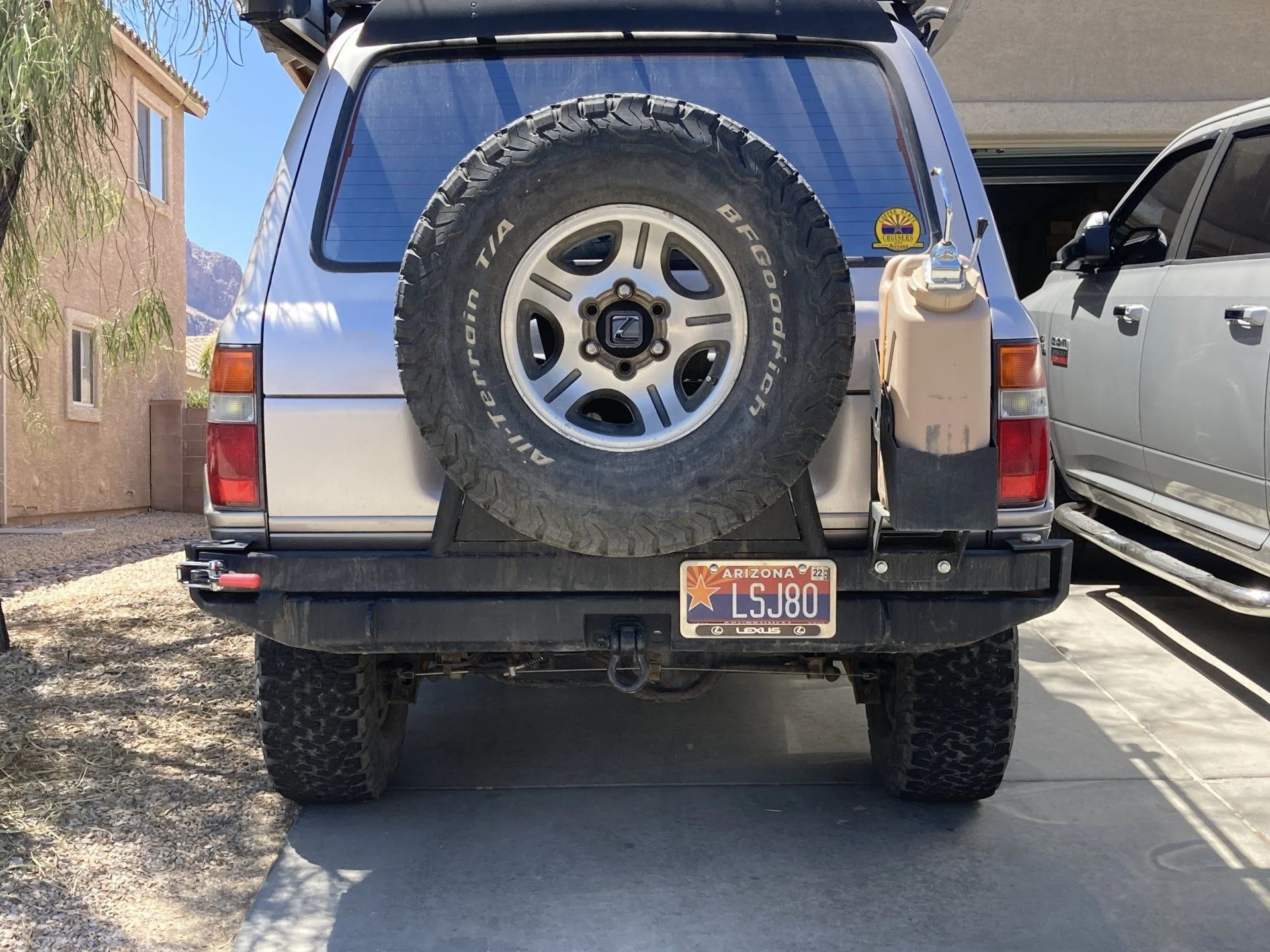

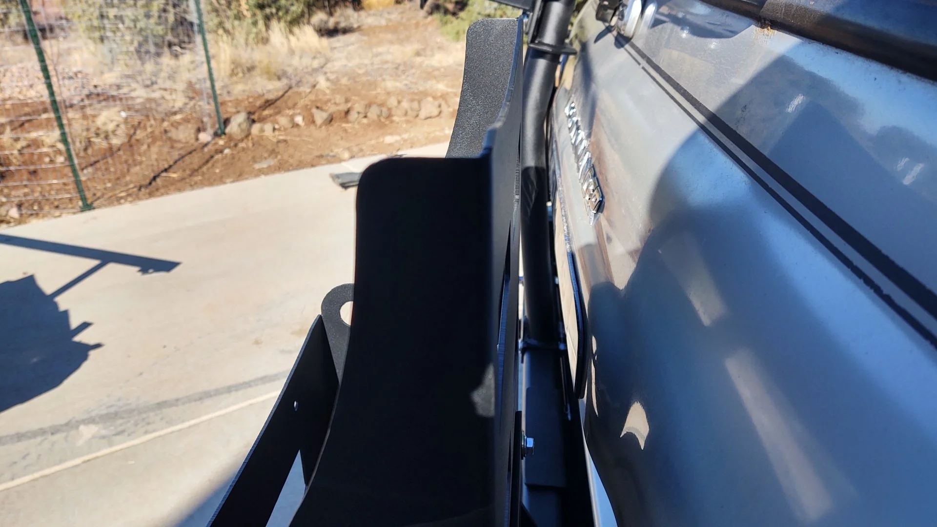

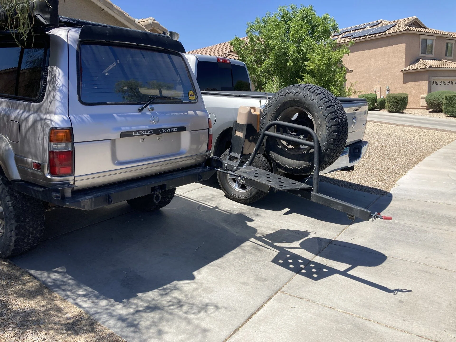

The only down side to this bumper design is the tire carrier. The top part of the carrier is very close to the body of the FZJ. It will actually will make contact leaving a mark. I used some rubber pieces to cover and its been fine.
Hey Matt, The top part of the tire carrier shouldn't be that close. It should be about 1.5" away from the truck. Something is going on...
I'd check by opening up that arm and if you have a straight edge or something similar.. the top of the tire carrier should be even with the vertical edge of the inside of the arm. If it is, then my guess would be that the bumper might be pushed too far onto the truck. You should be able to loosen the bolts and shift the bumper back to give you better clearance. If the top of the tire carrier overhangs the inside edge of the arm, then something happened when it was assembled. Let me know and we'll send you another one.

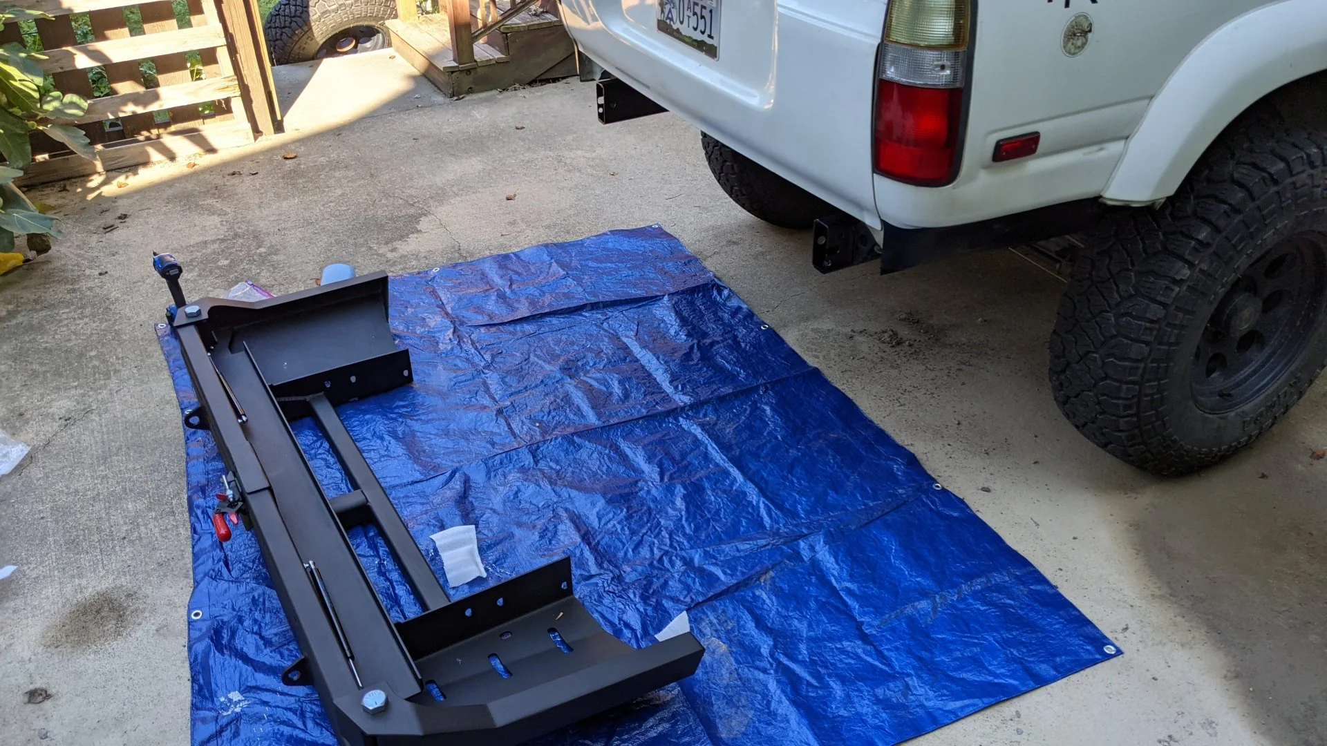

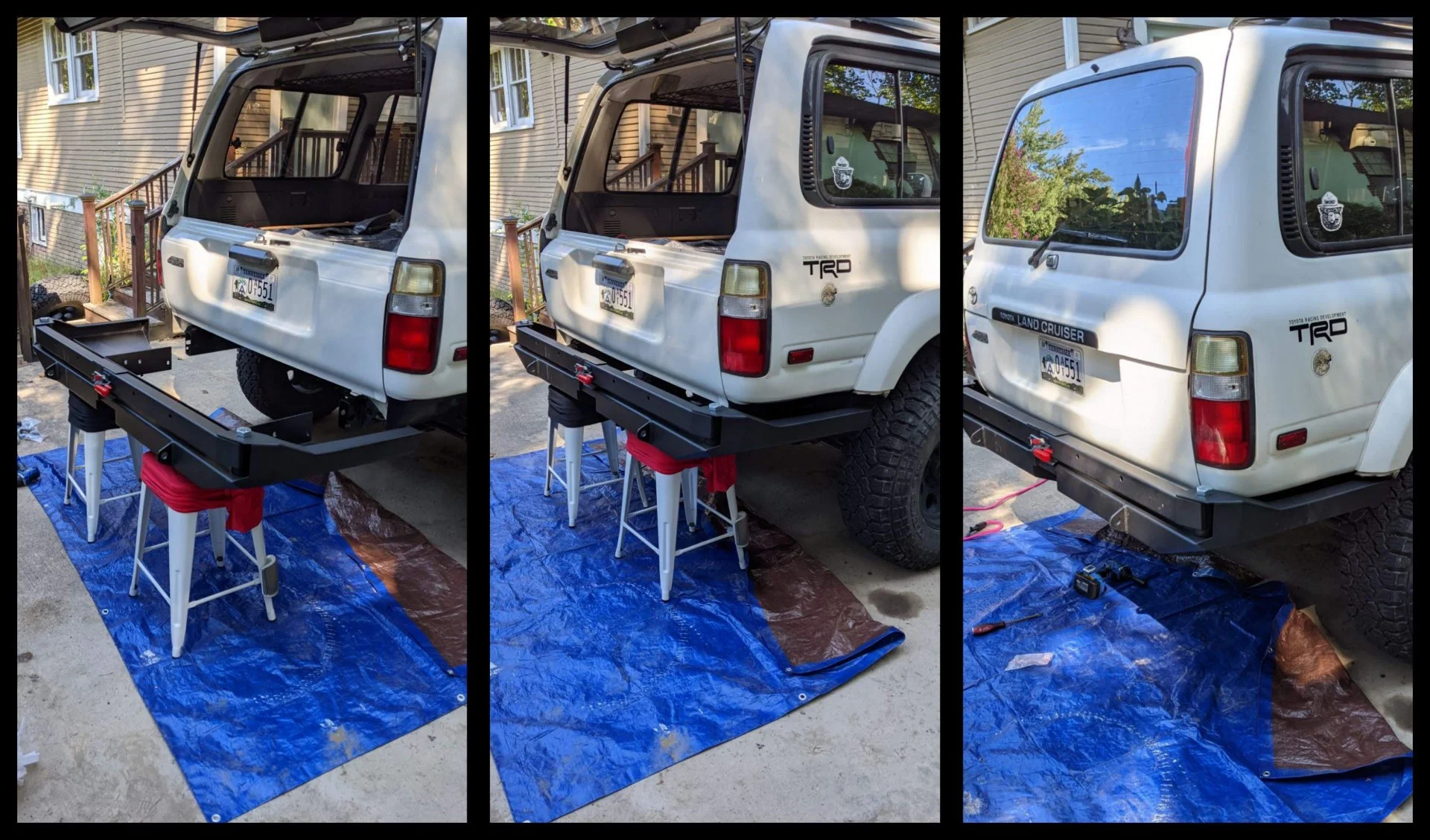

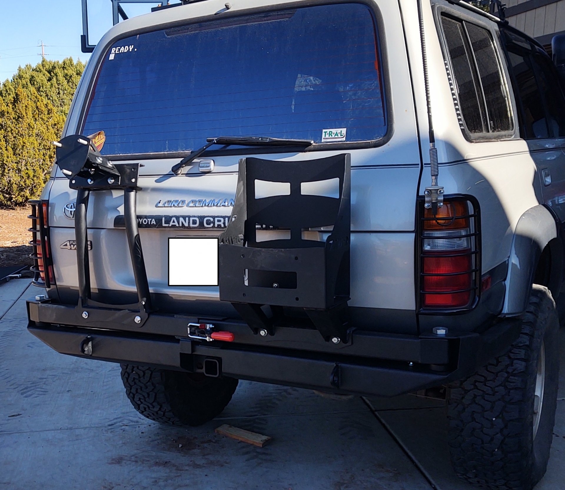

I meant to post an update sooner but...I was slacking. I received my bumper a couple weeks ago and got it installed. Overall, I am pretty happy camper! Shipping was quick and the installation was straight forward. My only regret is not ordering a jerry can holder for the other arm when I ordered the bumper. That will be resolved in the near future.
This is the only rear bumper that I have purchased so take my pros/cons with a grain of salt.
Pros
-Ease of install
-Strong arm struts with zerks on the hinge
-Adjustable tire position
-No rattles
-Nice lines with a tight fit to the body
Cons
-I have to have a con for a pros/cons list.
-I had to slightly clearance one of the bottom bumper holes. Easy fix and this could be a an issue with my frame so not really even a con.
I hope to add some action shots later but in the mean time...

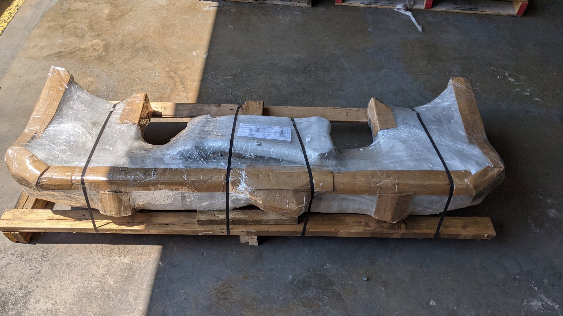

Well packaged!

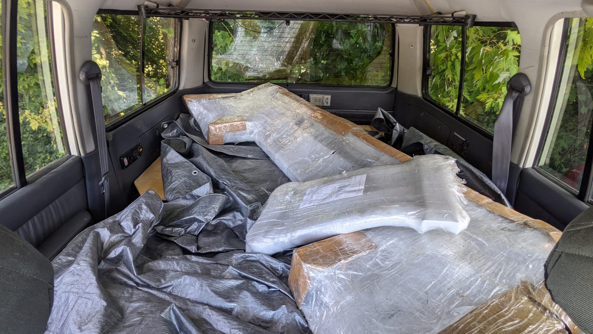

Tight fit in the back of the Cruiser
Unpacked and staged
Using the right (s)tools for the job! :rimshot:
The only hiccup for me was finding the bolts from my tire hoist. I had removed it a while back and failed to keep the hardware. They are 8mmx1.25 FYI.
