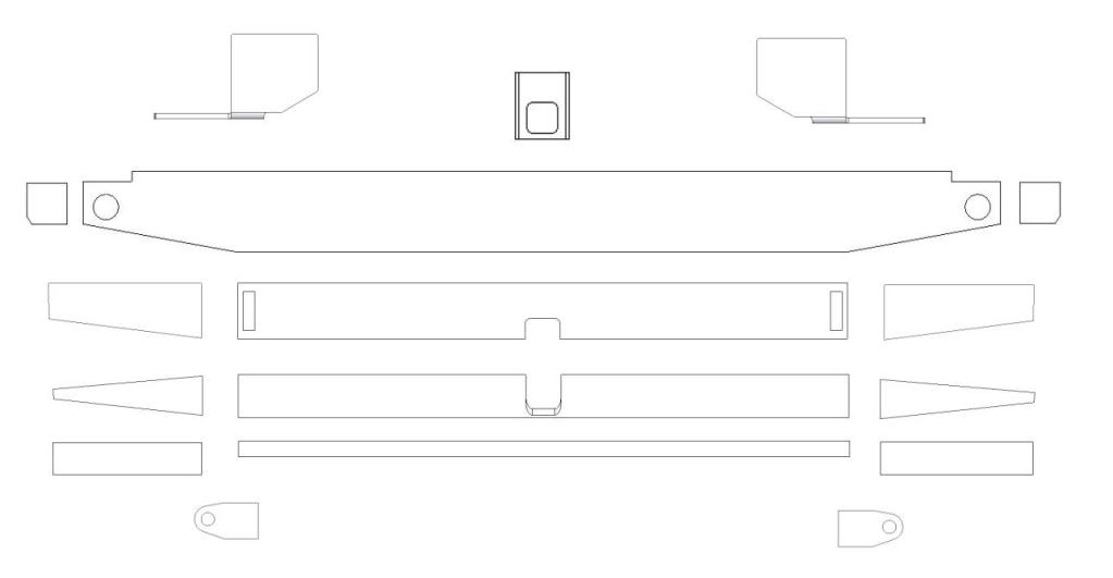

OK...here is a diagram of all that is included with the "base" kit. Should help answer a lot of questions.
thanks for that pic of the layout of cuts. very helpful.

That diagram helps a ton. Now I see what I'm getting. So, come spindle time, do they just drop in and get welded into place? Will you sell the swing arms in kit form also, or are they simple enough to make just from plans?
i think this is advice worth following on the spindles.

What are the 3 pieces on the bottom (above the d-ring tabs)? I assume they go on the very bottom of the bumper but haven't seen any pics of it from that angle. Thanks.

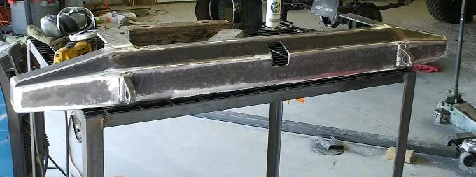

If you look at MTN.GOAT's build (page four, post 105), on the first picture, you can see the pieces you are talking about.
attachment.php
Does that help? I don't think I used the thin middle section if I remember correctly. I will have to look at mine again.
Well, kind of. To explain what I did, I bought a spindle with about 4" of additional length. The spindle drops through the hole and butts up against the rectangular sections on the bottom of the diagram. I should number each piece so we can keep track. You have to cut the spindle at the bottom where it meets that piece at about a 15-20 degree angle (I could probably calculate a closer angle, but that is close). Does that make sense?
