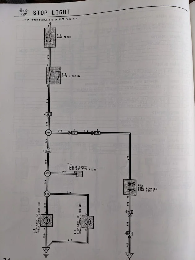

My passenger (R) brake light keeps burning out. But just the brake filament. The running light filament in the bulb is fine. I've tested voltage at both circuits coming in to the bulb and measure 11.4 - 11.6 V with ignition off and 11.6 - 11.7 V with the engine running. Both the brake circuit and running light circuit read about the same. The drivers side (L) taillight works normally reads about the same voltage. The turn signal and reverse bulbs are OK and work normally. The third brake light on the hatch works.
Here is what I've done aside from measuing voltage
I can replace the bulb and press on the brake pedal and it works normally.
I can start the engine, press on the brake pedal and it works normal.
I can turn on the headlights and it works normal.
Once I start driving around, the bulb blows. It blows whether the headlights are on or not.
I completely disconnected my aftermarket trailer harness. No change.
I've traced wiring and continuity back to the BQ1 connector and cleaned the trailer socket.
I assume that I'm getting a voltage spike while driving, but I don't know how to diagnose that or measure it.
Any Ideas as to where I should look next?

Based on what I've seen from unwrapping harnesses, I doubt it's a break in the insulation under the wrap. I'd bet it's the pigtail.
I, also would bet it's a short in that bulbs circuit. It's current (amps) that's blowing that filament, same as a fuse. I've seen "twilight zone" type problems in light circuits before, several that replacing other bulbs in the same circuit fixed the problem. It's the multi-filament bulbs that can somehow get a short in them and cause havoc in trouble shooting. Short of a damaged harness or socket, that's about the only point where a short could happen. Cheap bulbs can be more trouble than they're worth. Looking briefly at the above schematic, I'd try replacing both bulbs (PS & DS) first. If that doesn't fix it, it might even be the stop light switch.

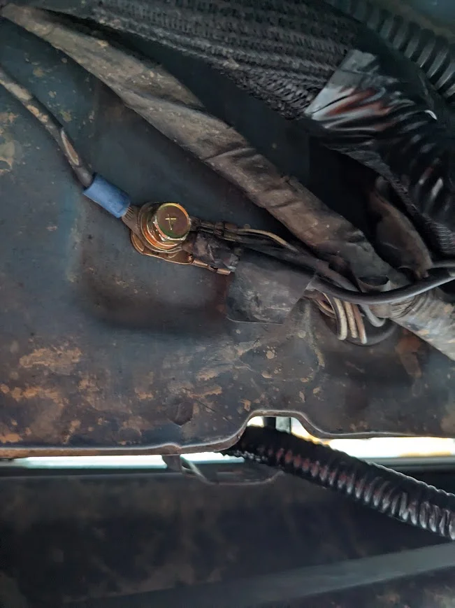

I think I have this solved.
I cleaned up the ground for the brake lights that is located under the tailgate. Instead of just wire brushing the terminals like I did the first round, I cleaned, tapped the threads and put in a fresh, clean, shiny, zinc plated bolt.
Then the drivers side brake light blew. Arggh
This made me check voltage of the other things that were tied to that ground point. Turns out I had a short to ground from my cheapo Amazon backup camera that I installed a few years ago. That camera was acting wonky lately, especially after my 4 days on the Rubicon last month.
I think what was happening was that the camera was sending voltage to the ground point, but instead of ending there, due to a poor connection,the 12v went to the brake circuit. Once I reversed the truck, activating the backup camera, and then tapped the brake, the filament would blow. That is why everything tested ok in the driveway. It overloaded the filament only when I was reversing and hit the brakes.
