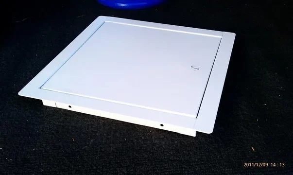

Got my panels and started my install
I had check the ones home depot sell and found them too be too thin and flimsy..
I was hoping the ones I ordered where better.....
They are !!!!
These are 10"x10" opening and the lip is 1.5" wide making them 12"x12".
They feel a bit heavy but I doubt they will rattle at all....

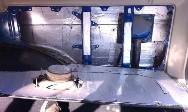

My quarter panels with wood instead of cardboard
Backed with sound deadening
BTW I did cut the Xmembers for the panels to fit..

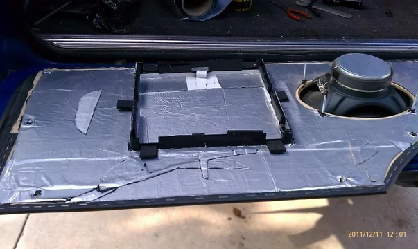

Cut hole to size and fitted...

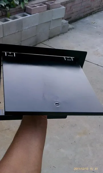

They will be painted black..
Its close to the speaker as the fill up tube was on the way..
It will have to bolts at the top and the tabs that are used to screw to a wall stud will be bent against the wood panel...
I cut the sides to bend them alter once the final install happens.
Up high as I will be getting some drawers later on...
I will install them witht opening down.. will see how that works..
coat of rattle can paint and will put them in tomorrow..

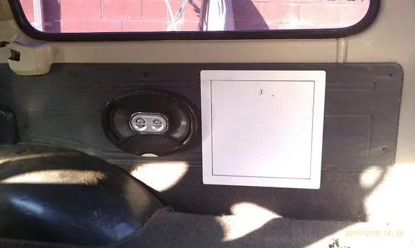

Here is the driver side..
This one I was able to put it further back as there is no obstruction here...
The back side of of the door panel will be lined with deadening to keep it from doing any rattling....but I doubt it will do that at all...

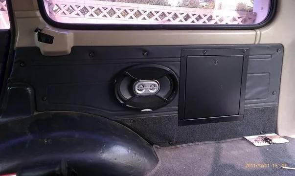

Looks nice. Does the ~1" flange on the inside make it hard to reach all the way in there? I've been thinking of making something similar for awhile, but the price is right on those.
How about coaxing the lip flat, like long tabs?
Flange does not get on the way of things....
You could bent the lip flat except for the corners that's where they are spot welded together...
I already stuffed one side with all the spare parts I might need incase of a brake down...
even have a cheap Army surplus shovel in there...
The other side will be for fluids...
