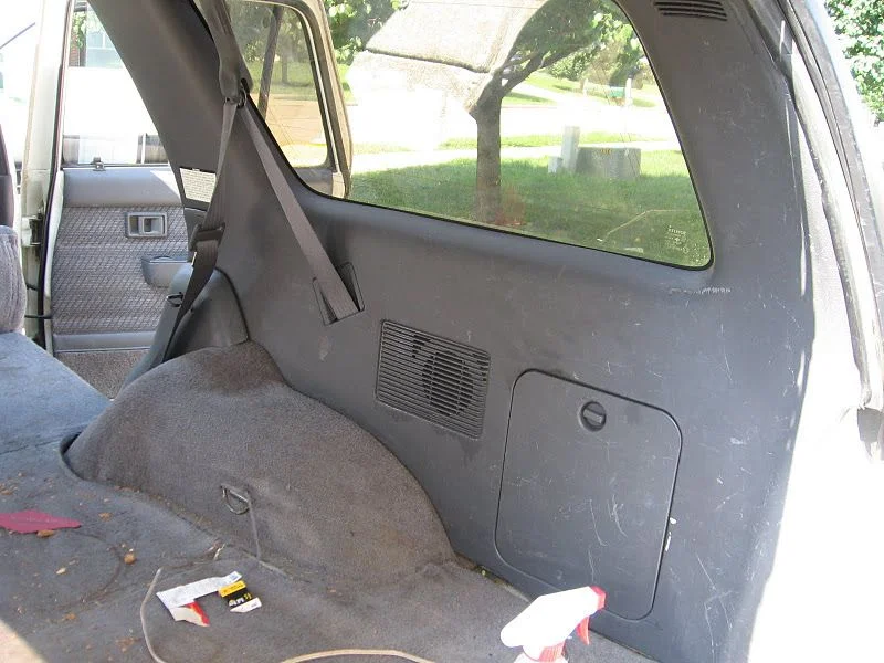

I have some steel panels that I cut up many years ago. I noticed on my dad's 93 4Runner there are some nice little plastic doors with a latch that can be removed if you have some small things to store. My plan is to weld a little behind the steel panel but attached to it (I don't want stuff rolling around in the fluid film I spray down there) and then put the door on the top, keeping it all Toyota :)
Here is a pic I just found on the net http://www.google.ca/imgres?imgurl=...rlz=1T4ADBF_enCA316CA380&tbm=isch&um=1&itbs=1
Oh and my panels are held on with speednuts and machine screws (well they will be when I put them on the FJ, on my BJ I welded nuts on so that I could use bolts, but that was a rusty old truck, I was not concerned about making a mess of it!)

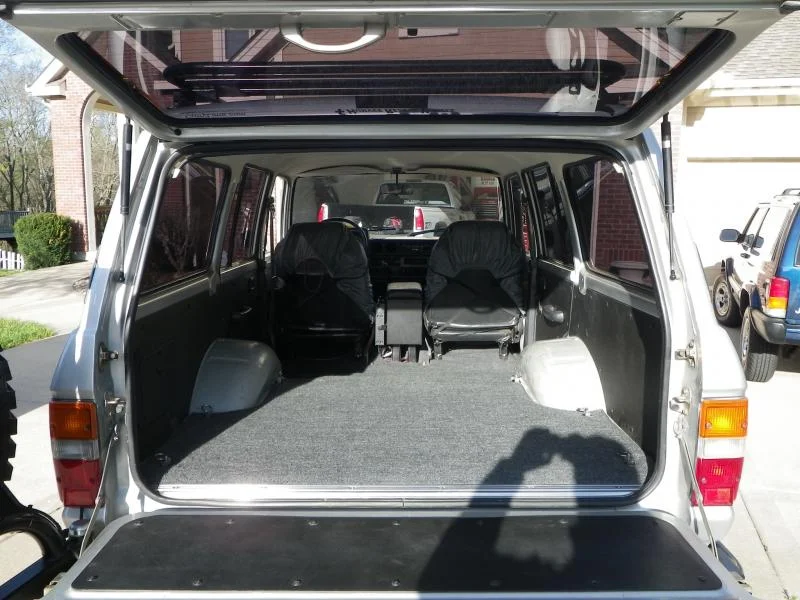

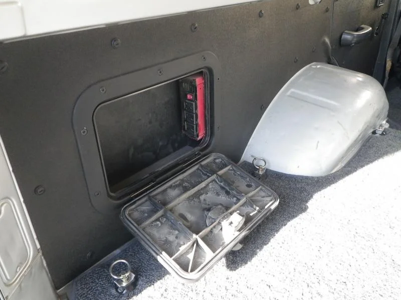

Here's interior panels made of 1/8 in. ABS plastic and a marine hatch covering up the power port station holding (2) 12 v. plugs, AC Converter and a 12 v. rechargeable flashlight.

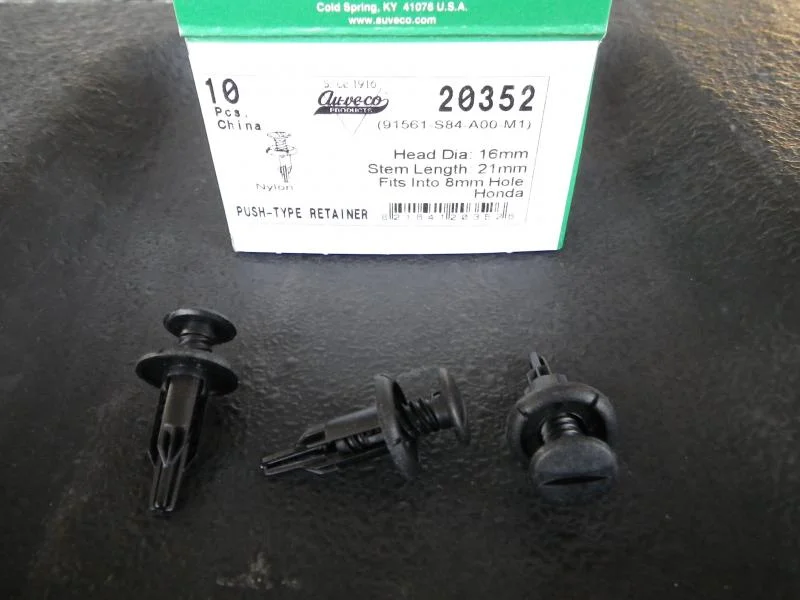

The last pic. is of the automotive fasteners used to secure the panels to the existing holes.
Good luck!

You can use your old panels as the pattern and a hand jigsaw to cut the main body, hole saw for the window cranks and drill for the nylon fastners. Very easy.
I researched having the panels manufactured, but after CAD design, cutting and material cost, the price would have been more then most mudders would want to pay.

Good fasteners. I've been looking to redo mine with some rivnut/nutserts as I like having tie down hooks on the panels, and don't want them popping off. Though maybe I could just bolt some to the sheetmetal above the panels, and make a couple cutouts along the bottom of the panels for some lower tie downs.

No no no...my bad, I was just asking about the marine hatch.
