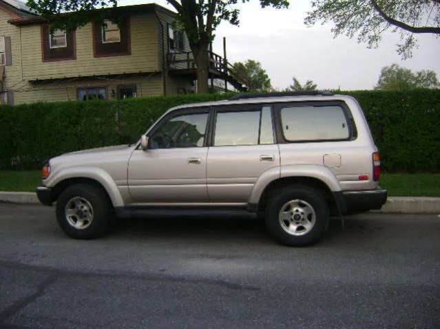

this is a fantasic machine.
15yrs and 188k miles, and you would never guess it.
here's the proof that even a commoner can attain such a prize as this.
i'am in love with this.
