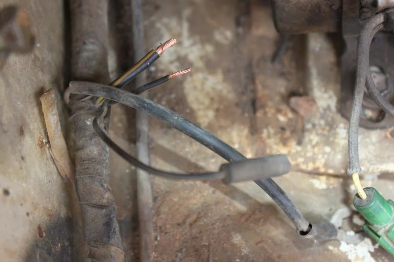

So, I only have two wires coming from the igniter/coil assembly, one large b/y that goes to the + terminal of the coil, and a small black wire that goes to the igniter. Because of this I am not sure how to follow your instructions since
"Connect the power wire for the ignitor to the same end of the resistor as the large B/Y. (I'm not sure what color this is.)"
I don't have this as an option since the only two commectors from thec assembly are the two I stated above.
"Connect the small B/Y wire from the starter solenoid to the + side of the coil."
Unless I tie the small B/Y and the large B/Y together the only option is to have the small B/Y wire tied to the wire that enters the igniter.
I found the wiring diagram in my Haynes manual that matches the 5 wires from the igniter and the two inputs, but I am not getting spark from the coil.
Still trying to figure it out. I am going to get my meter out to test the coil, does anyone have any info on testing the igniter/coil combo?
What I did was wire the large B/Y from the wiring harness to one side of the resistor, then went from the other side of the resistor to the + terminal of the coil. The next thing I did was wire the small B/Y wire from the harness to the wire that entered the igniter. I tested and I didn't get any spark from the coil. I didn't have it bolted down to the body, and didn't have the - battery cable hooked to the body, so this might have caused an issue and I will go and test that now.

You shouldn't need that resistor with that ignitor. You should just be able to hook up both B/Y to one of the connectors off the ignitor. I think its the yellow one. The ignitor grounds through the mount so if its not mounted you need to ground it. Did you hook up the connectors to your starter?
It is this large B/Y wire that connects to the resistor and the little one connects to the + side of the coil.

So, got it wired up last night and she fired up. Because the Igniter/Coil was from a 8/80 and later 40 I decided not to use the resistor since both the wiring diagram and the responses here on mud reaffirmed the idea that it is based on coil year. I then verified the igniter/coil unit was well grounded to the fender, and that the fender had the ground bolt securely bolted to it. Once completed I wired the unit based on the cut wires from the coil. The large wire from the coil matched up with the large wire from the loom, and the small wire from the coil to the small wire from the loom. Again, this matched the consensus of the group as well as the wiring diagram.
