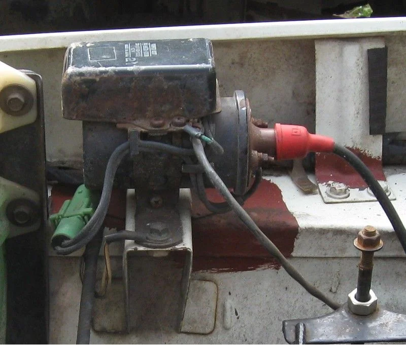

This is the coil and ignitor of my '78. I bought it new and haven't changed it. I can try to get more detailed photos, if you need them.

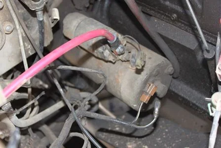

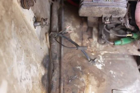

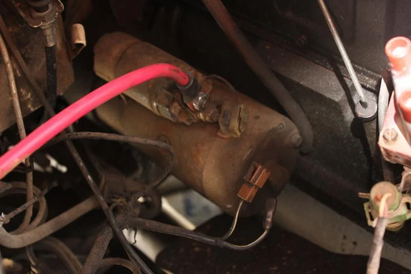

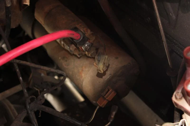

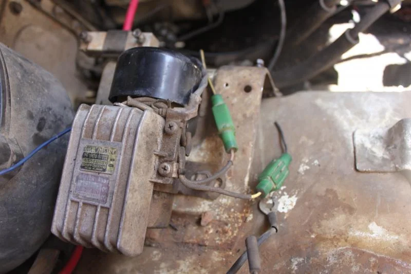

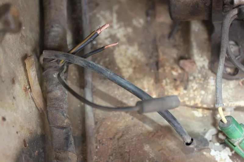

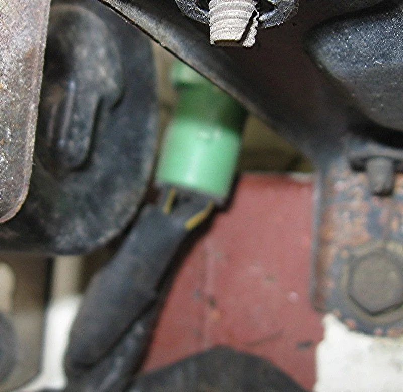

Thanks for the reply's, attached are pictures of what I have, maybe someone could make more sense of it than I can.
Thanks
And More.......
So, the resistor that you see in the picture I believe was an add-on the previous owner installed when he removed the coil/igniter and went with a coil only and 60's era distributor. On Friday the 60's era distributor gave up the ghost so I decided it was a good time to put it back to stock as much as possible. From the purchase I had the original igniter/coil and distributor. During this process I decided to put a stock 78 carb back on it as well. Anyway any help would be and already has been greatly appreciated.
Thanks
As you can see on the igniter/coil itself I have a large gauge black/yellow wire, and a smaller gauge black wire. The cut wires in the factory harness are large gauge black/yellow and small gauge black/yellow. From what I gather those both would be attached together and would be attached to the large gauge black/yellow of the coil. The problem I have is the other black small gauge wire of the igniter/coil, where does this get connected?
Sorry about the quality of the first photo. The camera focused on the bolt, rather than the connector, but you can still see what I wanted you to see. :D
First photo is the back (harness side) of the coil/ignitor connector. One large B/Y wire that runs to the coil + and one small B/Y wire that runs to the ignitor.
The second photo shows the coil side of the connector and the two W/B ground wires that also exit the harness at that point. I don't have the bullet connector shown in your photo, but a set-up like that is typically for a condensor. My truck is early '78, perhaps yours is later and has the condensor connection. My '78 wiring diagram does show a condensor, with a B/Y wire.
Third photo is of the starter connections. Battery + cable, of course, with the quick-disconnect-lugged B/Y wire going to the QD lug on the starter, and the 1-pole connector B/W wire going to the connector on the starter.
Your ignitor is a later model, but that should be OK. I don't know exactly what model without looking up the part number. It doesn't look like your resistor is even hooked up. It looks like you have everything you need to hook your ignition up properly.
The large B/Y wire powers the ignitor and the coil through the ballast resistor. The small B/Y powers the + side of the coil only when the engine is cranking. There are also wires that connect to the distributor and the - side of the coil.
Alright, with that I believe I see what needs to be done. Let me run over my thoughts for clarity. I will wire the large b/y wire from the wiring harness to one side of the resistor, then from the other side of the resistor to the large b/y wire connector that shows in one of my pictures of the igniter/coil. The other black wire will plug into the small b/y wire from the harness. With that being said the smaller b/y wire goes into the igniter directly, and the larger b/y wire is one of the two wires connected to the + side of the coil.
