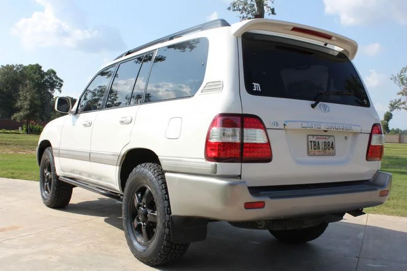

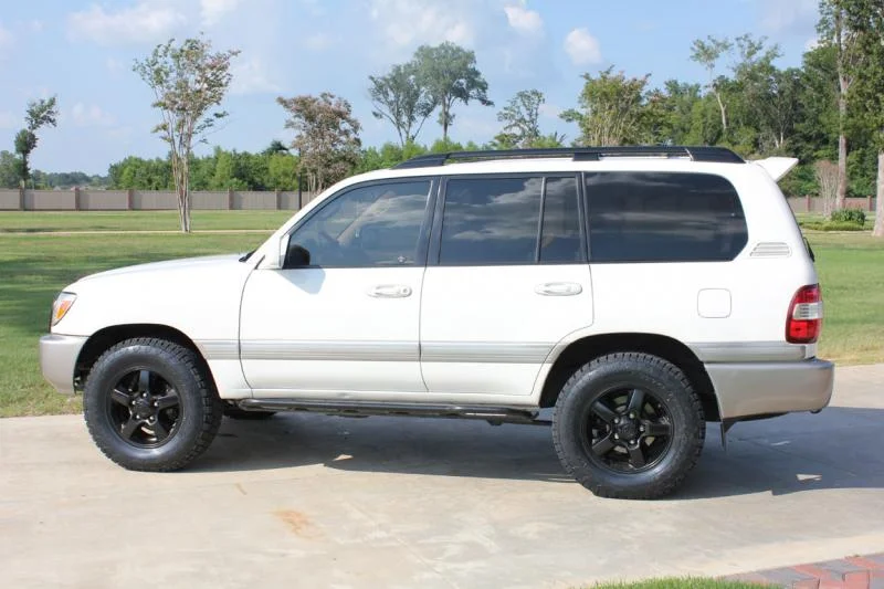

I don't have BFG, but my Nitto Terra G's are 275/70/18s. 3000 miles in and love them. They perform great on and off road.
My lift is an AHC lift, approx 1.5" over stock height. Not quite what you are looking for, but close.

HA! Yeah, how funny. Jim Norton it was. Thanks a lot for posting. I am just concerned that there will be too much wheel well with 275/70r18's and 2.5" in the rear. Nitto's were my other choice.
Neoworm, your BFG's look good. I like the look of that wheel size with the 866's.

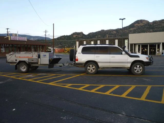

I have an 03 with an aftermarket trailer platform hitch & a Slee 2.5" lift. I would not go any bigger than 275/70R18 if you have this set up and want to carry a full size spare.
If you have the stock tow hitch, you may be able to get away with it, but mine pushed the sapre tire back & is less than 1" away from rubbing.
I have 275/65R18's on mine (x5). There is no way I could fit a 285 (r18) spare on mine, plus my tires are narrower & the spare doesn't stick down as far in the back, which is a big plus to me.
I don't know what rear springs you went with, but I have the 860's on mine & are, in my opinion, are almost too high if you don't have a rear tire carrier.
I wouldn't want my torsion bars cranked up any further & mine still has just over 1" of rake. In this pic, it looks level, but I am on a slight incline. It's not level at all, but not enough for me to change springs or crank up my TB's any further.
If you have no hitch, or a factory one, you can (as other pics can attest to) easily fit 285r18s on it. It will rob some power, but they look better with a 2.5" lift than mine do. I decided on my size because I like as much up travel as I do down travel, I like a full size spare & this size (along with the 275/70's) were almost $100 cheaper, per tire, than the 285's.
YMMV
