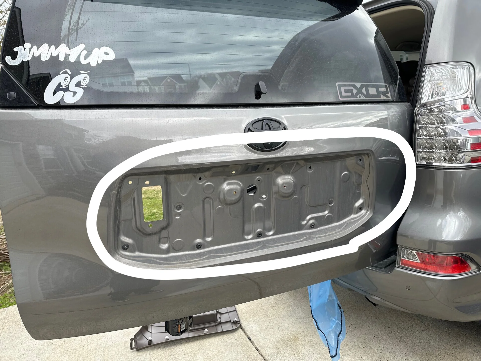

The ones I see online have a version that has a longer top panel like you have there. Pic of the bottom? Does it look like it fits the width of the licence pocket or will that need to be replaced as well?
Like this. It looks like the license plate panel itself is also different.
hm yeah it might not fit, i wonder what the number is for the shorter one

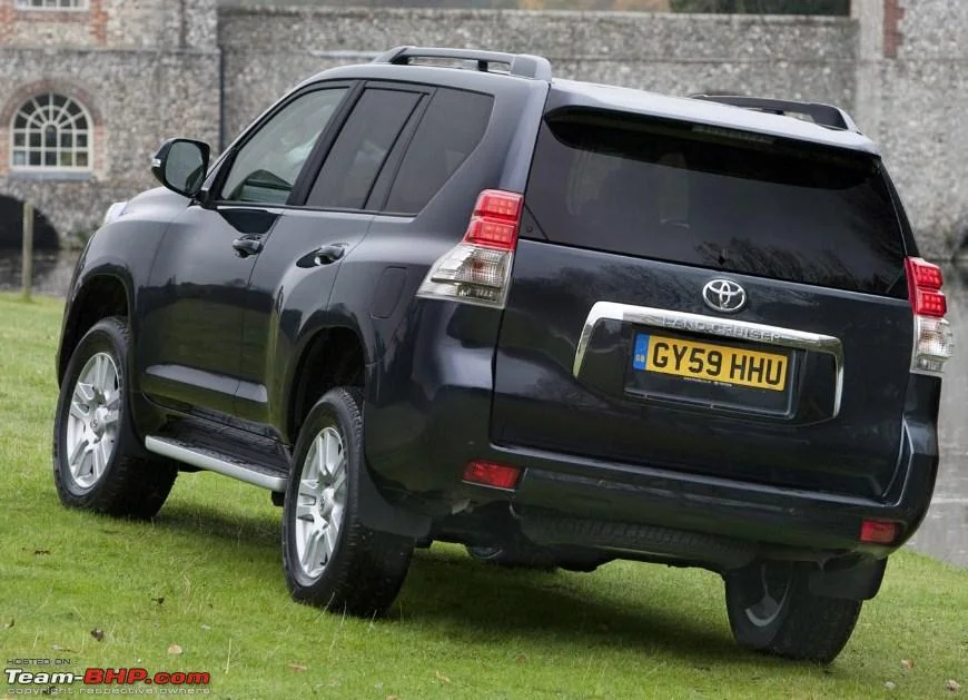

The pre-facelift LC Prado has a shorter one but it is also different. Here's a 2010.

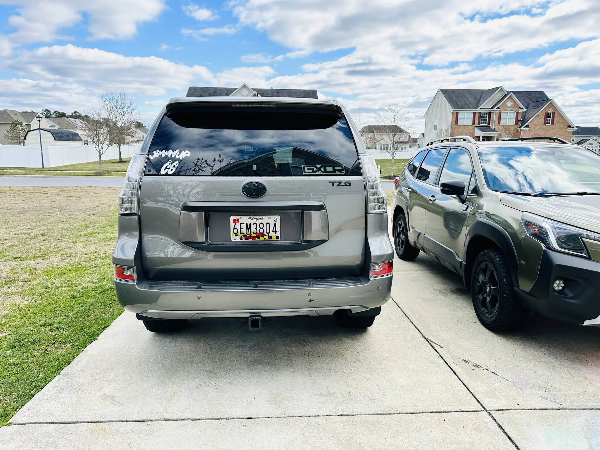

the shape of the one i have looks like it may fit around the pocket it’s just hard to tell without removing. that trim has like the upside down mustache. i know there’s another one that goes straight across that is like the same length as the GX version just can’t find the number for it

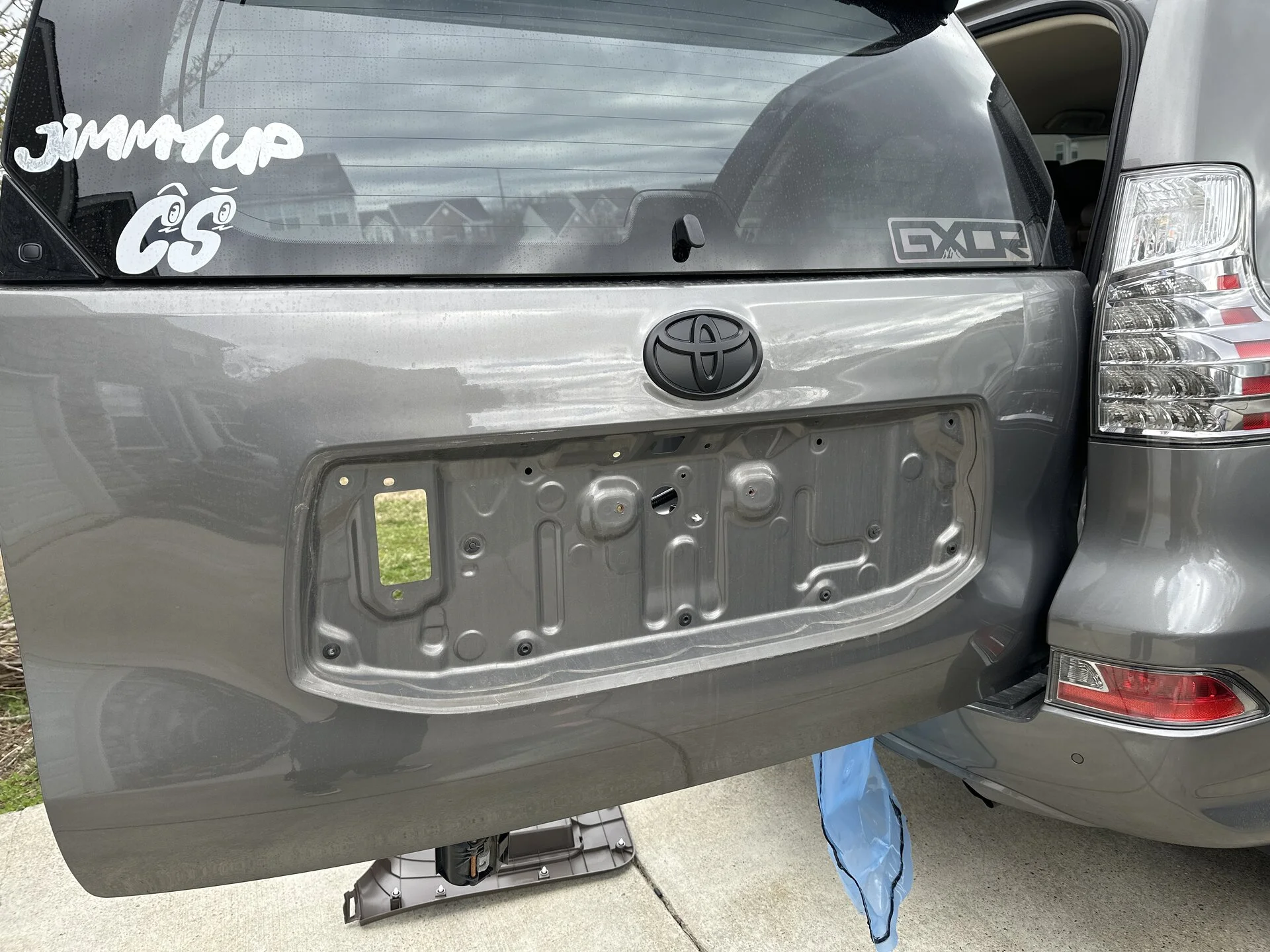

sorry to say it did not work, there’s just not the right holes for the clips needed to hold it in place
gotta hunt for that shorter piece especially since i broke off so many clips trying to get the original off
the toyota emblem fit nicely though

Question. Does that whole piece attach with clips or are there any bolts?
there’s 3 bolts and then it’s all just clips and the license plate holding it
Can you circle where the bolts are when you have a chance? I need to take mine off soon.
it’s the one right in the middle of the two holes you see in the middle and then it’s the two that hold the handle for the tailgate on the right hand hand side when you’re looking at it from inside
all 10mm nuts you will see them staring you in the face

Looks like the sheet metal is really specific to the shape of the licence plate holder, wonder if the later models are as specific and not just a wider plastic.

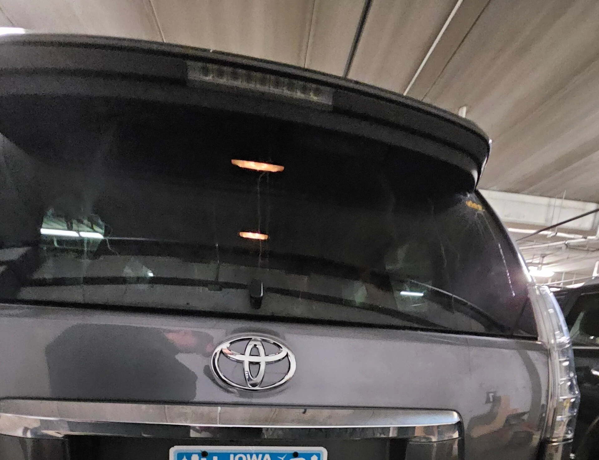

I bought the recommended Camry Toyota emblem and removed the black backing and slapped it on
I also removed the 2 screws for the front one and lost them. Oops. That emblem is on the way.

With the Toyota emblem I am definitely no longer getting the Lexus Hate anymore.
What "hate"?
In central Iowa I get tailgated a lot for whatever reason. Since changing badges, it has stopped.
