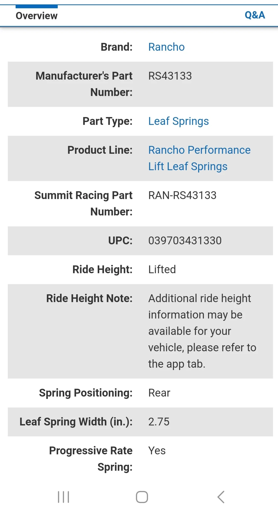

Rancho 43133 Springs?
Rancho Suspension seems to have a 1-800 tech line. I grabbed some info from Summit below.
this is what a google search returns... Summit says no longer available and simply "for more clearance and bigger tires"
I thought you were asking how wide the springs are. In Summit's chart it says the springs are 2.75" wide. You could call Rancho to confirm this.
