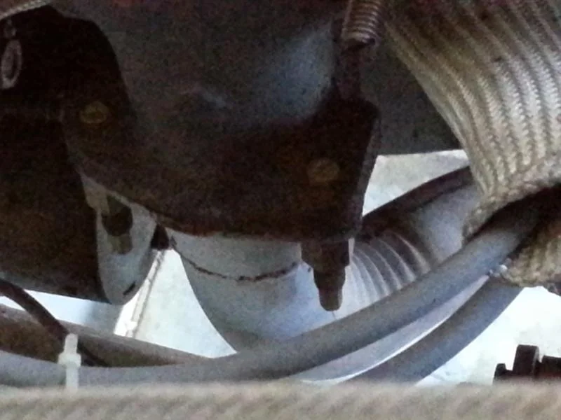

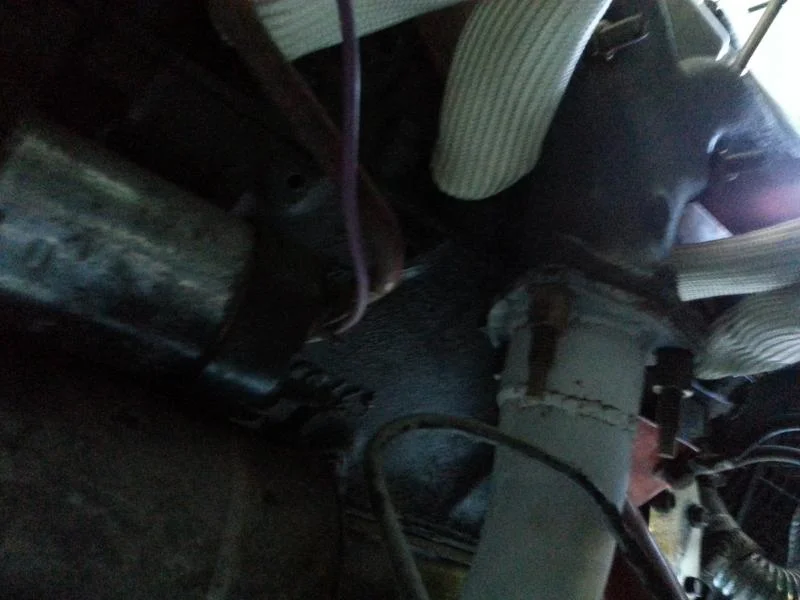

Okay, so moving at my normal mod speed I am finally about done. One thing I noticed when I was researching this in the first place it there were a lot of top shots of the ramshorns installed, but didn't see much from the sides so I've added a few pics below for future searchers.
I ended up getting the Walker crossover pipe, to use it without the heat riser I had to cut the factory end off which is made for the donut gasket, and fab up a flange and extension to mate directly to the manifold. Painted the manifolds with some 1200 degree paint, and stunk up the house heat cycling them in the oven. Wife was pleased. Got stainless studs from Mcmaster-Carr, and bought stainless nuts that have the sides dimpled to give more of an interference fit on the threads. Had to buy 25 so I doubled them up just for the hell of it. Still finishing the back half of the exhaust, so I haven't fired it up yet. Ran the collector on the crossover pipe right into a small radius and them a flex pipe, the OD of the walker pipe is almost exactly 2 1/2" which is what the rest of my exhaust is. The exhaust is now just above the frame rail, rather than in the rockslider position.
