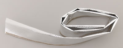

Here's a couple old pics I found

I had the fancy red wires and they smoked :(( I ended up getting a couple rolls of the plug wire shields pictured above and haven't had any trouble since. Mine melted right at the plug connector. I used enough on each one to bring it up around the manifold to the wire loom above the valve covers. I flipped the looms and spaced them off the cover to move them farther away.

I had the same problem. To fix it I used the straight boot wire and put the heat sleeve over the two inner wires on both banks (3,4,5,6). No more melted boots.
