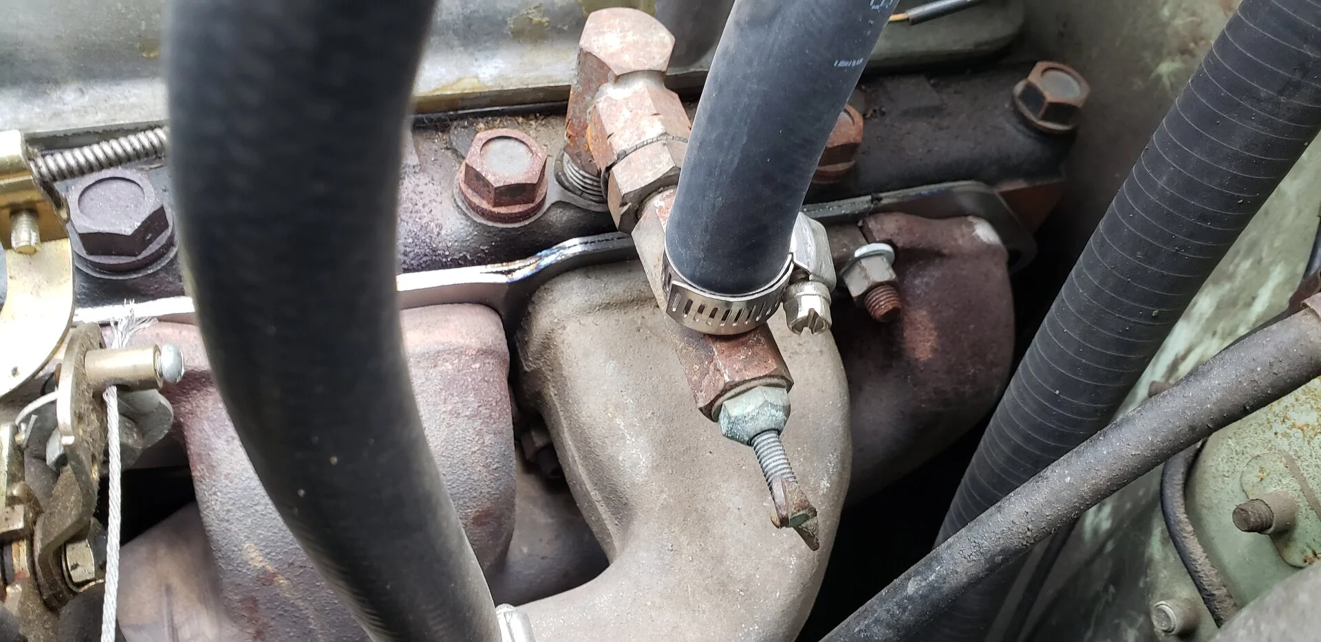

Does this look normal?
Yes. As the manifolds are tightened against the head, the Remflex gasket will bow out around the edges. It's nothing to be concerned about. The sealing surface is between the manifold and the head. The separated edges are just extra material.
