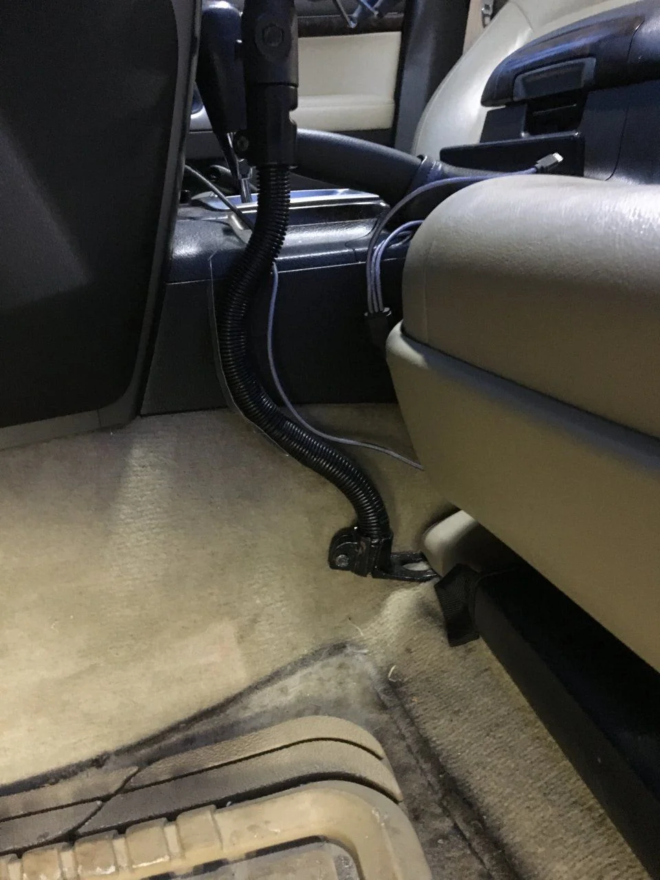

This is how I did my RAM mount. Slightly blocks the Li/hi selector, but it's worth it. It bolts to the seat mount, trimmed the aluminum rod to shorten it to this height.

Milky- Looks great! Can you post a pic of where it mounts to the seat? Thx
The weird looking bend is needed because my wife is short and moves the seat almost all the way forward. This mount is about 6 years old and in its third vehicle. Have used it for everything from a laptop, tablet, and a phone.
