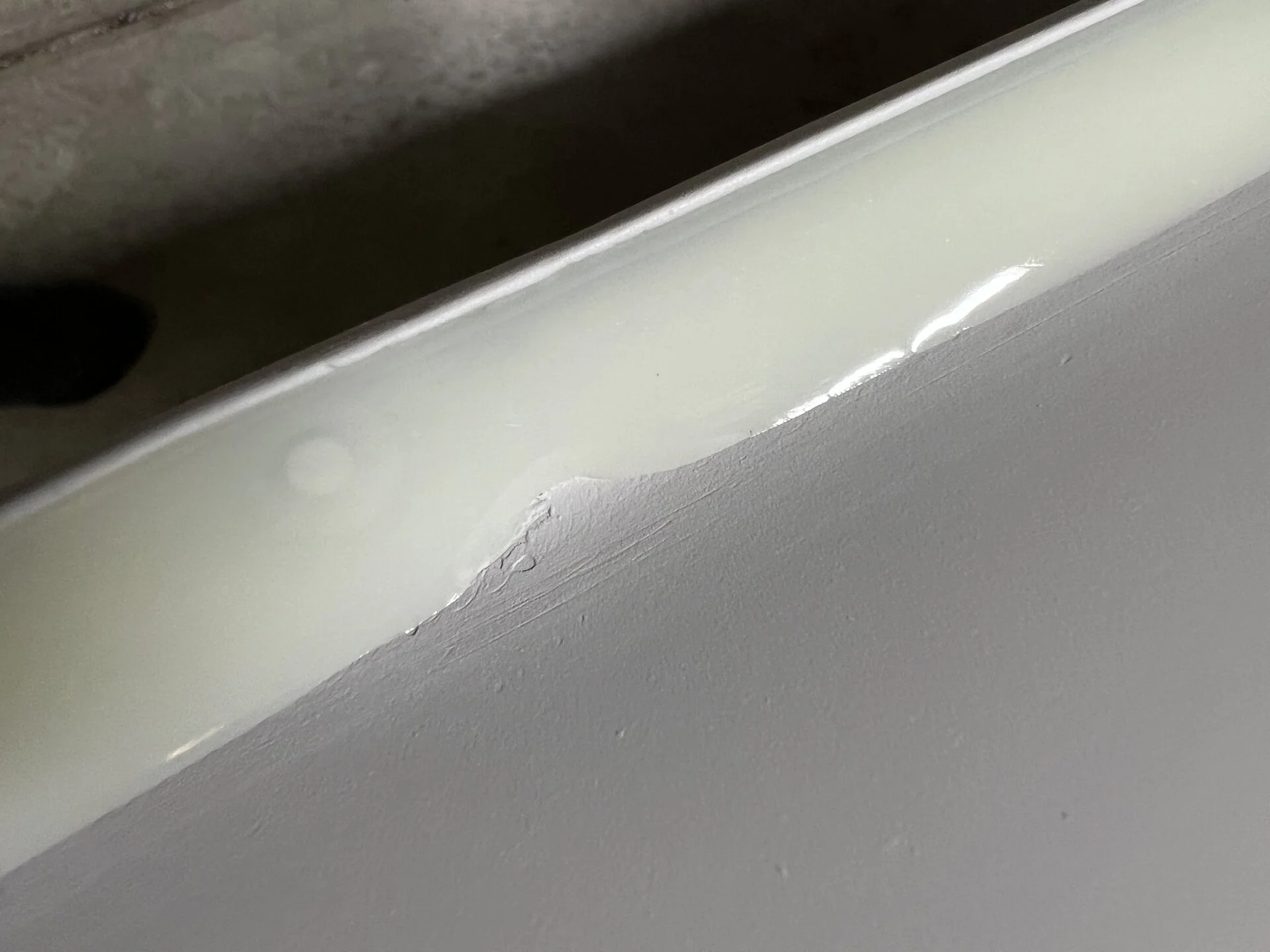

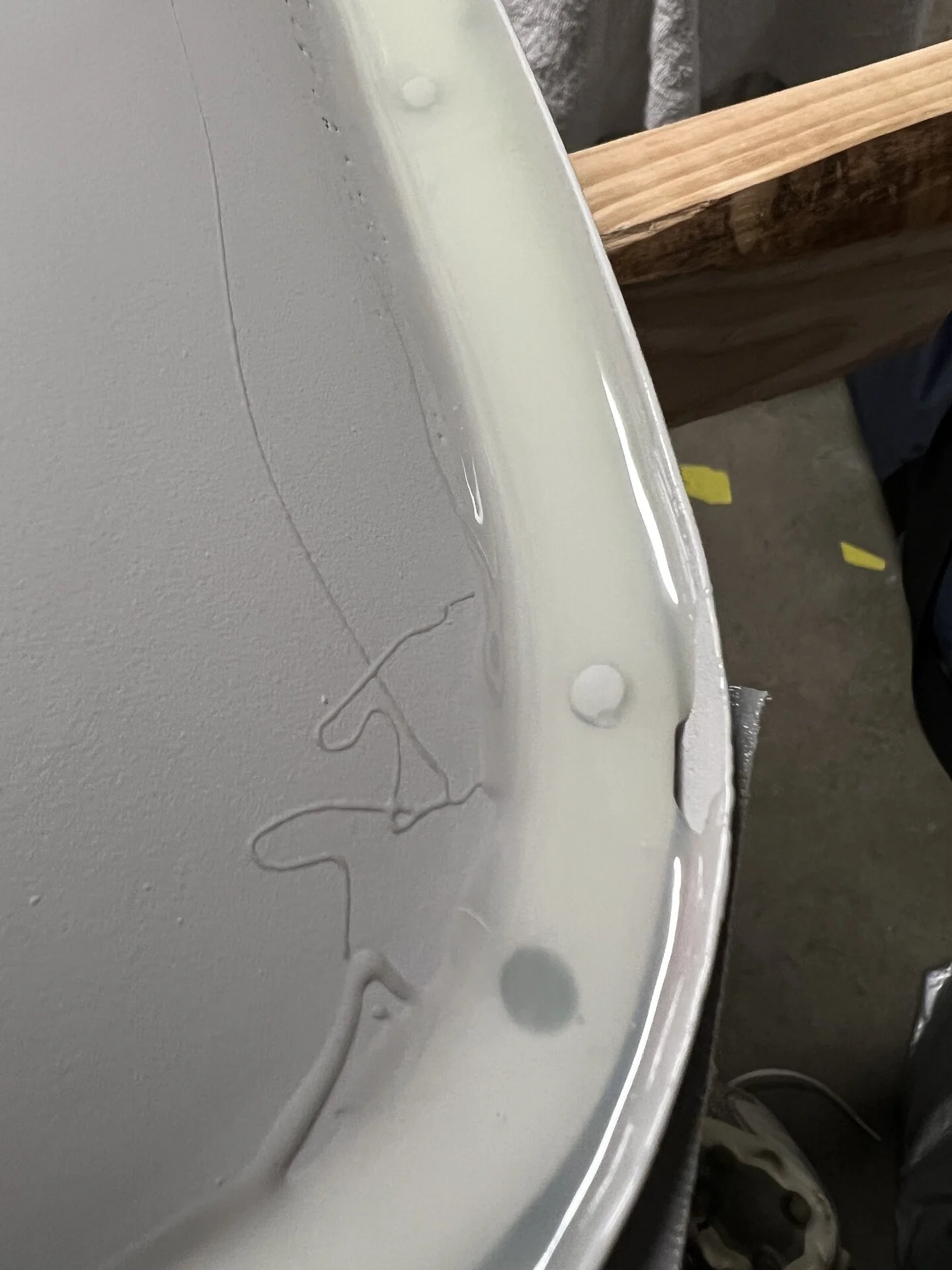

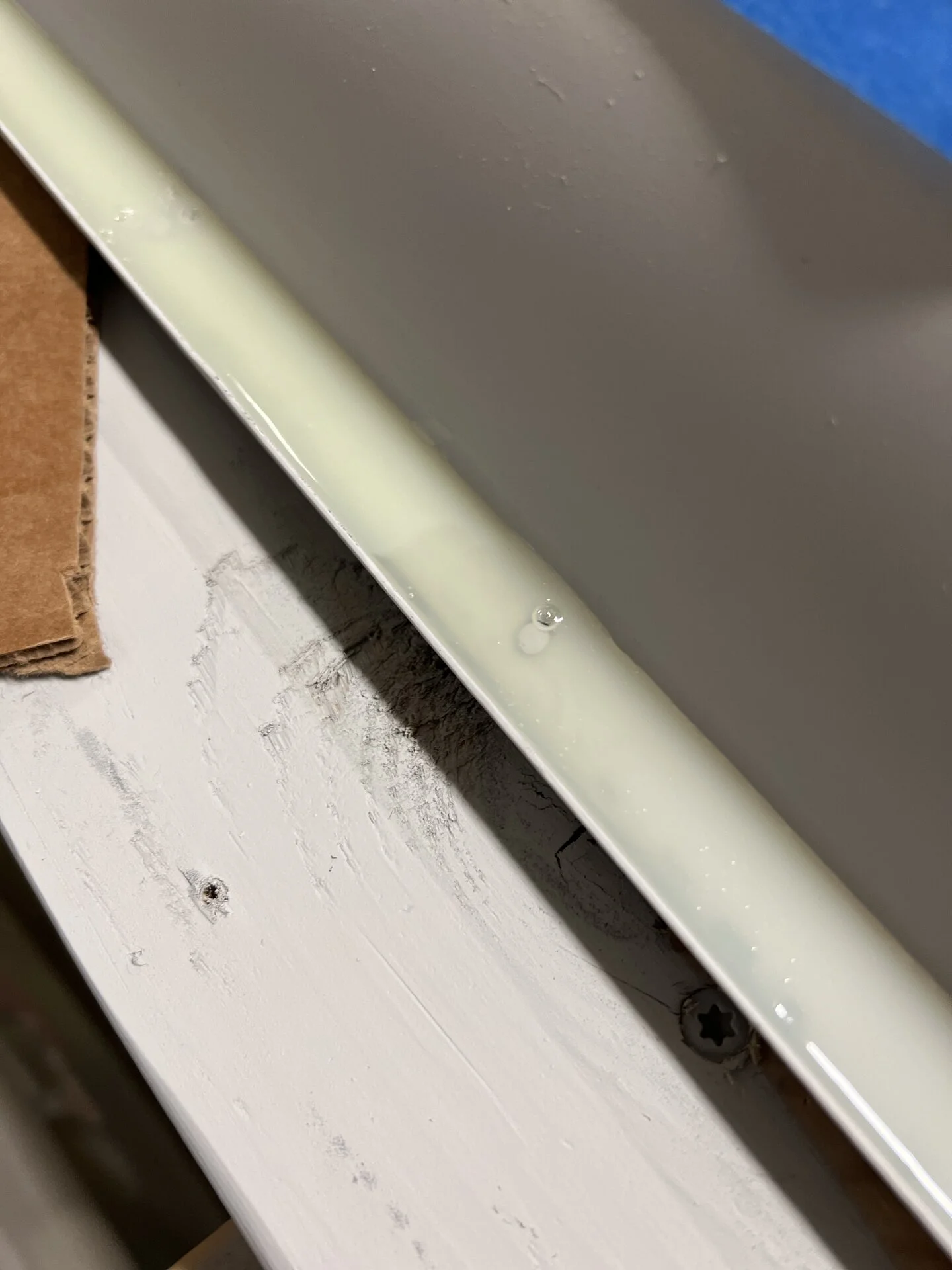

The seam sealer went down easily. I have never used it before, but it has a good consistency. I used almost two full tubes but had to lay it down heavy because my rivets were high in some points. I didn't want any of the rivets exposed, so the sealer is just barely covering them. I can feel a small hump of sealer right above every rivet.

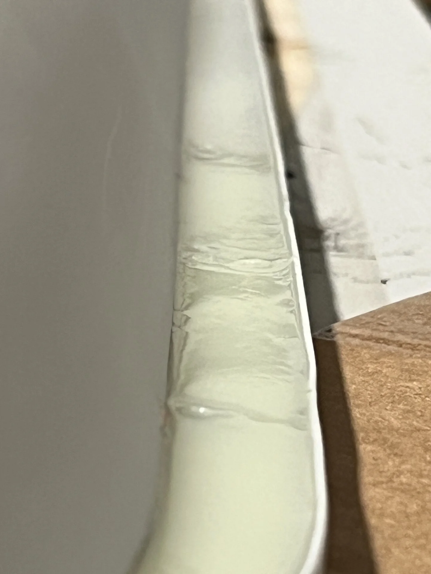

There are some sports where I messed up, or it didn't flow very well. There are also a few air bubbles. Any recommendation on what to fill those and some of the ugly areas with?
I think I will sand it down just a but to improve the gutter depth at points. I just do not want to expose the rivet heads if I can avoid it.
I had to sand one corner where there was a ridge and pop a couple bubbles as well...I just used a little glazing compound after to smooth any bits out or fill the bubbles.
It was fairly slow to sand compared to other bodywork, but it does get there.

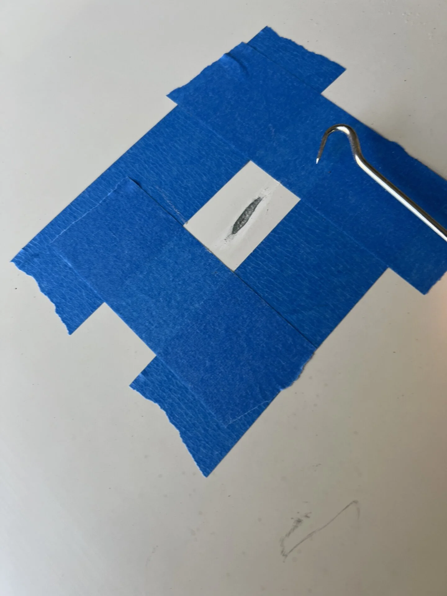

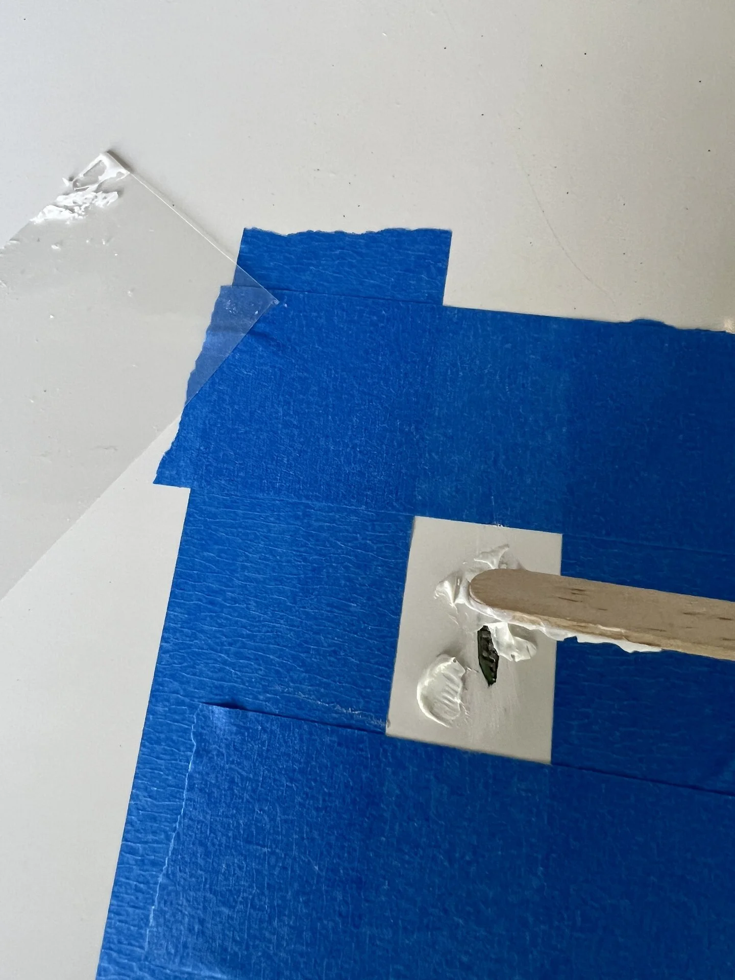

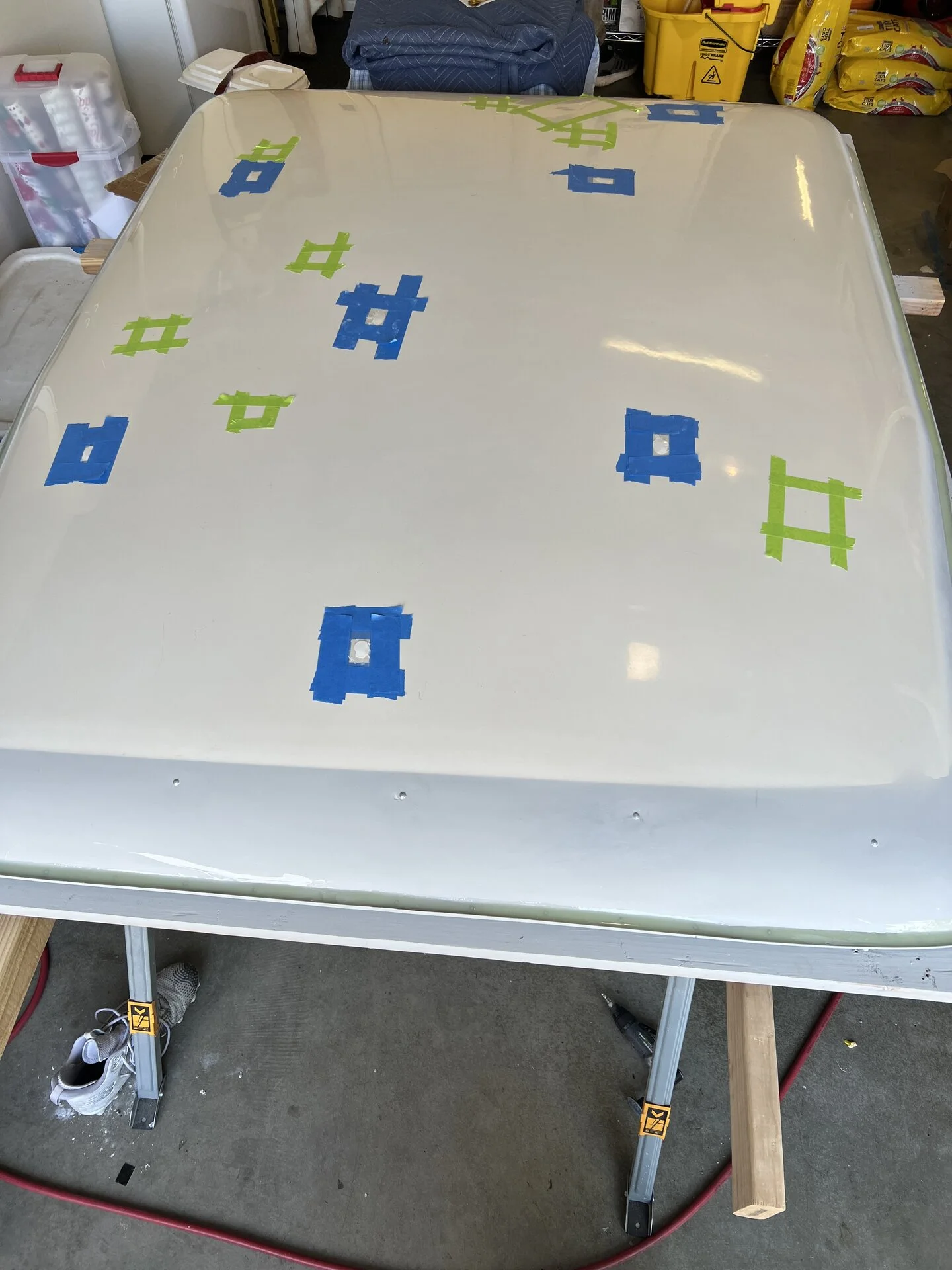

Been doing some work on the gelcoat and purchased a repair kit from Western Marine. I just laid it down and will wet sand tomorrow. There are also some hairline cracks I need to dremel out so I can repair them properly. Sof of the gelcoat was compromised because it had a little bubble under the surface scratch. I picked the bad coat out and then scruffed it a bit so the new stuff would adhere nicely. Blue boxes are big gouges, and green is hairline cracks.
