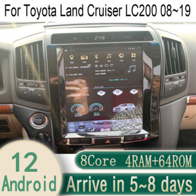

Here's one popular option...there are a few of these "Tesla" style options, probably all from the same Chinese factory. Reviews are mixed, but there seems to be some success.

I'm in the LX570/LC200 FB group and someone posted this yesterday. Looks really nice but the first I've ever seen this unit. They said everything works.
LX570/LC200 North America | Facebook - https://www.facebook.com/share/g/1KAKkxe3pE/
EBAY LINK
I wasn't crazy about the full replacement units that were available so I just dropped the Hamilton CarPlay system. It's a little glitchy, but overall fine - I'd give it a solid 4/5 stars. It will occasionally disconnect for no reason and then reconnect a few seconds later. Happens maybe 1 out of every 10+ starts or so - not enough to really bother me. The other issue is that the hands free isn't great - people tell me they can't hear me very well. But this was an issue before CarPlay, so more likely a combination of an old mic and road noise.
The one AZLX570 posted looks pretty sweet though. I wonder if they make an LC version....
Other than the lack of brightness of my Tesla style full HU replacement, it's been a solid working unit. No hickups or caveats and has been working smooth after the initial install. Install did take some effort so I recommend a vendor that offers support.
There's a surprising variety of form factors available for the early gen LX570s. At least 6 by my count including the unit @AZLX570 posted and mine
