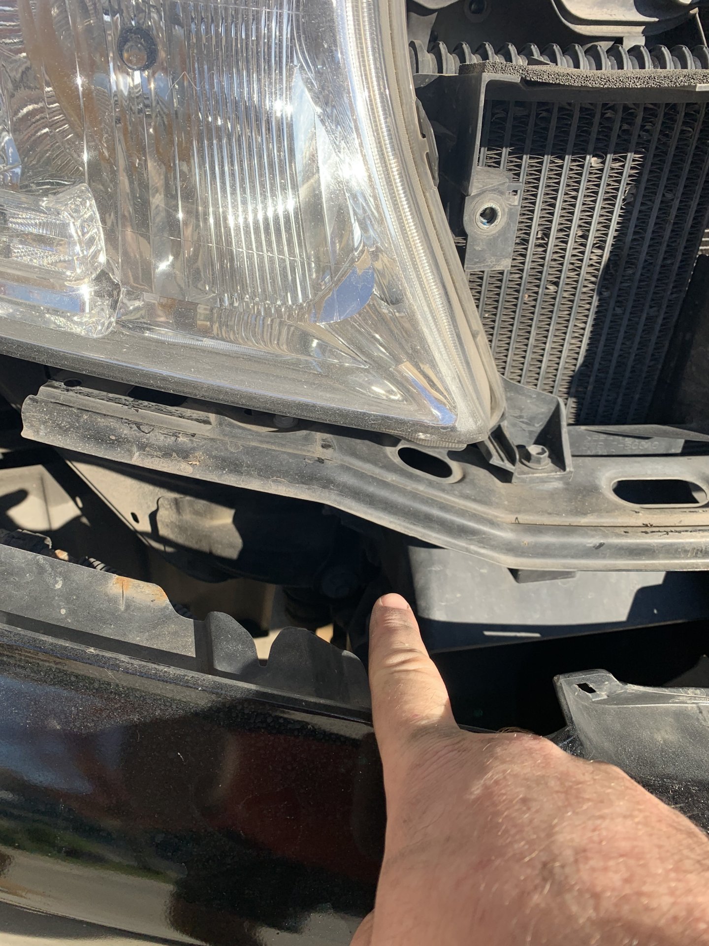

It’s a regular 5.7 gas. Well, the same engineers make you take front bumper, grill and air cooler to access that one bolt which is pure Toyota greed over legacy. Why not just place those 4 bolts on the other side especially for supposedly off-road vehicle:)

Sure you can’t get to the bolt from the bottom? Or side with a short extension? The back side is accessible but it is a square nut.. and you’ll need access to the front to hold back when loosening.

2009, there is literally no way to get there.
You can leave the passenger side mounting bracket alone and just remove the three bolts holding the radiator to the bracket. Then remove the passenger side bracket from the new radiator and slide it in. You gain nothing from going through all involved to remove the bracket especially when its 99.99999% likely completely fine. My $0.02.

You technically do gain new rubber mounting bushings, and the top and bottom bolts into the plastic tanks will be to the factory torque spec which IIRC isn’t published… but in the case of that bolt being obscured I agree those things are not worth the trouble.

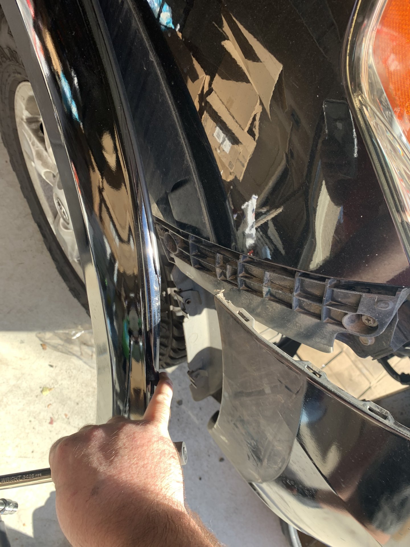

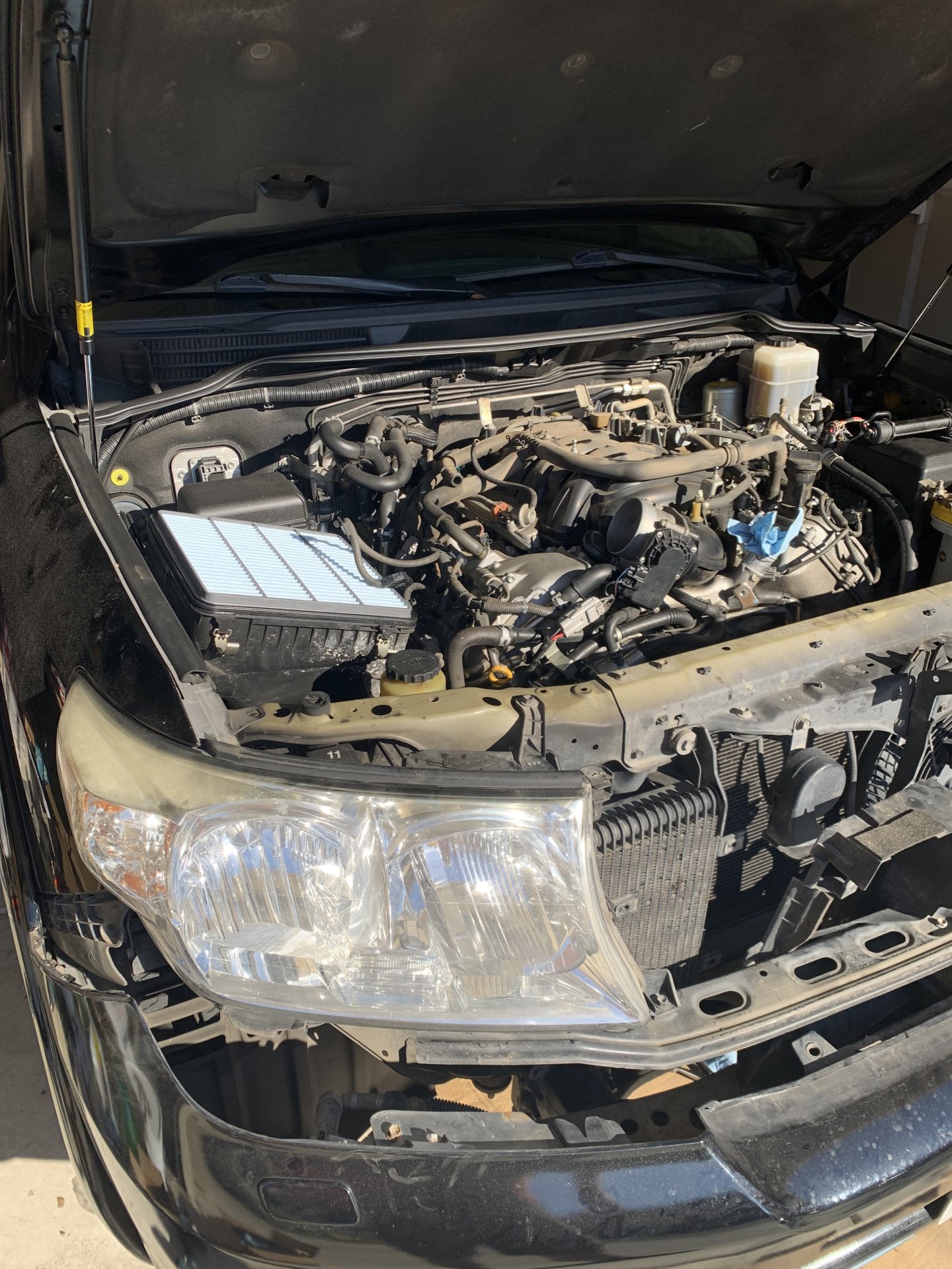

Ok, so I have decided to proceed with front bumper cover removal. Only bumper cover needs to be removed. Few tips, if you have side fenders like myself you don’t need to remove them just remove bolts closer to front bumper and loosen the front bumper. Don’t remove front bumper cover, in my case I had headlight washers and wiring-so I just let the bumper cover hang and still was able to access the bolt to remove air duct. The lower passenger side radiator mount bolt was right behind it. Oil cooler lines clipped, had some at fluid. Now just waiting for the new radiator and those oil cooler inlet/outlet hoses :)
