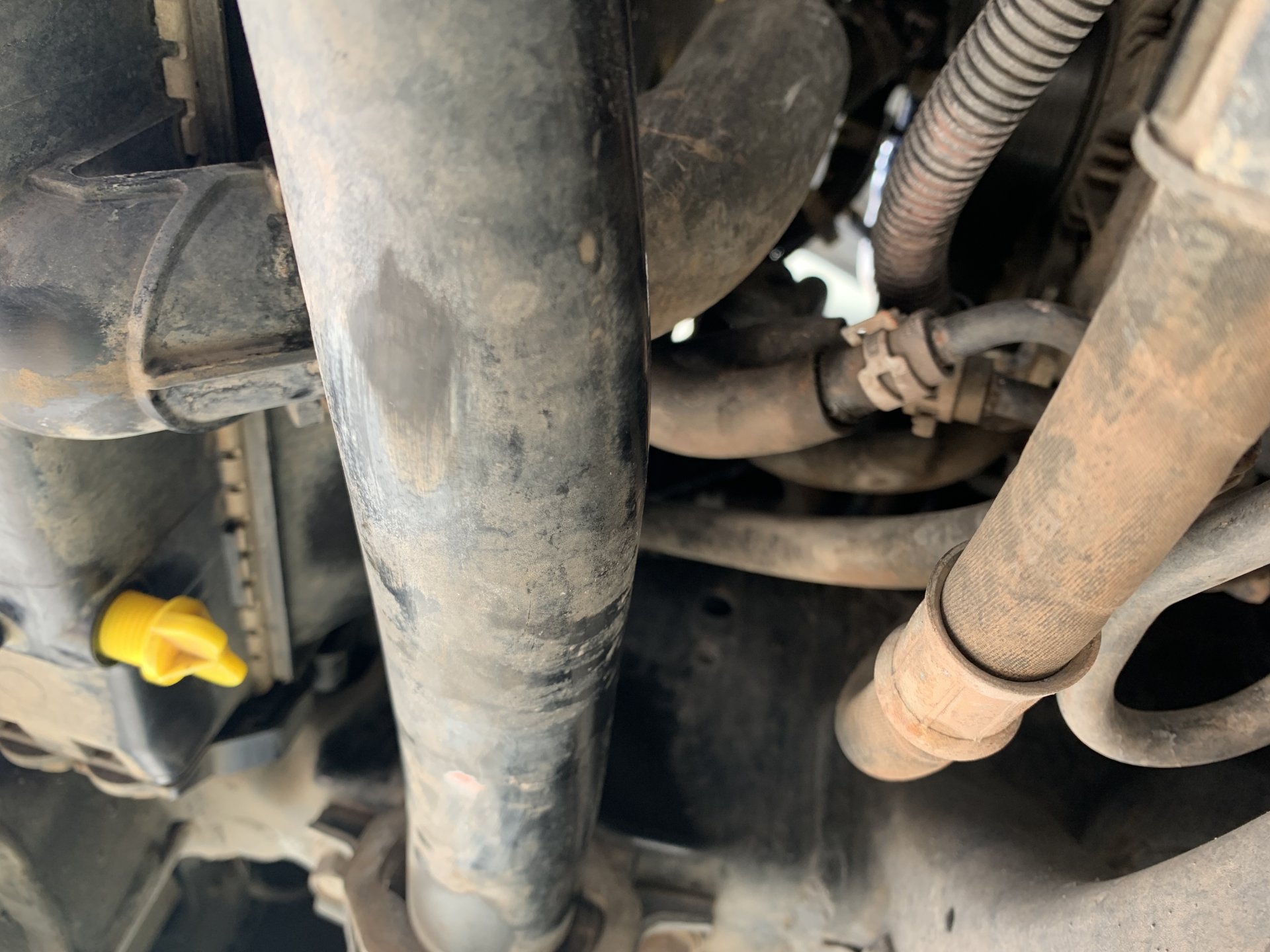

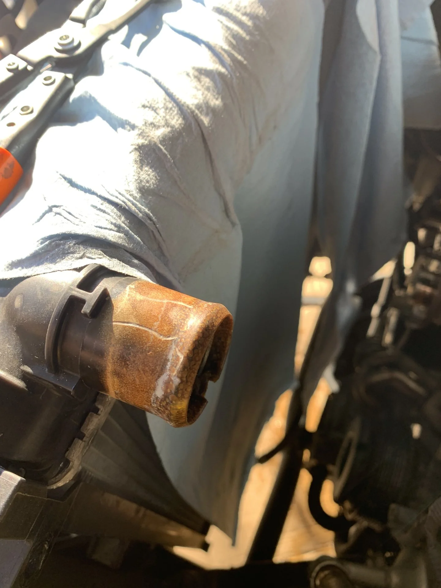

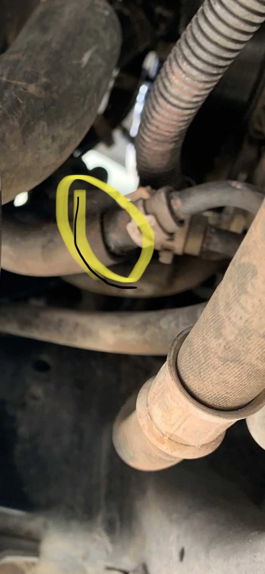

Ok, so as I am in process of replacing my water pump. After removing radiator hoses I see this. I am replacing radiator hoses as part of water pump job but I did see leak in that section before removing the hoses and though it was bad hose issue. What do you guys think? Do I need new radiator or hoses alone should do the job.
Definitely replace that radiator. The plastic is compromised, and only going to get worse in the future.
Thanks! One more question. I have noticed small leak on one of the at air cooler hose no.1 near the radiator drain plug…as I look at the repair manual for radiator and AT oil cooler it does not ask to drain the at fluid or coolant….but it does have fluid leak…the question am I ok to just replace those AT air cooler Inlet and outlet hoses no. 1?
Thanks! One more question. I have noticed small leak on one of the at air cooler hose no.1 near the radiator drain plug…as I look at the repair manual for radiator and AT oil cooler it does not ask to drain the at fluid or coolant….but it does have fluid leak…the question am I ok to just replace those AT air cooler Inlet and outlet hoses no. 1?View attachment 2844143
I don’t see an ATF leak in this picture… that fluid will be red.
This area is wet and when slightly push it seems to have dark/gray residue, fluid…I believe bad radiator can have an affect on at fluid changing from red to dark…am I missing something? If I am to replace those hoses for POM do I need to drain any fluid?
That is mostly likely something else sitting between the outer cover and hose jacket. If you had an actual leak there would be more fluid, not just a drop that doesn’t seem to be growing. Plus without damage to the hose it is extremely rare for a Toyota hose to spring a leak in the middle.. on one of the ends from install/removal is more common and even that is rare.
That said, if it’ll make you feel better just get one.
So, if I am to replace them. Do I need to drain any fluid or just straight replace them?
Just control the fluid pouring out and put the new hose in. Note that you’ll lose a small amount that was in the in-radiator cooler when you replace the rad.. but overall it isn’t a significant amount.

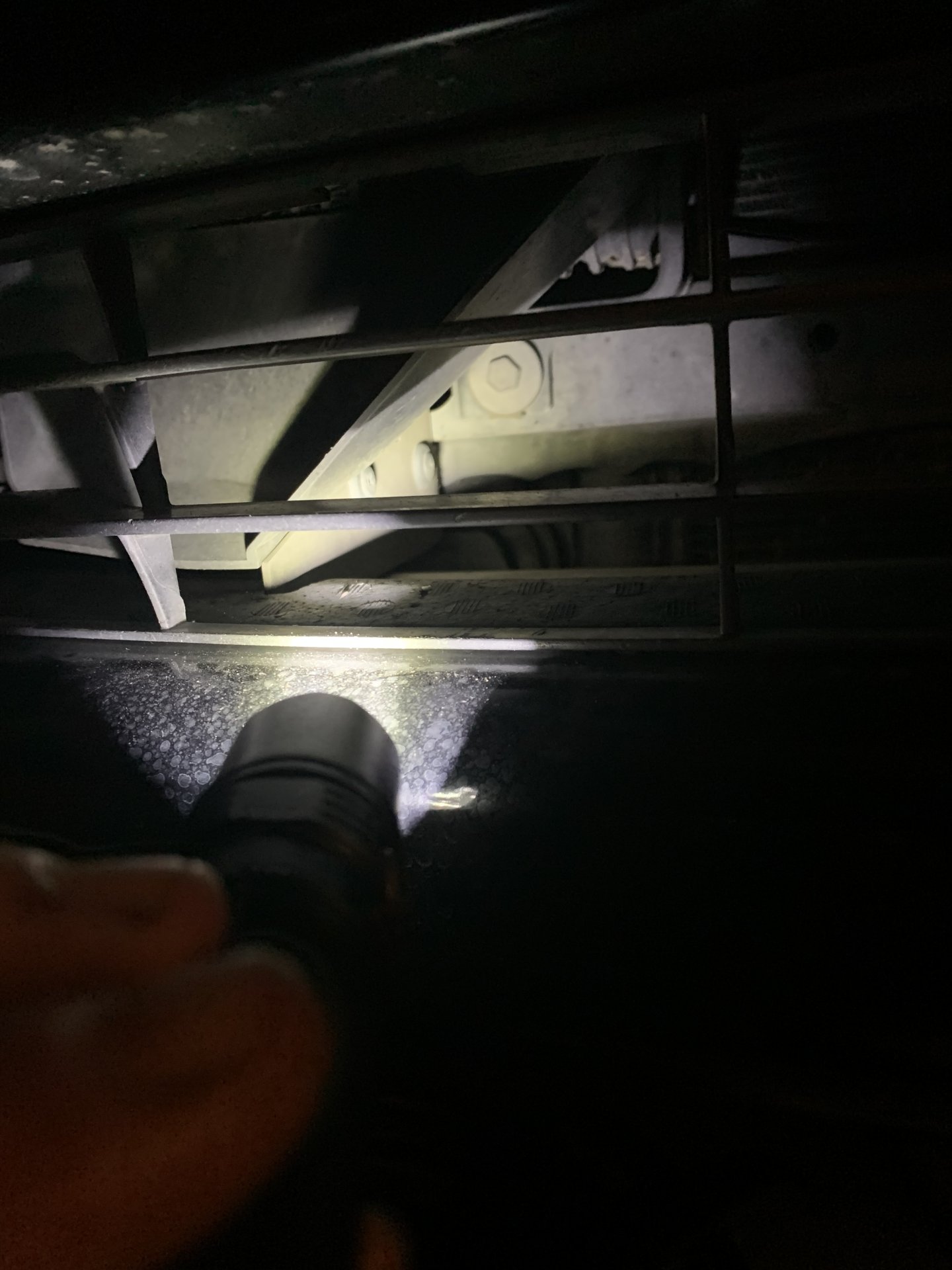

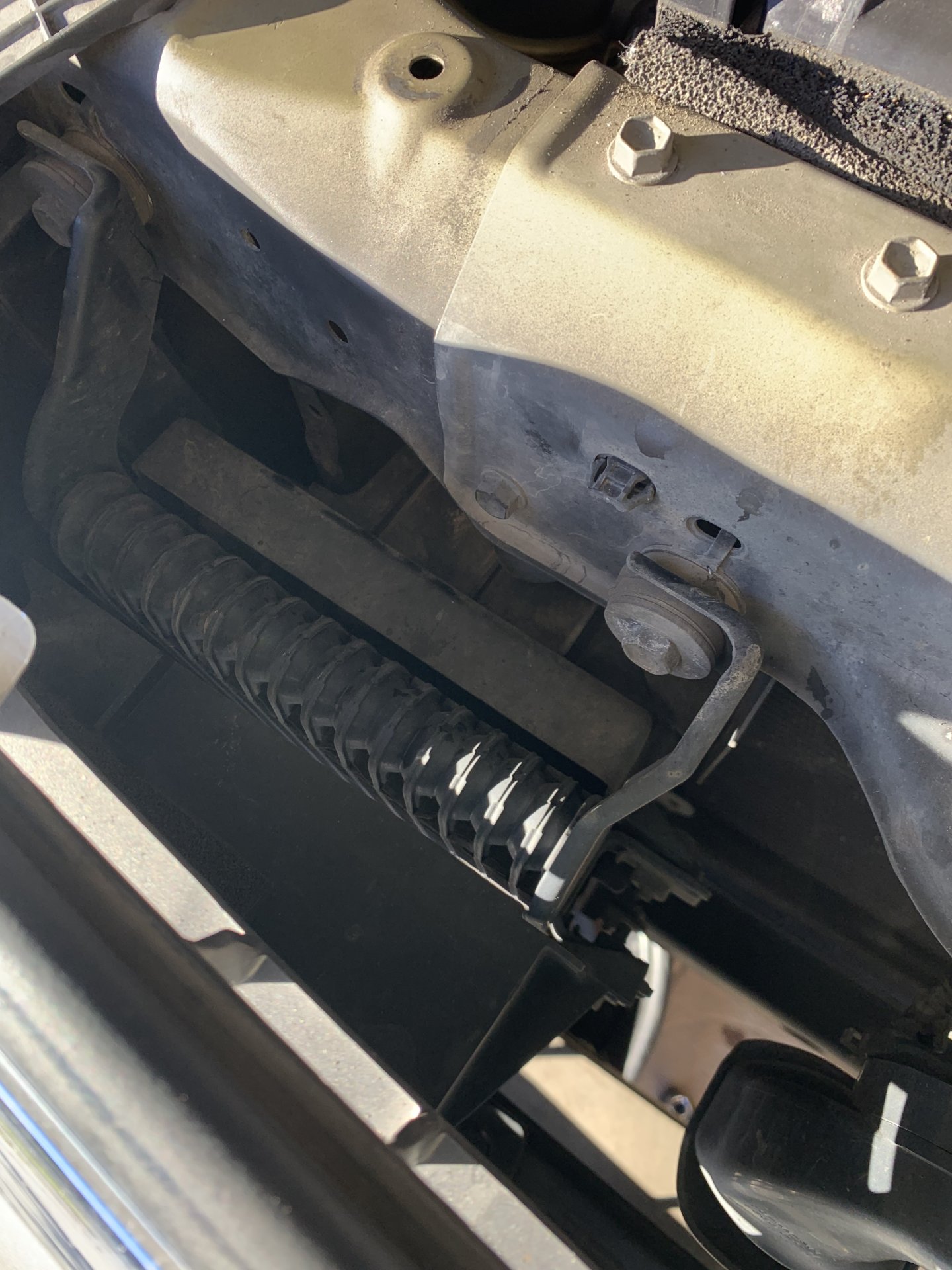

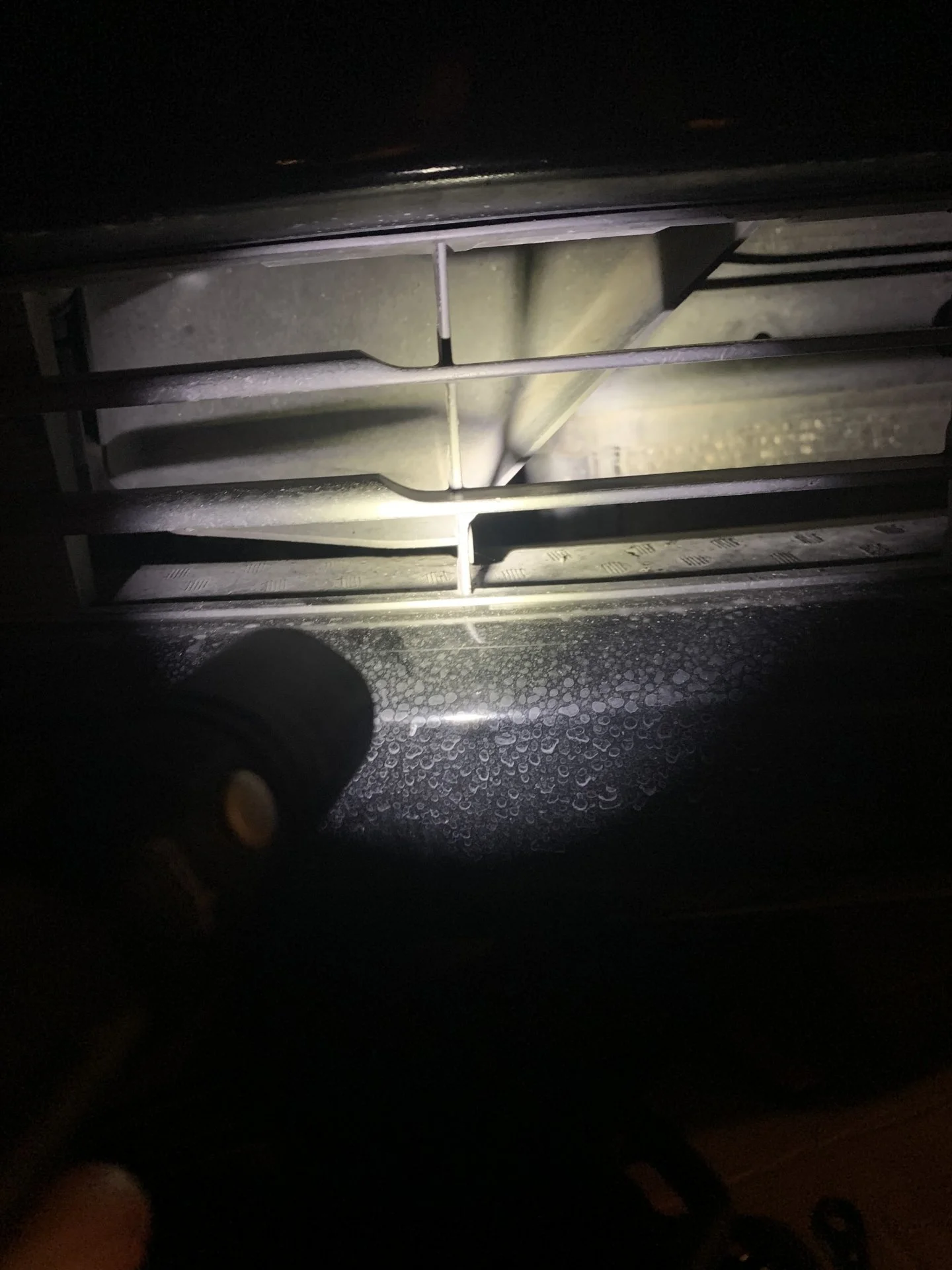

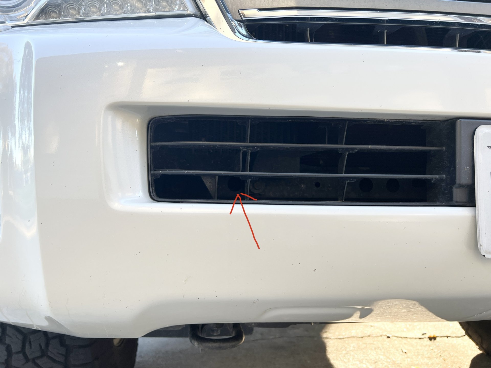

Well, my 2009 LC has •AT air cooler completely blocking lower passenger side radiator bolt, looks I do have to remove grille and possibly front bumper😩any ideas?
I don't think you're looking at the right hole. I've done this job and didn't need to do anything with that cooler. That being said, I did have the grille and bumper off. Others have done the job without removing the bumper.

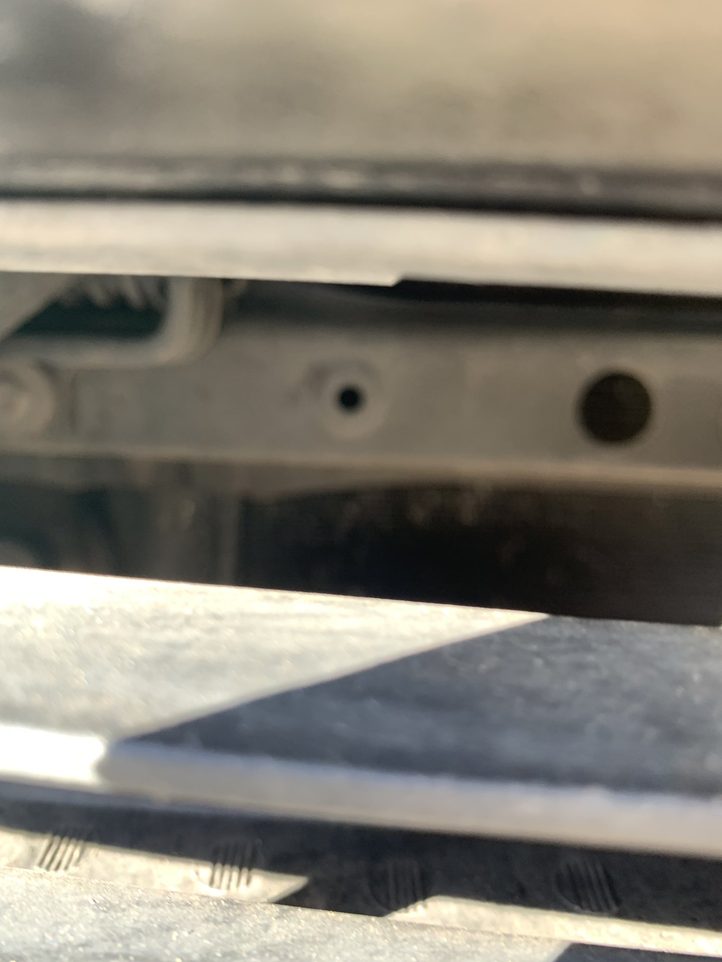

Well that hole is right behind the cooler, the only way to not remove cooler and front bumper id to leave passenger side radiator mounting bracket in place? Any thoughts if that would be ok?
Mine has the lower radiator bracket bolt well below the trans cooler.
It’s a little hard to see in this photo but the arrow is to the exact spot.
