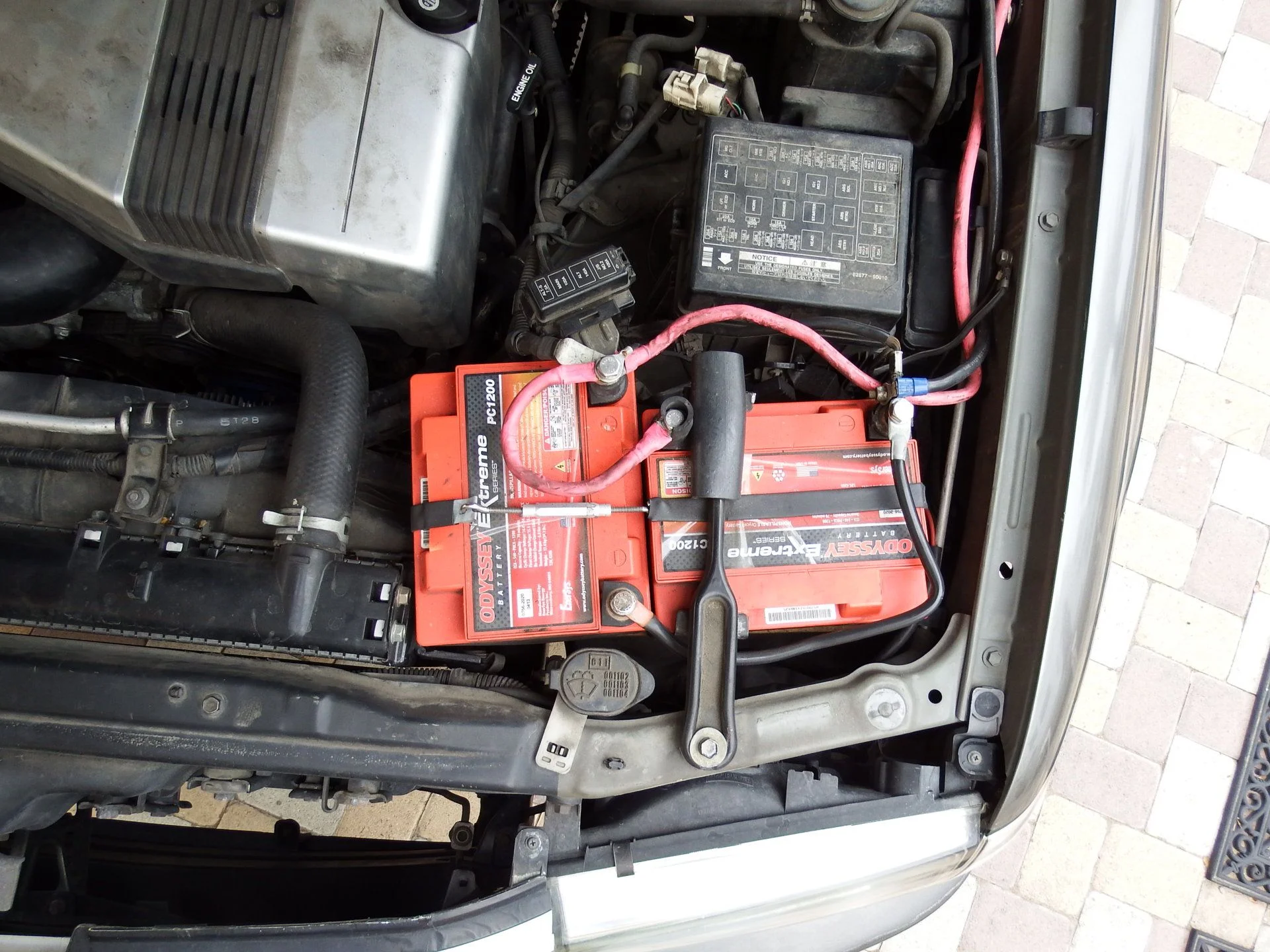

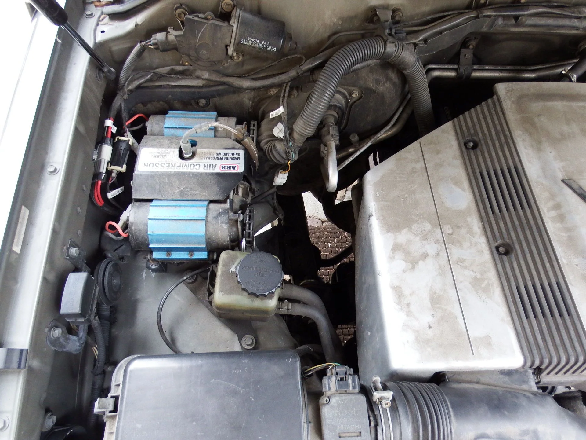

Mike, I have the same compressor and dual batteries and I always wondered where to put the compressor if the battery was in that corner. So I when got two Odyssey PC1200 and stuffed them in the factory corner so I could put my compressor back in the opposite rear corner.
In short, I really like they way you have yours set up!

Just as a suggestion, take a look at how I strapped my batteries in. I used what some people call plumbers tape. It's metal strap that's used to hold down water heaters. I bought some heat shrink tubing and shrunk it around it and used a small turn-buckle to snug it all together. I have the strap going all around, under the tray and battery.
Works great, simple and cheap and I have had that on for several years now with both batteries!
Take a look at the photos I posted of my battery tray and you'll see what I mean.
