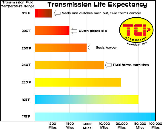

General question about AT temps since I'm looking at them all the time now with the OBDII app.
  • What would be considered the average temperature range:
  • What would be considered high range, under load (hot weather, up a grade or pulling something):
  • What's the danger zone In other words, "pull over and shut down NOW!":
Mine has been running high 190's F to very low 200's F which I believe to be well within average.
Any thoughts?
Any thoughts?
I get high 190s and low 200s as well under normal conditions. I think the thermostatic valve opens at 200?
Up big grades I’ve seen it creep to 220-230. I have the Hayden cooler in hand and ready to install when I get the time.
Also on 35s like you.
220-230F is really too hot for anything but a short duration - see below. 190-200F is also kind of high and will probably reduce your transmission fluid lifespan.
After installing a Hayden 678 I've only got up to 200F a couple of times when towing our camper up very steep grades. During the summer I usually run around 175F, which theoretically provides 100K plus of fluid life.
IMO - if you are always in that 190-205 range, I'd install the bigger cooler AND change your fluid. Both of those are very cheap relative to a $5K plus transmission replacement.
I would never let mine get to these limits but this is how the AT in 460 handles excessive AT heat
IMO: Unless one decides to take coolant loop of AT lines out of the picture one is always going to get around that 190-205 range while on extended drives. You have coolant loop at the thermostatic switch off AT as well as the cooler built into radiator.
I am just trying to improve the reliability odds with drain and fills at 30k mile intervals. It’s a well debated topic with lots of opinions.
