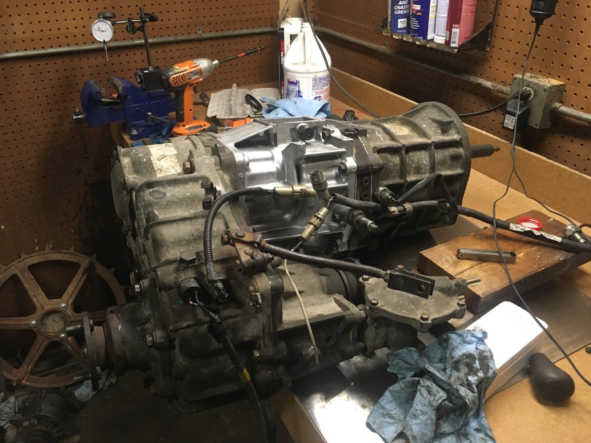

Here is the stock R150f/split case from my 1991 LJ78: be aware that the R transmissions are quite a bit longer than the H series transmissions.

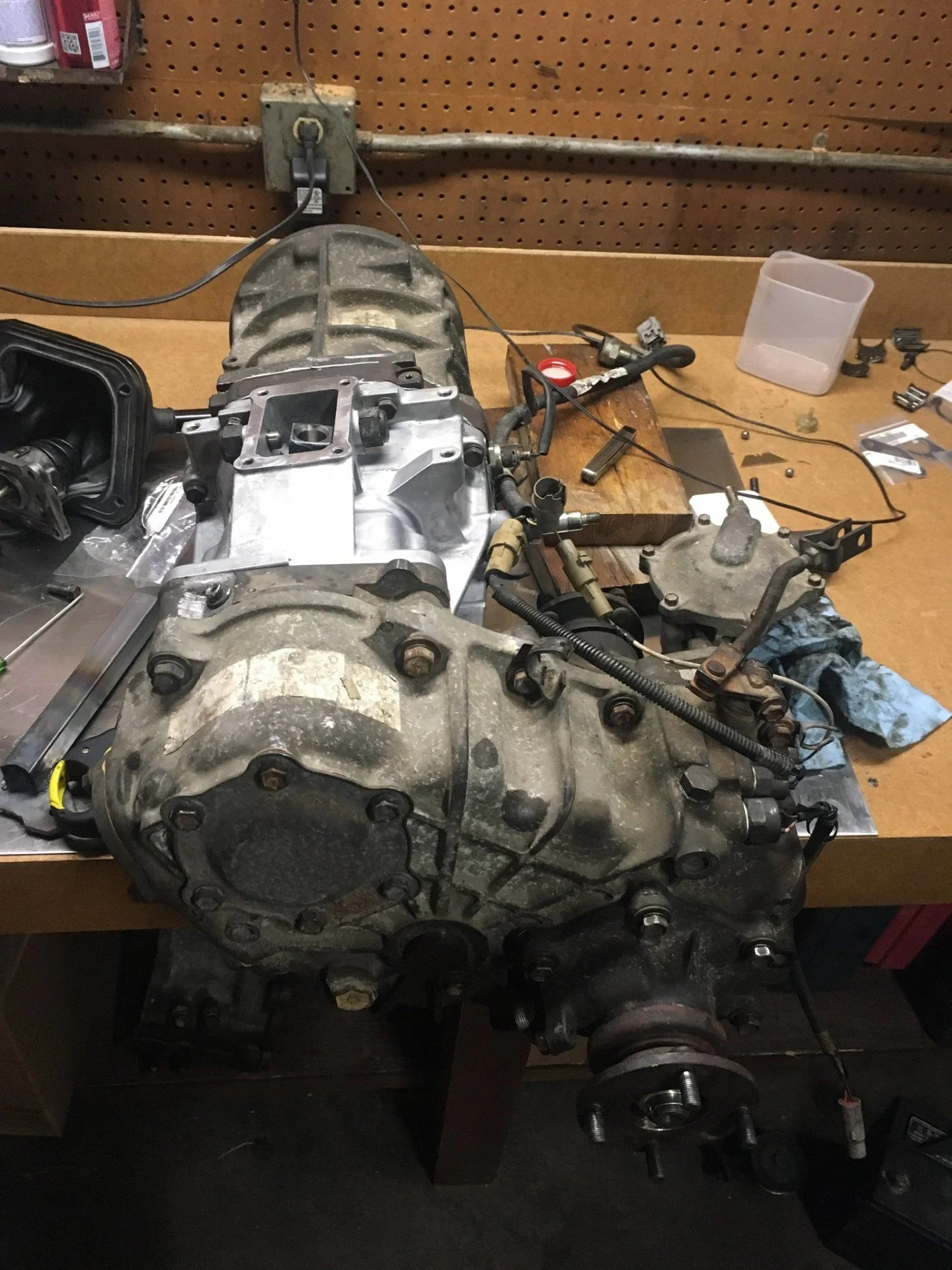

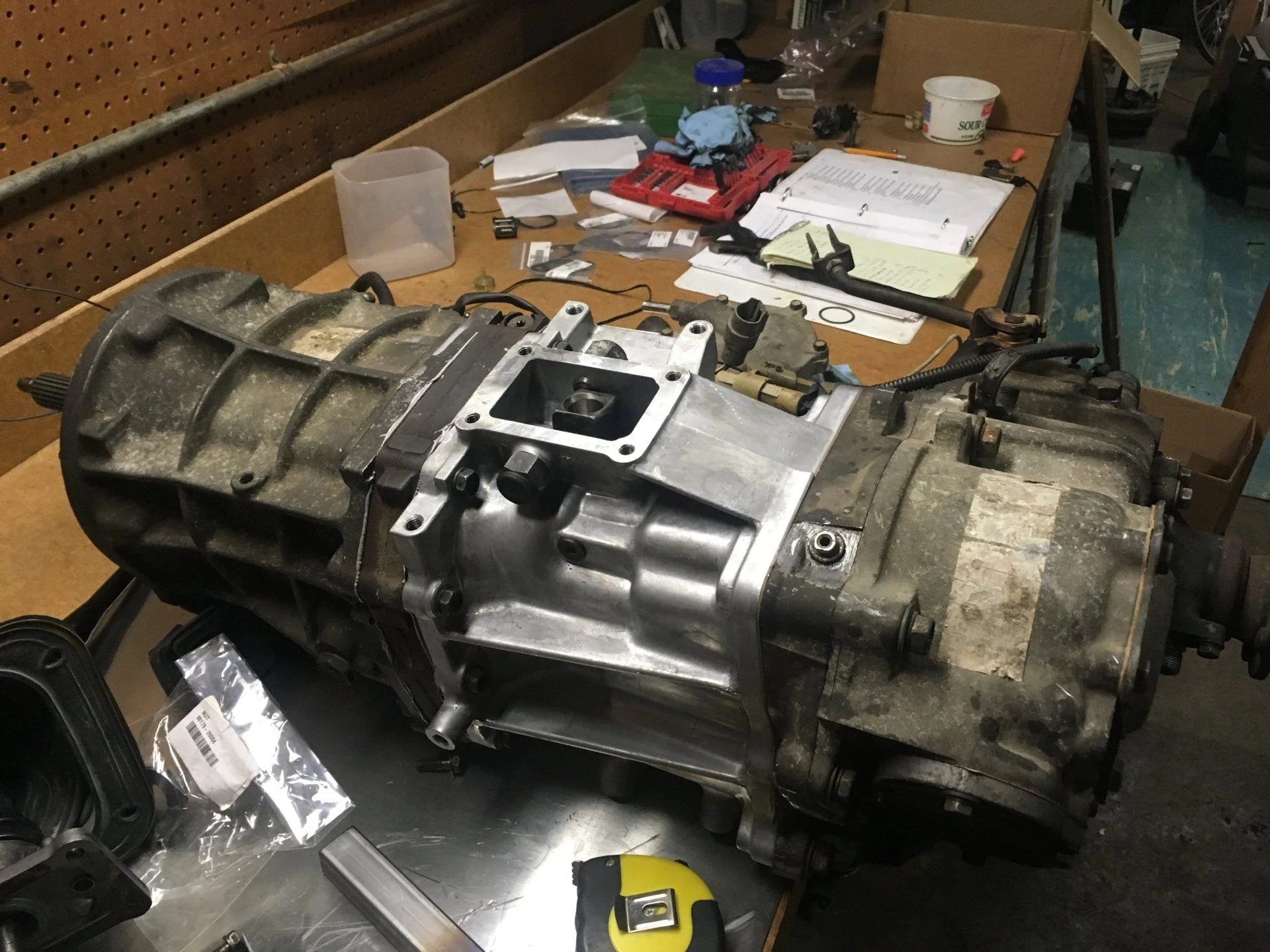

This is after considerable effort and expense to modify it with post-1995 internals, an HZJ79 transfer adapter and 0.69:1 Dyna 5th gear:
Umm, longer than an H55 and it's predesessors (4 speed) perhaps but not longer than an H150/151. With a part time TX case on the H150/151 , the output flanges of the front and rear shafts are in an almost identical position to the R151 with split case.
Could you please go over why a new caseing was necessary ?? I have my old HzJ76 R151 and split case which I want to rebuild before I sell it and I want all the latest bullet proof, go-faster goodies on hand before I go ahead. Mine is a 2007, so perhaps the caseing mod does not apply. Is there now a better stronger intermidiate shaft?
