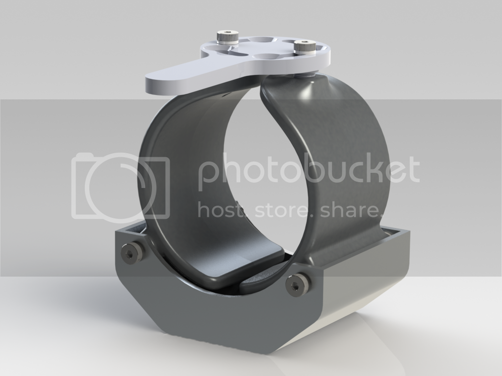

What do you guys think about this one? There are springs on the shoulder bolts that will force the lever off of the clamp halves once it is in the unlocked position, and also a tapered entry on the holes to prevent the lock from catching on the underside of the bolts. I've added two sets of holes which will allow the lever to be installed so that the handle is either parallel with the extinguisher, or perpendicular to it when it's in the locked position, depending on what works best for your situation. It will unlock with only 45 degrees of rotation to keep it quick. I've also added a slight cam action to the lever which will pull the clamps toward each other and pinch the extinguisher even tighter when you lock it.
If we modify the mount to add this feature it will be $10 more, so the total would be ~$65 if this is what everyone wants.
I'm kinda lost- thought the original design was just having it clamp shut; what prompted the extra "latch" on the front side?
clutch
That latch doesn't really add much security in my mind, it wouldn't take much shifting of cargo to knock that lever and have the spring powered bolts launch it off to be lost, opening the clamp. Now you need a pin to keep the latch from turning. Too complex, too much stuff to go wrong.
I'd rather have the original with no lock.
If you're going to put something in that location on the front of the clamp, just use a pull pin. Machine a vertical tunnel on one wing of the clamp and two vertical tunnels on the other, so they line up when it's closed, and drop a pin in from above. Put the pin on a lanyard wire so it won't be lost when you pull it.
^Agreed^
Your solution is clever but I think your completely over thinking its complexity.
One other thing to address would be slight varied sizes of extinguishers. Yooper's idea could have some slop designed into it as could mine. The security pin does not have to necessarily provide a tighter fit. Just prevent the original design from releasing the its cargo.
Yes, the original design is intended to eliminate the need for any other pin or locking mechanism. I personally don't think it is necessary, but it has been expressed here, and on another forum (mostly from guys who race and have to pass track side inspection) that some would like a way to lock it. I was just trying to give people what they want.
