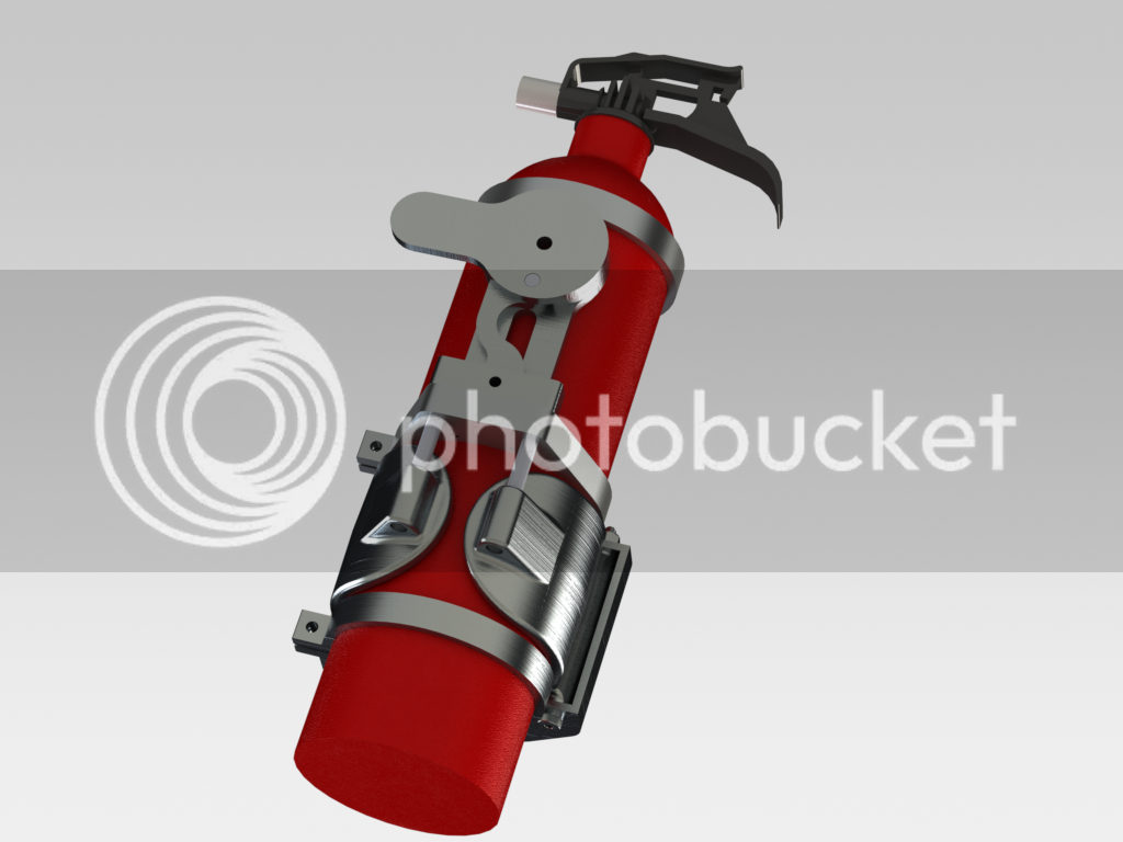

Here's the locking mechanism. It attaches to the extinguisher and allows you to lock and unlock the clamp halves by turning the lever 180 degrees. I have no idea how much it will cost to manufacture, but luckily there's not any welding or bending involved. Just a bunch of flat pieces cut on the waterjet.
I agree with you there yooper. It seemed much simpler in my head but it grew in complexity despite my best attempts to keep it simple. I have a couple more ideas I plan to explore today.
