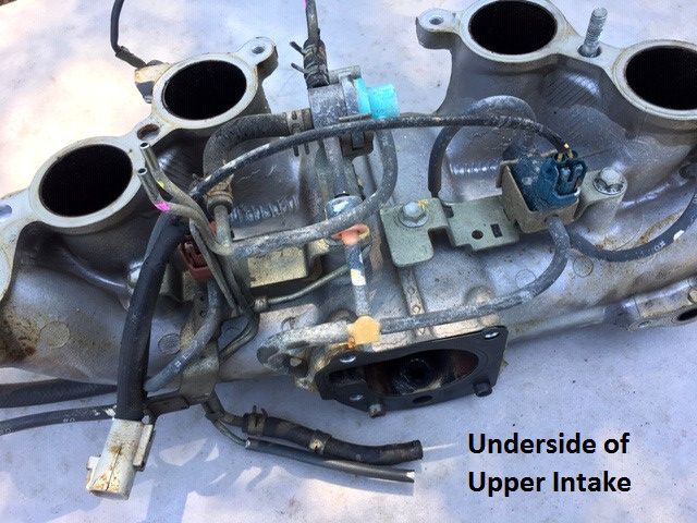

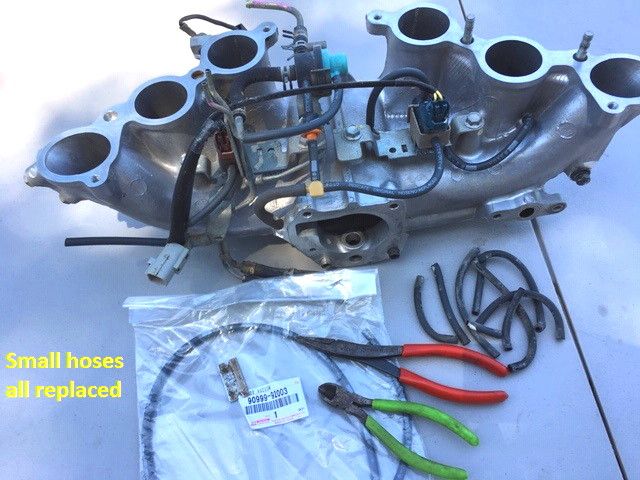

View attachment 2494019View attachment 2494020
This^ plus removing the upper half of the intake allows better access to the coolant hoses mentioned before. I'm 6'1" and have fairly thin forearms and I still don't think I can reach every hose on the engine without removing some stuff. Just the way it is.
If you take the vertical support bar off the driver side of the intake, and remove the blue gas vapor control valve from under intake, you can reach all those vacuum hoses under the intake, on a 96-97 at least.

Great pictures by the way! Side question, the red-ish /orange and dark blue plastic plugs with wires comin out of them, what do they do specifically? Do you know?
Those boogers are the reason a lot of people have P0401 codes. That was what was wrong with mine, green/blue one was toast.

Bulk vacuum line:
The dealer will either have it on the shelf, or can get it next day. Use aftermarket substitutes at your peril.
