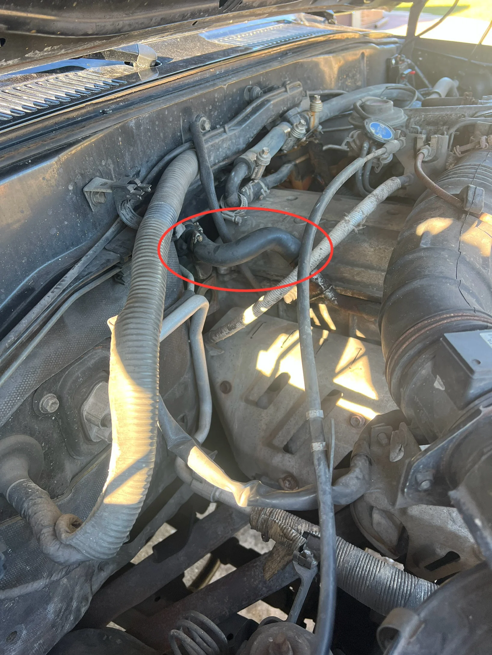

Hey, I’m having a hard time identifying this hose. It’s between the thermostat hard pipe and the tee that goes into the firewall. I noticed that it was swollen and soft when hot and looks like it could burst at any minute while driving. Any help would be greatly appreciated. Maybe a part number?
@3L96LX450 : are you asking about the S shaped hose?

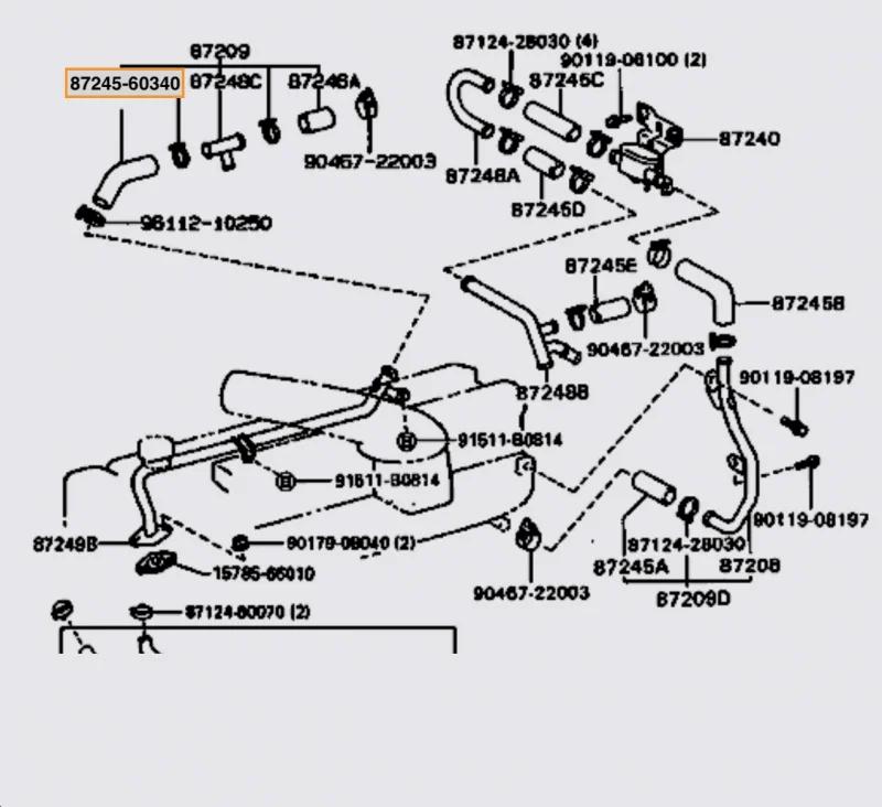

Click on the link above in post #11, there are a sequence of photos showing the part numbers for hoses and clamps in the engine bay.
Quick answer: that S shaped hose is part of an Assembly (87209-60290) consisting of a brass T connection and two hoses attached to it
or looks like it's still available by itself (87245-60340).
